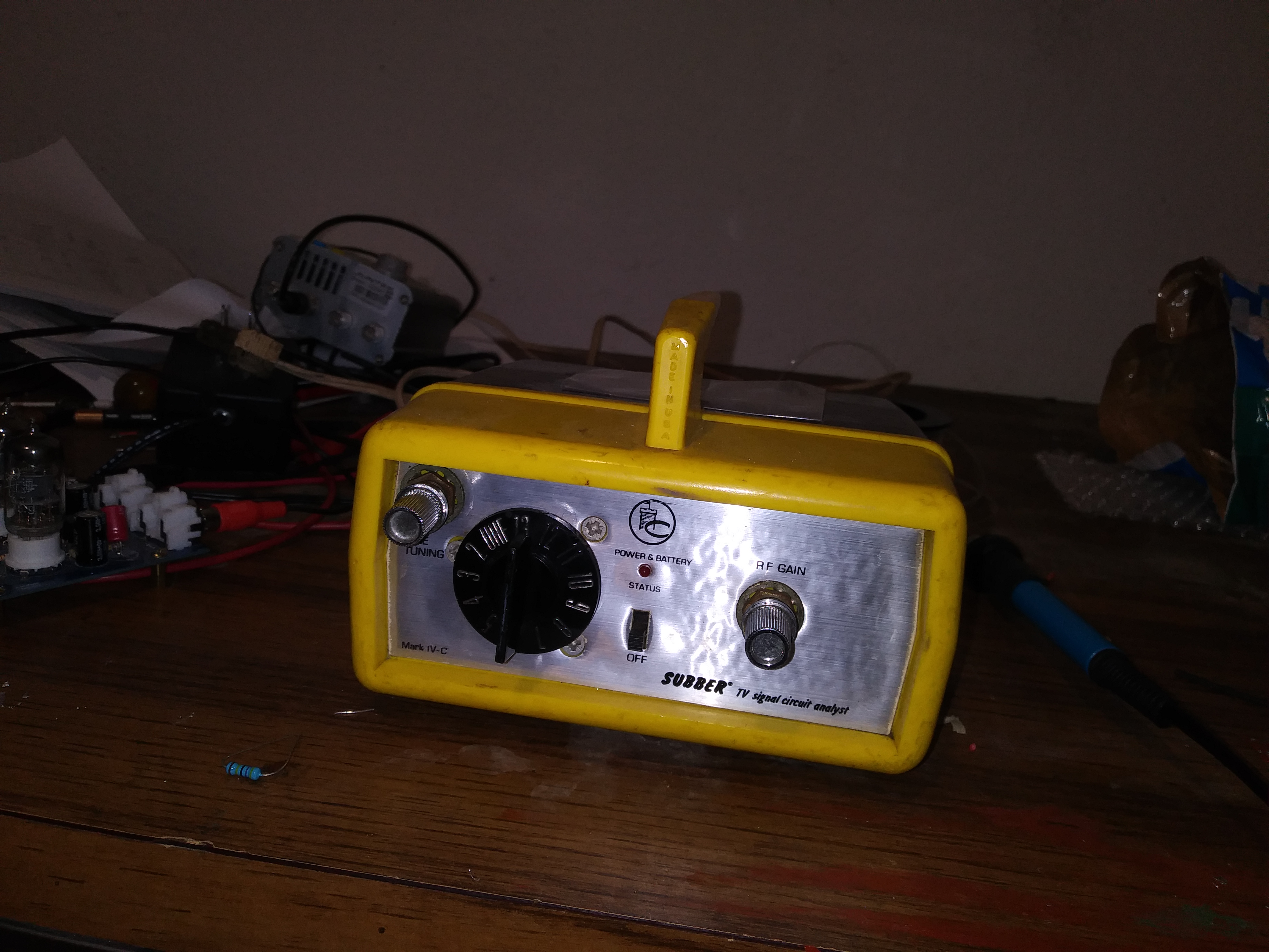

timmy 09-22-2022 12:56 PM
Well I have worked on watches very tedious work so if I have to I would attempt it and the unit on eBay how is that hooked up.
Yamamaya42 09-22-2022 01:08 PM
I have one just like it, except mine has the AC option, that is battery only, (2 9-volts ), it simply acts as a substitute for the tuner you are testing, you unplug the RCA type cable from the tuner in the TV and plug it into the sub tuner, then feed the RF into it, set to whatever channel, adjust tuning and gain, see what happens, it's easy to use.
timmy 09-22-2022 01:11 PM
Yes I seen it I’ll get it and this chassis has an rca type plug from the tuner that plugs directly into the chassis right at the first IF and that subber looks like it has rca on the back.

Ok I had enough of this set I bought that subber hope it works so I’ll know if the tuner is bad or the IF is bad.

timmy 09-22-2022 02:18 PM
That tuner subber don’t have a fine tune is it crystal controlled so that channel 3 is 3 aside from having the gain control. Or I could have a power supply to power the subber and leave that in circuit but I would rather keep it original if I can.

Yamamaya42 09-22-2022 10:24 PM
I have the 4-c version.
http://suzaku.live-evil.org/0922222215.jpg
that other one prob DOES have fine tuning, note the difference in the tuning nob, the wider control behind the one you got may be fine tuning.

timmy 09-27-2022 07:26 AM
Got the tuner subber works good but it looks like the problem is in the IF strip having the subber in and increasing the gain I can see an image but all distorted along with sound so now back to the drawing board focusing on the strip.what causes a ceramic cap to be shiny and greasey looking while there are several other disc caps next to the one that’s shiny yet only that one and not the others next to it.
Yamamaya42 09-27-2022 08:28 AM
plz post pic of the screen image.
