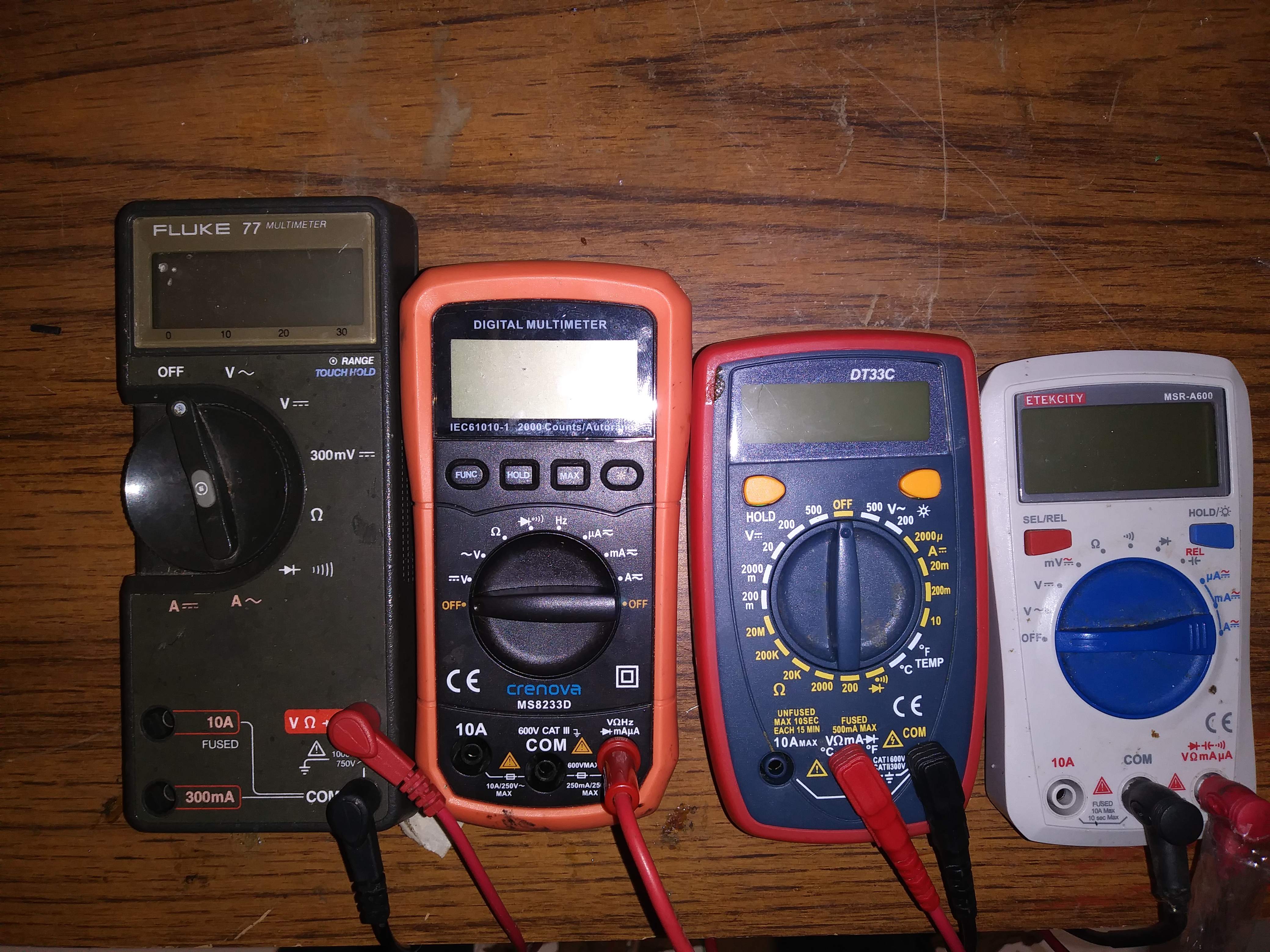

jr_tech 10-04-2022 01:41 PM
Originally Posted by Yamamaya42 (Post 3245298)
It's very doubtful that his meter is 10m, because he has an electrician's (clamp) meter, and not a full function DVM, this has been brought up several times before by quite a few, including myself that he invest in a better one that has a dedicated 10a scale, and was made for the electronics field rather than an electrician, because it is very likely it's giving inaccurate readings in some cases.
He has this.
http://www.instrumart.com/assets/uei...nix-manual.pdf
Again, a better meter is suggested before believing any voltage readings, one that is known to be 10m, as the one on hand may be loading the circuit down.
While not necessarily “better “ from a quality standpoint, this inexpensive dmm would be more suited to the task at hand.
https://www.amazon.com/gp/product/B0...?ie=UTF8&psc=1
10 megohm input impedance (I have measured mine).
10 amp DC range.
No auto range (no confusion).
Inexpensive @ $12.50 (no tears if you break it).
not affiliated,

I have that exact one! :D
plus 2 other "disposable" types of the same price range.:yes:

Yamamaya42 10-04-2022 06:28 PM
Originally Posted by timmy (Post 3245308)
Sounds like you guys won’t be happy until I buy a cheapy dvm or something from the early 60s. This dvm repaired many tvs. And the cap checker is priceless. I used to use a fluke 77 series and this I use now is better then that.
funny you mention the fluke 77 series .
http://suzaku.live-evil.org/1004221812.jpg
what I and many other are saying is that the clamp meter you have is not 10m impedance, and that is quite important when it comes to tube stuff, there is a 90% chance that your voltage measurements are being skewed because of this.
$12.50 is a good investment to double check that you are being told correct voltage info with a meter KNOWN to be 10m, that both I and jr_tech have used, and I can say for a fact it gives readings on par with the Fluke.

Yamamaya42 10-04-2022 07:52 PM
Originally Posted by timmy (Post 3245314)
or the model number and i can look it up in amazon
msr-r500 MSR-A600 i have both
timmy 10-04-2022 07:59 PM
Msr - r500 is the one that is 10m impedance because it don’t say or show that I can find
Yamamaya42 10-04-2022 08:10 PM
jr_tech also has it, and he did the input impedance test on it, and it was 10m.
it a rather complicated thing to do with a voltage source and a 2nd DVM.
most DVMs of this type are, but most clamp meters are 1m.
