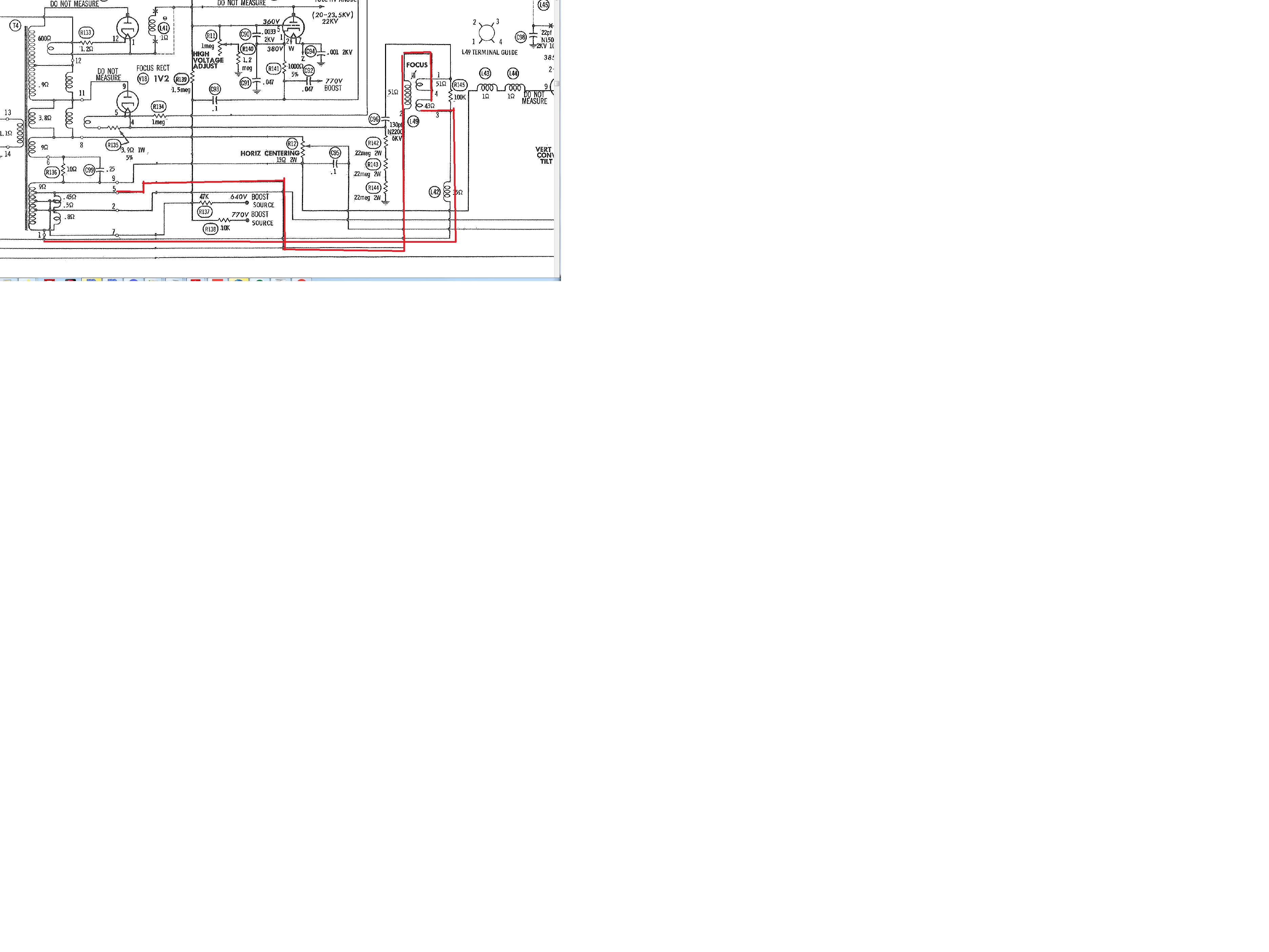

At this point I feel like I’m chasing something that I may not find because with L42 overheating and focus coil overheating I probably think I should put my time into finding out why these are overheating.
timmy 11-04-2022 11:25 AM
The 770v tests 780v the 640v tests 620v the crt anode brightness down 24kv I don’t even know if L42 is supposed to have 780v on it I’m alittle lost not knowing the proper voltages that should be there it’s obvious there is to much voltage there.
Yamamaya42 11-04-2022 11:30 AM
For that you will have to do as SB suggested.
Also for L42 getting hot, you know each coil & Cap are a tuned circuit, If there is something
wrong, it may be peaking at a poor point and creating too much power.
All I can think of right now would be to check focus voltage as best you can.
Since the flyback was removed, it may be a good idea to try and see as best you
can that the pins that go where you think they go have the right resistance on
them as best as you can determine.
Take a picture, several pictures, of the flyback wiring, then disconnect all the wires,
measure the resistance of all the pins as you see them using both schematics, and
try and determine if it's wired correctly. You may also want to check resistance
from one isolated winding to another, This confirms no short between windings
and that they are wired correctly inside the transformer.... Since you have 2
Flyback transformers, you can compare between the two.....
My thinking is that since that flyback has pins that are tied to components and then
back to other parts of the flyback, that if a wire is not connected right, then voltage
may be fed to, or from one section out of phase, and causing problems, possibly
even heat on L42.
Mainly pins 1 & 5.
Others may be involved, but 1&5 hook directly to L42 & the focus coil, and must be unhooked to get a good reading, which SAMS says is .45 ohms, I think.

I’m not sure why 1&5 would be so important because I do have both boost voltage’s so if those 2 taps were shorted in some way the voltages should be way off at last check 640v was 620v and 770v was 780v that don’t seem to bad but it sure doesn’t explain why the focus circuit is hot even though focus voltage is right and variable via focus coil. And the 66meg stick resistor for focus gets alittle warm as well.
Yamamaya42 11-05-2022 10:32 AM
the AC current path of L42 was the reason for looking at the resistance of pins 1-5
http://suzaku.live-evil.org/L42.jpg
not really sure why it's hot if both FBT match, but this may be related to why the 100k ohm resistor burned in the first place.
I had a silvertone that burned the resistor also. Is there a possible reason for the hot L42 from either the horizontal centering circuit or hv regulator like a bad cap. The centering boarders pin 5. Other then that would you use this flyback with the specs it has and the donut 585ohms.
timmy 11-05-2022 11:29 AM
C99 shows.25 but what came out was a .5 this shouldn’t make a difference unless I messed up.
timmy 11-05-2022 11:41 AM
Well it’s official I put the wrong cap in c99 I put a .5 in instead of .25 I don’t know if this may cause the L42 issue along with the video issue
Yamamaya42 11-05-2022 12:11 PM
Which would have caused the pulses to be 2x higher then they should have been at that coil , you may want to test r136 too.

If I only had an idea what it is that tunes the focus coil. All there is focus coil L42 .25 cap 10 ohm resistor that’s it.
timmy 11-05-2022 05:35 PM
The old cap is those dark red ones. I have to concentrate on this focus issue before getting back to the IF because the L42 is going to burn up then I’m screwed.

If you are so worried about the L42 Temp. then just put a 10 Ohm 10W resistor in
series with it, and check it's temp. and move on till you get a pic on the screen
and then you can figure it out.... I mean like a Good Pic from the tuner
with everything else working.....
I also doubt that any cap. that you replaced where the value is .1 and you put
in a .5 by mistake is causing all these problems... I hate the idea of using a
parts cannon on all these tv's before you get it working by only replacing
electrolytics, but that's what you guys end up doing....
This should be your main focus:
Every TV without a signal should produce snow on Picture & Sound
this one does not. You tracked the signal loss to a specific area, & now
need to focus on why it's getting lost. IF Amp not working? IF amp
turned off because of some AGC Fault?

It is entirely possible both problems are related.... But which is the chicken, and which
is the egg..... And is there a 3ed or 4th problem in there too.....
To figure out what is going on with L42 you might just have to look at wave forms
especially that + - 500V P-P as it would be most telling as to the health of that
circuit. Flyback not hot +, Focus voltage within range +, Screen is focused when
signal makes it through from test points +.
You don't know what that coil's temp is when it working perfectly, like when it
came from the factory.....? Did it run hot anyway...?
