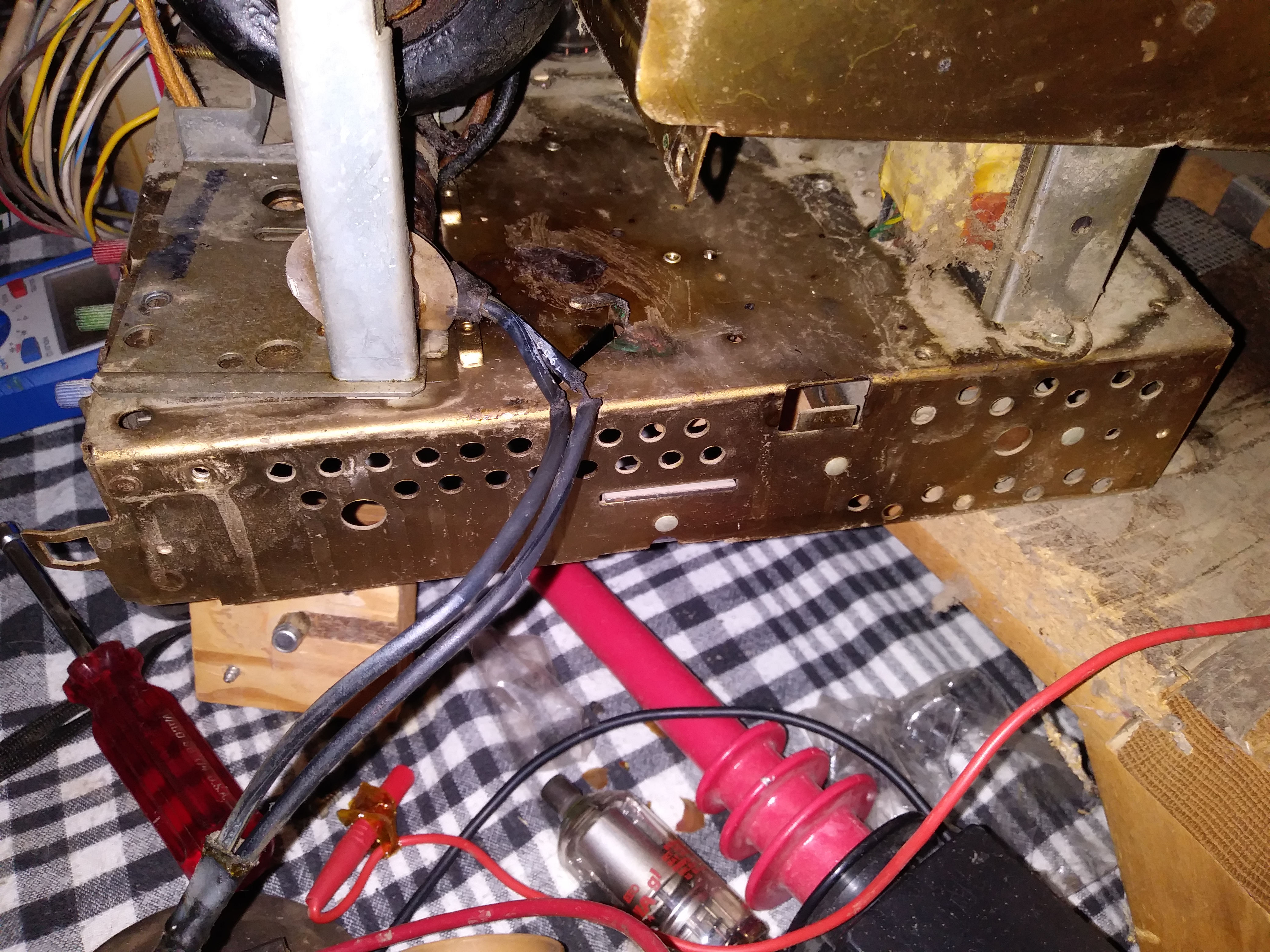

Tom9589 07-17-2022 11:29 AM
When I looked at the two pictures of the chassis out of the cabinet, I noticed that there were two transformer cans with a piece of black tape over the top adjustment hole. Any idea why they were covered? Was it a way of the manufacturer to discourage "diddlers" from adjusting these cores?
old_tv_nut 07-17-2022 12:59 PM
Curious. Can't think of a reason offhand. Possible that someone who worked on it did that?

Yamamaya42 07-17-2022 01:19 PM
no idea why it's like that :o

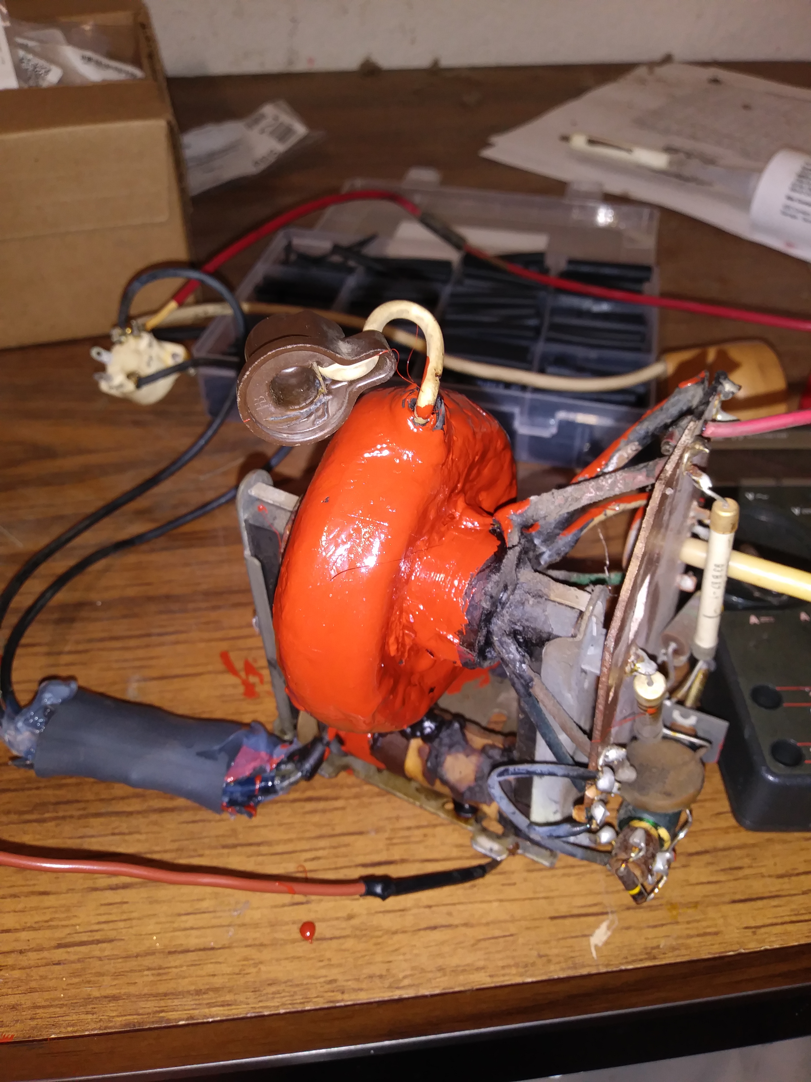

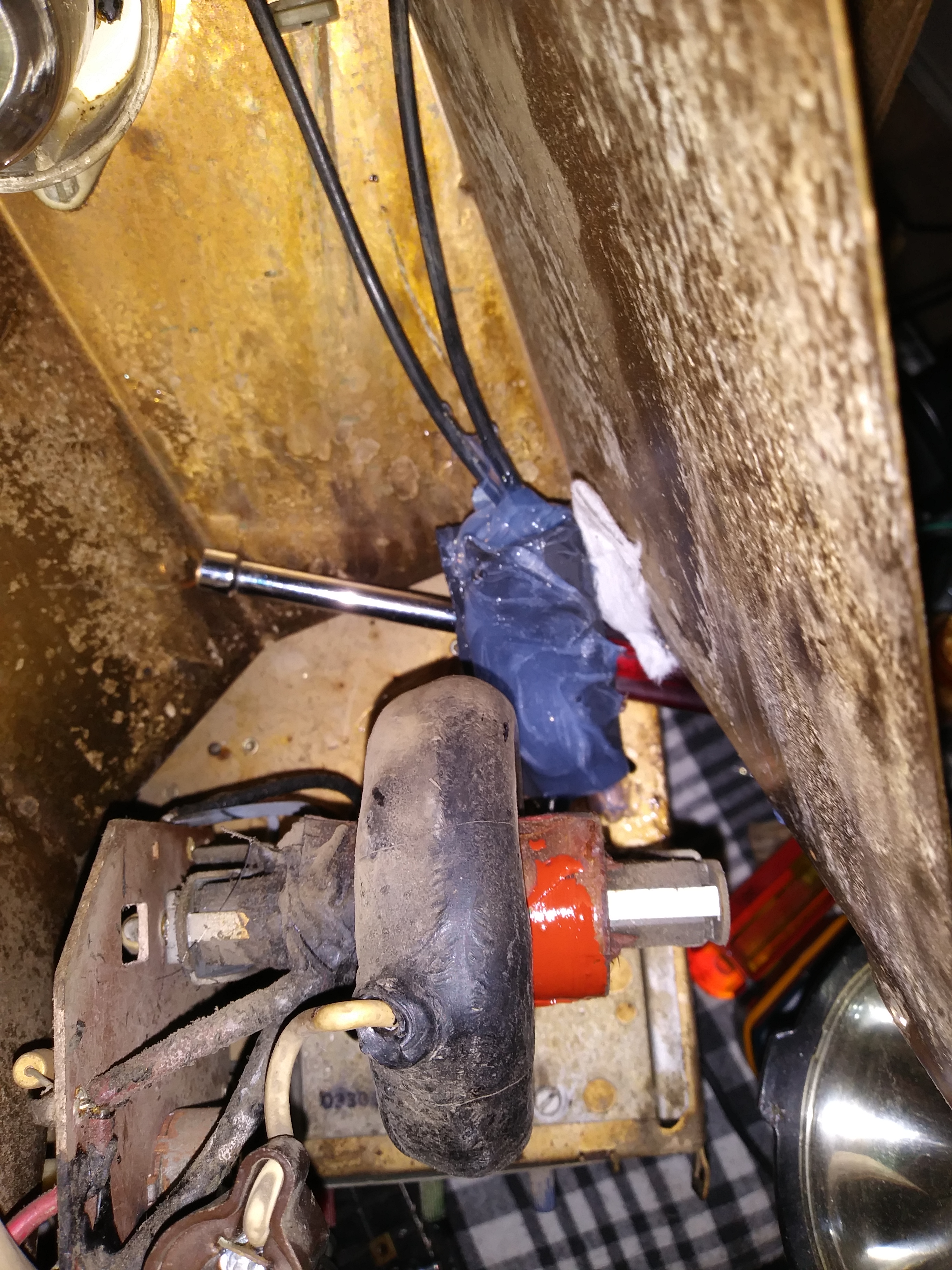

a very dopey looking FBT
http://suzaku.live-evil.org/0717222342.jpg
there were some cracks in the outer " doughnut " that was allowing arcing.
but unlike the ones in the roundies, this one seemed ti be made of tar or something and not rubber.
there was no carbon tracks that I saw, just cracks and so on.
as far as replacing the heater winding, i really don't have the type of wire to do it right now, or really know what to even get to use.
Yamamaya42 07-18-2022 08:22 AM
Thinking conservatively, it would be rather foolhardy now NOT TO replace the burned wire now while I have the FBT out of the chassis with it easy to get access to.
Not really knowing what type of wire to get, I made an educated guess.
Copper Core Flexible Silicone Wire Cable Red 10M 32.8Ft (22AWG 40KV)
40KV, well above what this set should generate, 22AWG, should be thin enough for the clearly 2 turns that I see around the core of the FBT, and hearty enough to power the 3A3A/C
Yamamaya42 07-18-2022 08:50 AM
Re-post of original FBT photo.
http://suzaku.live-evil.org/0716221404.jpg
You can clearly see 2 turns on the heater winding on the core, should not be too hard to replace with the new wire ordered.
You can also see the crack (cracks) in the FBT outer layer which looks to be made out of some kind of hi temp tar, which was easy to melt with an soldering iron, there was a tendency for corona arcing from these cracks but saw no real carbon, and thought it very risky to try to remove it, so I covered it with several layers of dope.
