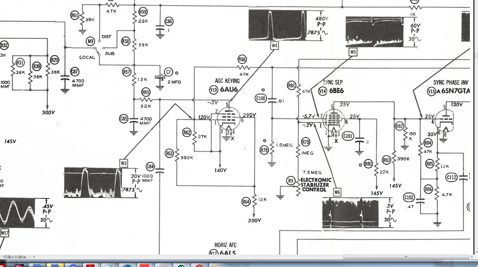

Yamamaya42 09-07-2022 08:30 AM
https://www.rfcafe.com/references/po...rch-1967-4.jpg
best i can find on short notice

AGC & NOISE GATE adjustments may be giving you trouble, to start with, be sure they are set at their center of adjustment.
For both of them, the more CW the pot is set, the more sensitive the tuning, the more CCW, the less it is.

This then, is still likely a horizontal oscillation / sweep issue, as was pointed out way back, it is a giant feedback loop, if everything is not just right, the loop will collapse in on itself, oscillation stops, and the 6JM6s start to destroy themselves.
Where disc caps have been known to fail, it is very rare for them to do so, when they do short, they are hard to find, you often have to hunt for them by looking for a overloaded feeder resistor.

There are only 3 tubes that seem to be connected direcly to power, audio output, sound det ( removed) and V6, SYNC SEP AGC/ NOISE CAN, if V6 is faulty, shorting when getting hot, this could be a problem and would not show in a tester, I have seen a AGC tube short before in a set and load power (it was a 6au6)
timmy 09-07-2022 03:17 PM
Well I have v6 coming it’s a 6hs8 in the mail and yes there is a lot of power arrows and that would mess up video and probably take down horizontal with all that power there. I have to wonder what killed the sound all the other times the voltage pulled down I still had sound.maybe for giggles I should put that tube on the tester to get hot and see if anything shows up maybe even put the heater up a notch. I tried it on the tester 7-8 v showing grid emission.

The TV has the cathode at 190v
https://frank.pocnet.net/sheets/049/6/6HS8.pdf
Max is 200v
the tester won't go that high for sure.
and you can be sure that in the set that it DOES go over 200v before everything heats up anyway.
so IF the tube is shorting, there is a good chance that it is mixing AC heater voltage with the 190v bias.
and IF it's failing then AGC is not working the way it should be, making the tuner deaf.

wait for the tube, right now this all is just best guesses bases on looking at the schematic.
this is the same type circuit in my arvin.
http://suzaku.live-evil.org/arvin111.jpg
it DID a hard short.
when you lose AGC, all sorts of strange tuning stuff can happen.
