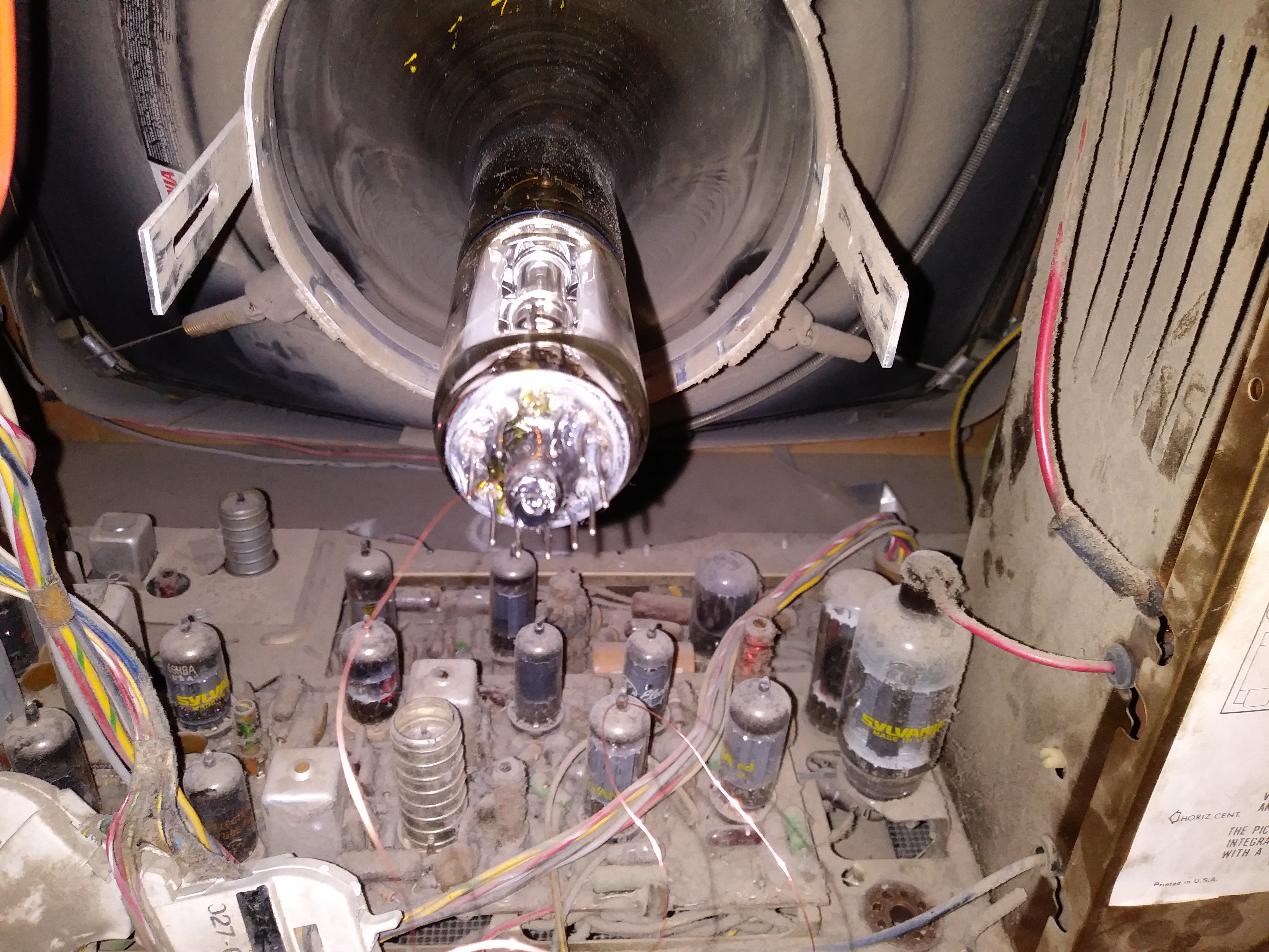

UPDATE!
I got it!!
VERY bad news , CRT is damaged!
pin 12 has been broken off of the base, this is prob why they dumped the set.
http://suzaku.live-evil.org/0716221359a.jpg
http://suzaku.live-evil.org/0716221403.jpg
good news is, I may have been able to fix it by tacking a wire to it.
http://suzaku.live-evil.org/0716221404.jpg
flyback looks OK
now I gotta start bringing back to life

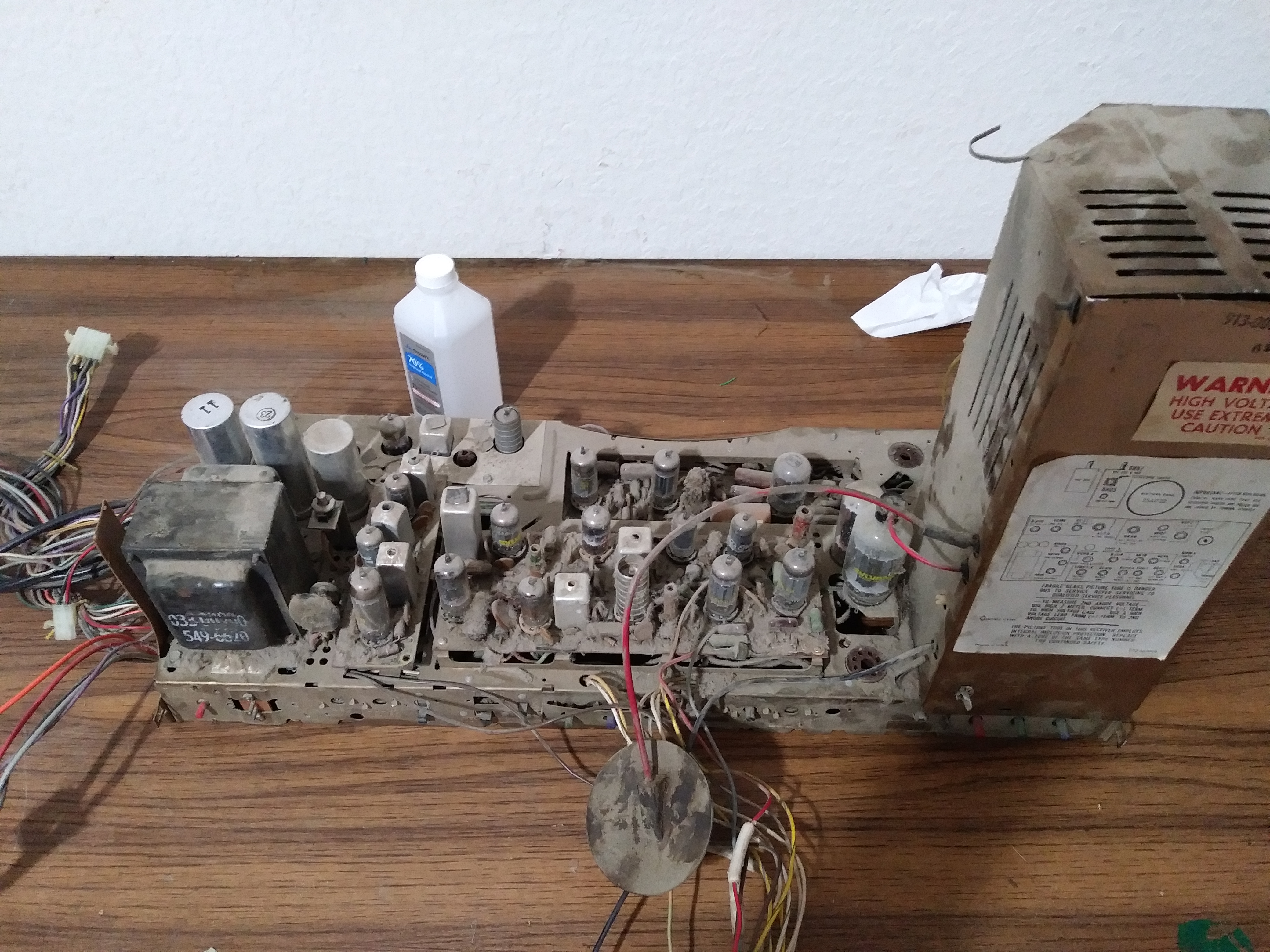

Yamamaya42 07-16-2022 05:55 PM
one very dirty looking RCA type looking chassis.
http://suzaku.live-evil.org/0716221748.jpg
http://suzaku.live-evil.org/0716221746a.jpg

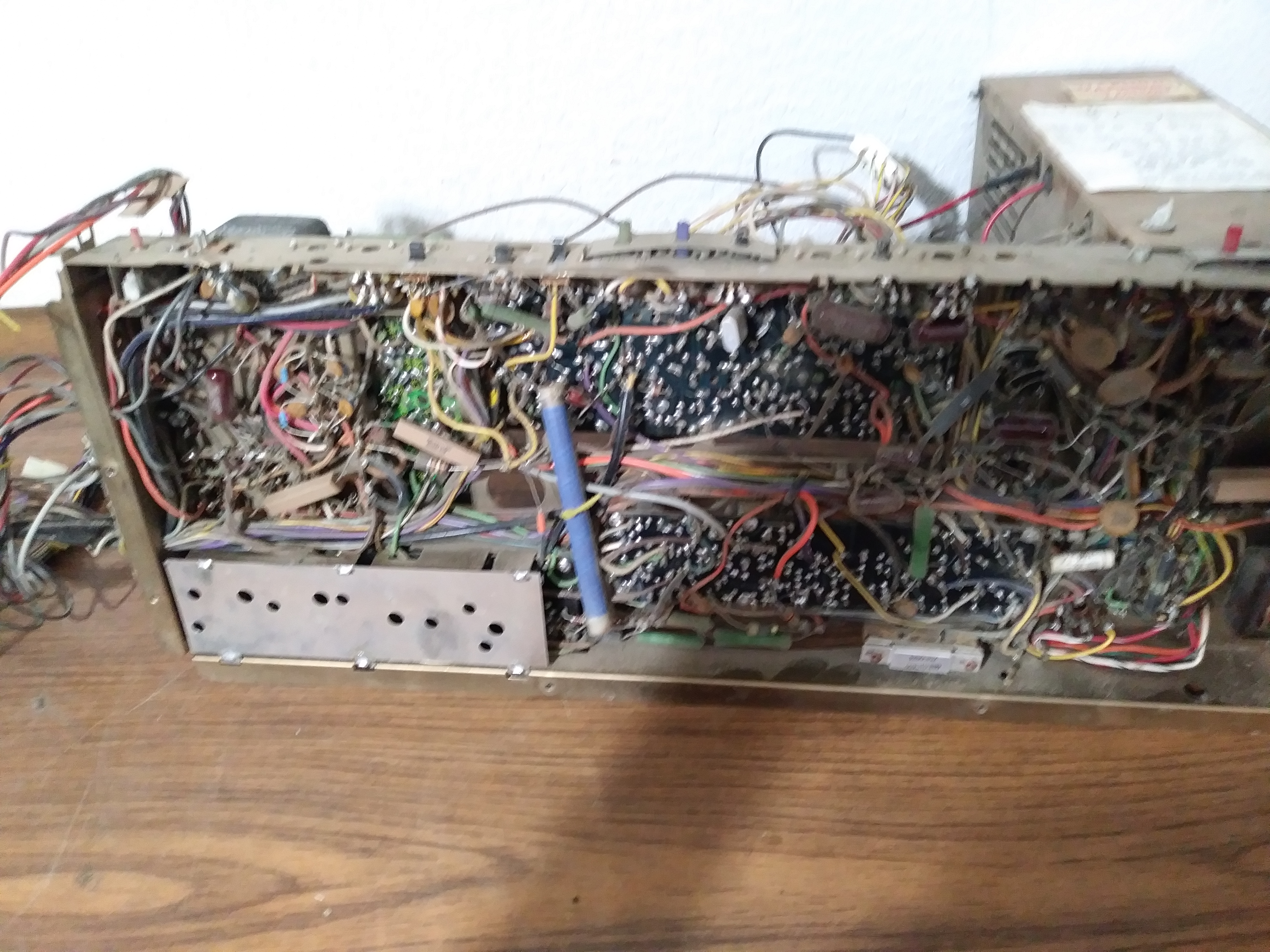

When I looked at the two pictures of the chassis out of the cabinet, I noticed that there were two transformer cans with a piece of black tape over the top adjustment hole. Any idea why they were covered? Was it a way of the manufacturer to discourage "diddlers" from adjusting these cores?
old_tv_nut 07-17-2022 12:59 PM
Curious. Can't think of a reason offhand. Possible that someone who worked on it did that?
old_tv_nut 07-17-2022 01:18 PM
What circuit are the taped cans in?
For relatively low frequency circuits where the stray capacitance is not significant, it would be possible to include a capacitor inside the coil assembly and automatically pre-tune it during the assembly manufacture, before installing on the printed circuit.
Motorola's coil plant made some pre-tuned assemblies, but I always thought they still had to be adjusted after installation in the chassis. I used eight pretuned coils (IIRC) in our redesign of the CBS video film player (EVR), at frequencies around 900 KHz and 1.8 MHz, [linear-phase chroma pilot and chroma subcarrier filters] but they definitely had to be touched up in the final product. This was due to the differences in strays between the winding machine and the final product. It would have been possible to tune samples in the final product and then have the winding machine duplicate the tuning, but it was not worth it because the printed circuit might be changed at some time (material or layout) and change the strays.
