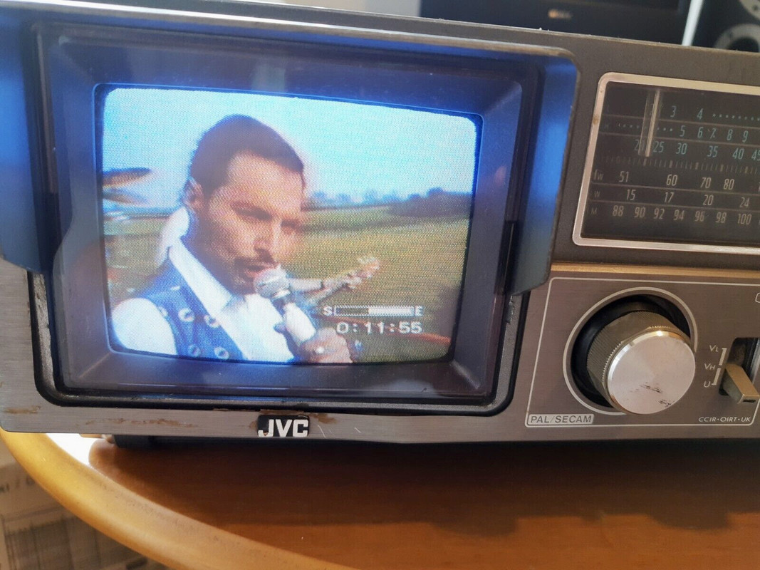

Small color CRT resolution:
in my opinion, the 140BYB22 (5") used in JVC's CX-500 color combo units has the best resolution. Why? because although being an in-line CRT, the phosphors are fine dots instead of the elongated vertical slit shape seen in many others such as the JVC CX-610 series.
Two screenshots below. Forum size limitations reduce the true sharpness of the images
https://i.postimg.cc/hG76NQYR/JVC-CX-500-ME-BG-30.jpg
