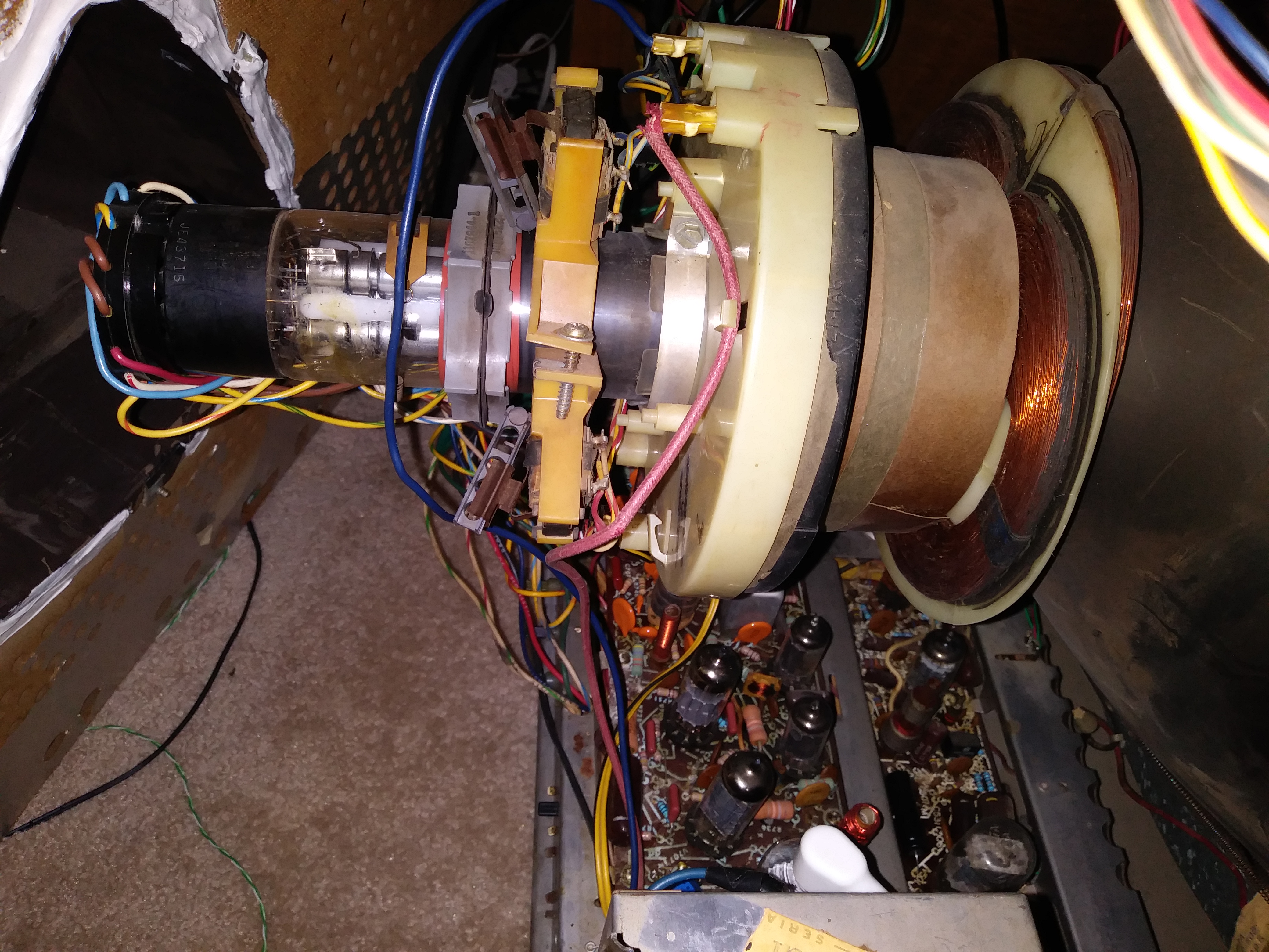

Zsuttle 08-02-2024 09:21 PM
CTC-16 Restoration
1 Attachment(s)
I've been slowly working my way through a CTC-16 that I picked up several weeks ago. The picture tube tested strongly, and all but one of the tubes were RCA tubes. All but a handful of tubes checked out and were replaced. I replaced the electrolytics as 2 of the 3 cans had a fairly high ESR. There was a corroded wire that was replaced on the topside of one of the boards.
I had excessive HOT current, and was able to bring it within spec by replacing several out of spec caps in that section. I was then able to adjust it to spec. HV is still on the low side (20kV) and have yet to look into that.
I put a test pattern generator on channel 4, and was able to get a somewhat fuzzy attempt at a colorbar. I believe it to be a chroma issue, but have not looked into it other than verifying the presence of the chroma oscillator at the chroma synce phase detector input.
Any advice is appreciated in troubleshooting this set
old_tv_nut 08-02-2024 10:52 PM
Your color oscillator is unlocked, but it's not time to worry about that now. First turn the color down and work on getting a good black and white image. It looks like the picture is out of focus, probably related to whatever is causing the low HV.
Zsuttle 08-03-2024 09:00 PM
I was able to work on the chassis tonight and found several more out of spec resistors in and around the horizontal area as well as many of the 5% cathode resistors. After doing so, I was able to get my HV to max out at around 24.5kV and lowered it back to 24kV.
I'm still unable to focus anything. The focus control does nothing noticeable when turned. Both the HV rectifier and the Focus rectifier are new drop in solid state replacements.
Just to check, the boost voltage just provides screen voltages?
old_tv_nut 08-03-2024 11:10 PM
How about using your HV meter to measure the focus voltage, starting at the CRT and working back?
damen 08-04-2024 08:47 PM
As a test, pull the focus rectifier while the set is on. If the screen stays lighted it usually means the 47 or 66 meg focus resistor is bad. A bad resistor can cause the coil to have little if any effect on the focus. If the screen goes dark as soon as the tube is pulled, the resistor is probably okay.
Zsuttle 08-08-2024 05:47 PM
Ok, here's what I've checked. The focus output to the CRT is 4.3kV, which doesn't change with the focus adjustment. Junction of the 66meg resistor checks out to be 4.56kV.
I pulled the focus rectifier was running, the screen stayed lit. I checked the 66meg resistor, it was reading 64.5meg with a megger at 1500V.

Focus at the socket was reading 4.25kV with the tube disconnected, didn't change when the control was adjusted.
For my sake, the focus control should only turn about a turn?
damen 08-08-2024 09:23 PM
The 113381 is a new number RCA used to replace several similar controls. It also replaces the vertical centering control when you remove the plastic shaft it comes with. The focus coil should turn maybe a dozen turns running the coils slug in and out. Check and be sure the slug is moving, I've had them detach from the shaft. Also make sure none of the wires have broken off the coils terminals because it does move around when the shaft is turned. If you have the socket unplugged from the CRT, check and see if you get any voltage on the focus pin on the CRT base.
Zsuttle 08-08-2024 10:09 PM
Well that'll about do it. Focus control was jammed, unjammed it and now I'm able to properly focus. Now I just need to narrow out my color issues. Not entirely sure where to start. Is there a nice guide for proper adjustment of a TV from scratch? I know a lot of service manuals cover purity, convergence, cutoff, etc. Didn't see that in the SAMs for the CTC-16s
