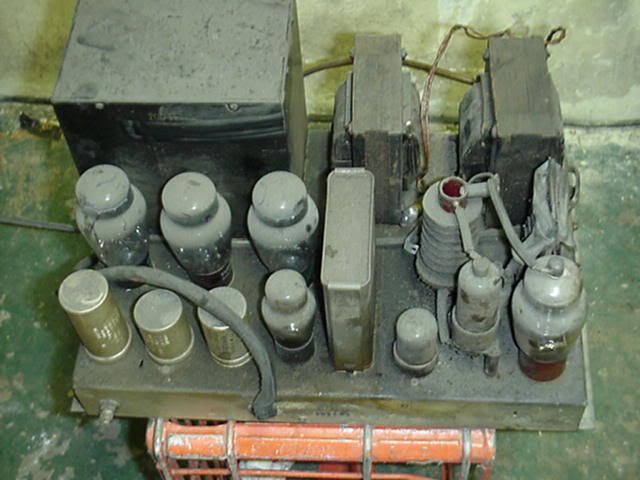

Just curious-- what is that large-ish black can with leads connecting to the top caps of those two power tubes? Bill(oc)

That's a couple of 807 tubes. Horizontal Deflection Circuit.
Thought they looked like 807s with that butterscotch colored base. Never seen 807s used in TV service before. So the HV rect is under the chassis?

HV is generated by an RF supply on the separate power chassis using another 807 as a pulse amplifier.

That huge oil filled can capacitor, do they usually last this long? Or, do they need to be replaced...
