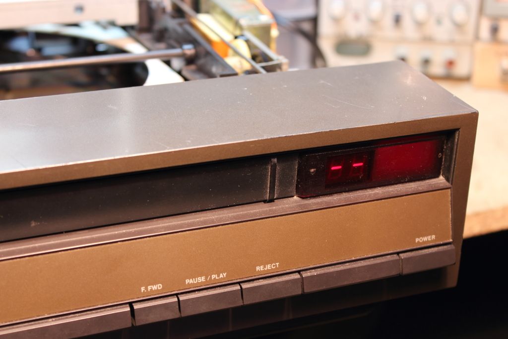

So As part of a large 130 CED cartridge lot (that was a fun $40 ) I got a super-basic RCA SJT-090 player. After repairing a broken loading mechanism, power switch and replacing the lone belt I now have it at a point where it acts like it's working, but it isn't.
Press power and it goes ready to accept a CED cartridge, it loads a CED no problem, the arm rolls out and the stylus drops and it begins to track normally across the disc. Meanwhile however the display just shows "--", the Fast Forward does not work and no video or audio comes out of the RF jack. (but it does obviously switch from passthrough to internal source when the player is powered on).
Press REJECT and it again acts normally and unloads the CED and lets you load it back into the sleeve. +10, +15 and +22v are good and and I can't really question the other voltages given how everything else (aside from audio and video) appears to be working. On visual inspection the cartridge APPEARS to be okay but I've never messed with CED so everything is uncharted territory for me.
I looked over at the CEDmagic forum and it's basically a ghost town now so I'm optimistic I'll get assistance there. I also looked over the troubleshooting guide CEDmagic had and nothing seemed to match up with my symptoms.

The linear tracking arm that the cartridge is mounted on, does it move if you hold the fast forward button? If not, then look for a belt or other mech issue that is stopping it from advancing. When a CED player starts playing a disc it will display -- until it hits a readable track with time code in it, then it will display time in minutes and you should get video and sound. If the arm can't advance to a track with signal then the behavior you are getting would jibe with that.
No.
The tracking assembly is gear driven (woo, no belts!) and functions properly. I can sit around and it will slowly track across the disc over an hour, then return back to the start and repeat because it does that. If what you are saying is the case then either the stylus can't get anything off any of the discs I try or that whole circuit is not functioning. I'm assuming that Fast Forward is directly tied to that time code it's not getting? Again, have no idea where to be looking.

IIRC it should fast forward without being able to read the disc....I usually hold the fast forward key on mine as soon as the disc loads to get it in to the video tracks faster.
I wonder if there is some circuitry issue on yours. At the end it should not restart it should read F or E on the display and open to unload the disc. I can't quite figure on how it scans the whole disc yet shows no time on the display or any audio or video. Perhaps it is not reading a signal off the disc.

The report back is that the stylus cartridge is chipped and produces no output, so now we know what was the problem. It is being rebuilt and we'll find out in a few weeks if that fixed it.
Old 02-25-2015, 10:22 AM
Posts: 1,021
Yes, thankfully the problem was indeed a bad cartridge. The rebuilt stylus arrived and everything worked when I dropped it into the player. I'm amazed how little it takes. It looked fine under a camera's macro lens.
