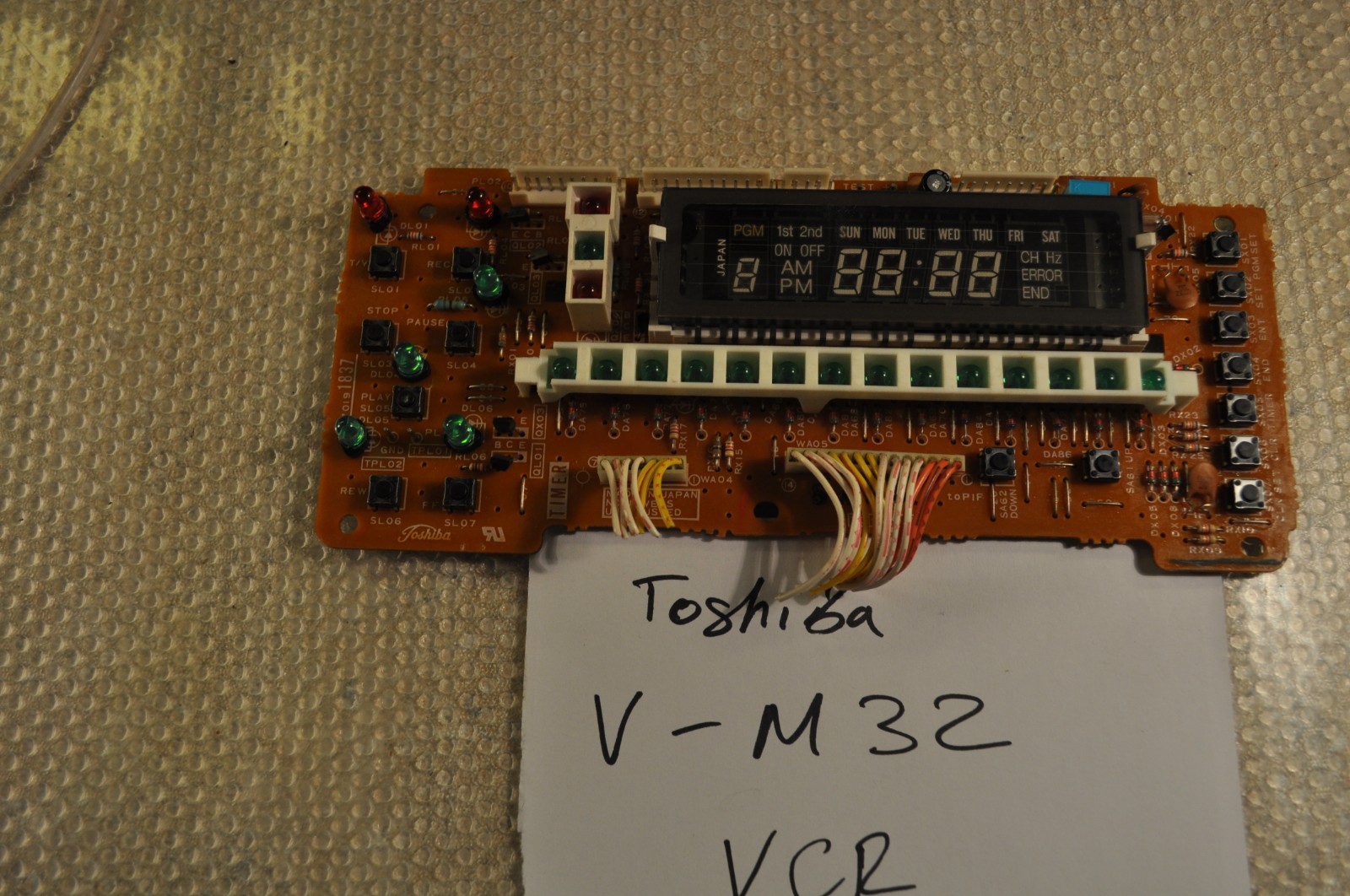

it's about this sign what about mean is
do you have any idea

Hertz?

I have a Toshiba Beta VCR (don't have the model plate in front of me now) that every time it is plugged in will initially display 60Hz for a couple sec then revert to time or counter...Half of Japan is 50Hz power (rest is 60Hz), and a number of NTSC countries are 50Hz power.
In the US it is a common practice to use the power grid frequency to act as a reference for mechanical and digital clocks (count 60 cycles on a 60Hz grid and you have exactly a second)...I believe the same can be done on 50Hz.
Knowing if the VCR is recognizing the power grid frequency correctly could aid in diagnosing the clock drifting.

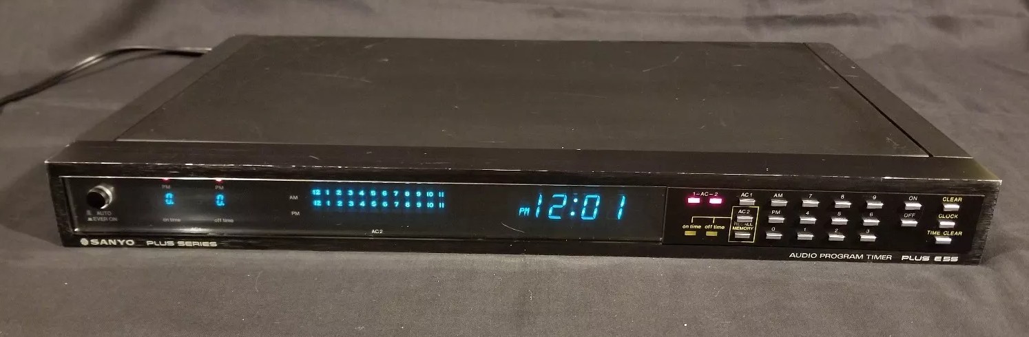

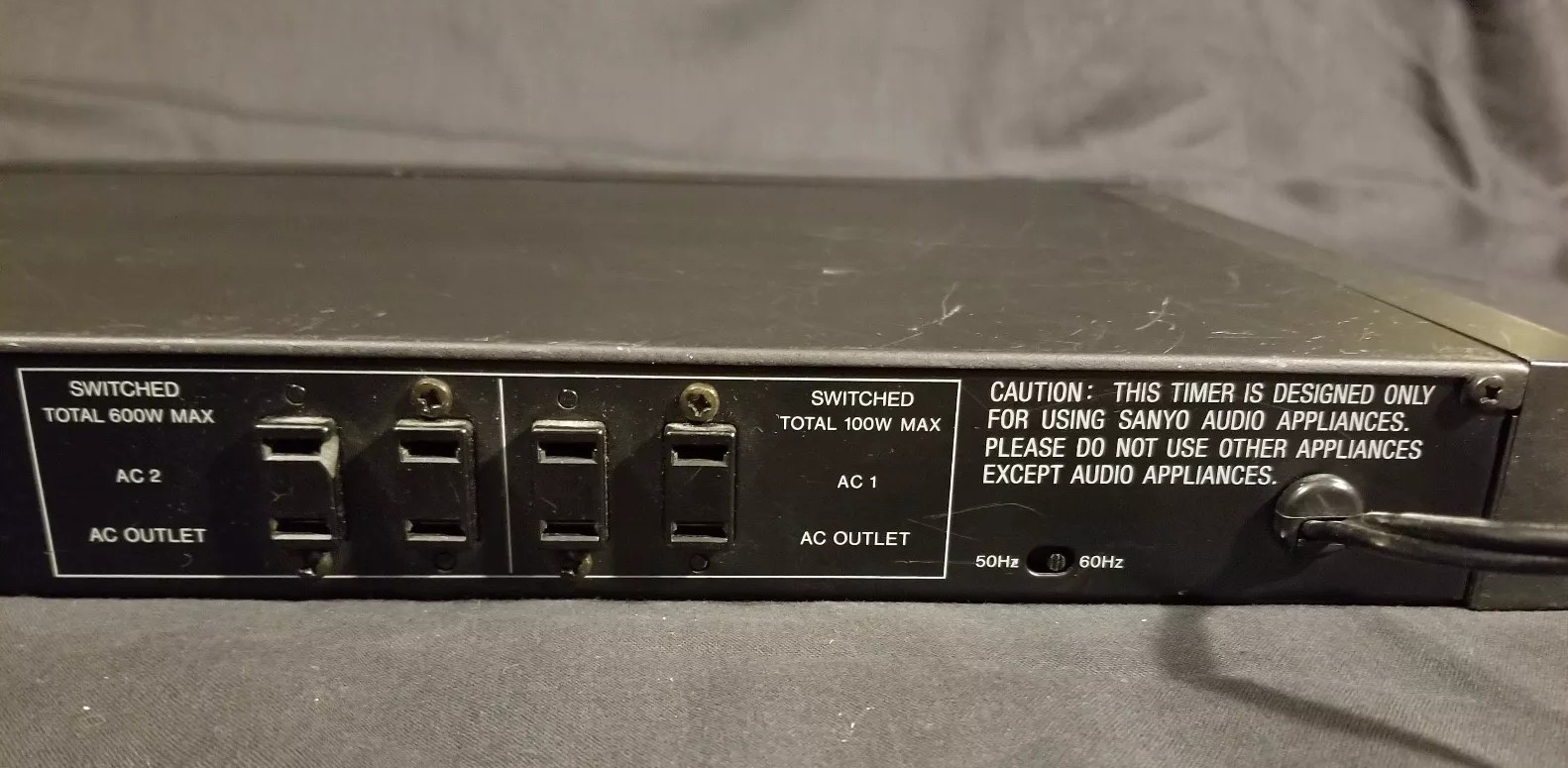

on my Sanyo Plus E55 E-55 Audio Program Timer the power grid frequency is switch by manual
i am curious what chip used that vcr for recognizing the power grid frequency correctly
