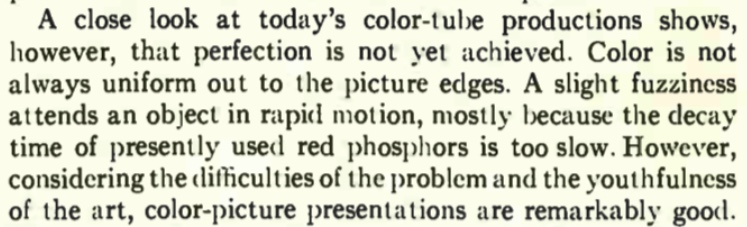

Exact quote from WESTINGHOUSE ENGINEER MAY 1954:
Was it possible that Westinghouse had early access to prototype CRT’s? Yes, but in the article, they talk about production CRT’s and only the 15GP22 was in production at that time. I found an article in Television Digest, May, 1954 talking about new RGB phosphors used in the forthcoming RCA19 inch CRT(cancelled) principally to increase persistence time.

To follow up, I read about the proposed RCA 19 inch color tube in 1954 that (was cancelled because of the 19 inch CBS COLORTRON,) changed the red phosphor to a short persistence zinc selenide formulation and the green and blue phosphors were also changed principally for improved efficiency and balance. Source, Tele-Tech April, 1954.
