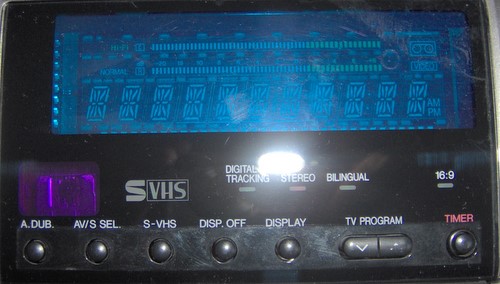

Exclamation VIDEO DATA SYSTEM- the vcr`RDS`system by vps
http://www.youtube.com/watch?v=Z_7Vg...etailpage&t=77
The
GV-698+
incorporates
WSS
signal (
Wide Screen Signaling
) in 8 formats,
FLOP-TELETEXT
in four languages and
VPS
and
PDC
signals for four countries. All
these signals are individually selectable
Easily programmable PDC and VPS
PDC and VPS test facilities are available optionally with the teletext option. Both systems use control information transmitted with the program to start and stop recording of that program on a VCR. For optimum flexibility, you can use any of nine coded PDC or VPS signals and both types of signal can even be transmitted simultaneously. When testing PDC, you can program PIL (date & time), CNI (country & network), PTY, PTL and the program name. You can even test multi labeling. In VPS mode, you can set information on date, transmission time, country indication, TV channel, stereo/dual/mono sound, adult/general program content and the program name. Special PDC and VPS signals such as timer control code, recording inhibit/terminate code, interruption code and continuation code are also available. Programming of the codes for both PDC and VPS is simple, using the instrument's large display and softkeys.

PDC (
Program Delivery Control
Systems
PAL B / G / I / D / K selectable ON/OFF
Frequence
6.9375 MHz
Transmission mode
NRZ (no return to zero)
Data line
329 even frame, in a sequence of 400 ms
Content
START, STOP and PAUSE functions selectable.
Country and minute selectable. Month, day and
hour information are fixed to 1.
"0" level
Black level
"1" level
66% ±5% of the white level
VPS
Systems
PAL B / G / D / K selectable ON/OFF
Frequency
5.5 MHz
Transmission mode
Two-phase
Data line
16 odd frame
Content
Function: START, STOP and PAUSE.
"0" level
Black level
"1" level
http://www.devicemanuals.com/product...XT_manual.html
PDC ON
When pressing this key with the LED turned on activates function
PDC
P
rogram
D
elivery
C
ontrol). With the lower LED of
DISPLAY SELECT
turned
on, the information that appears in field
CHANNEL
corresponds to the country
information. The possibilities are
SPA
(Spain)
, UK
(United Kingdom)
, GER
(Germany)
y
FRA
(France). Between field
CHANNEL
and
CH-FREQ
appears
the information of status
STA
(Start),
STO
(Stop) and
PAU
(Pause). In field
CH_FREQ
the time in minutes of the programming of signal
VPS
appears. The
possibilities are
1m and 5m
. The information of month (1), day (1) and hour (1)
is fixed. The choice between the different possibilities is done with the encoder
selecting first the field and then the function.
Signals VPS and PDC always contain the same information.

BY THE way vps system is father on popular later fm rds datacast
and this topic is for were come from automatically channel name on the vcr vfd display
