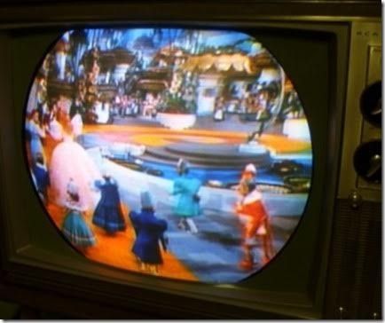

It worked fine about a year ago, and it's just been sitting since. I have all the pictures of it. I'll post them below.
The pictures below show it was working a year ago and how it looked, a year ago.

I can see NO WAY....you ONLY have 12KV here. The pix is WAY too good--and full. 12 KV would NOT give a full raster--and focus woulod likely be VERY bad..
YOU DEFINITELY need to check your HV PROBE !! I'll BET...from that pix...you are getting at LEAST 23KV.

I'm sorry. I did not mean to incite confusion.
The pictures posted first are of the set before the previous owner stored it. It does NOT display like this today. That is how it was. and should be...
That is what I see on it, today. After about 15 minutes of on time, focus goes, then the picture fades out.

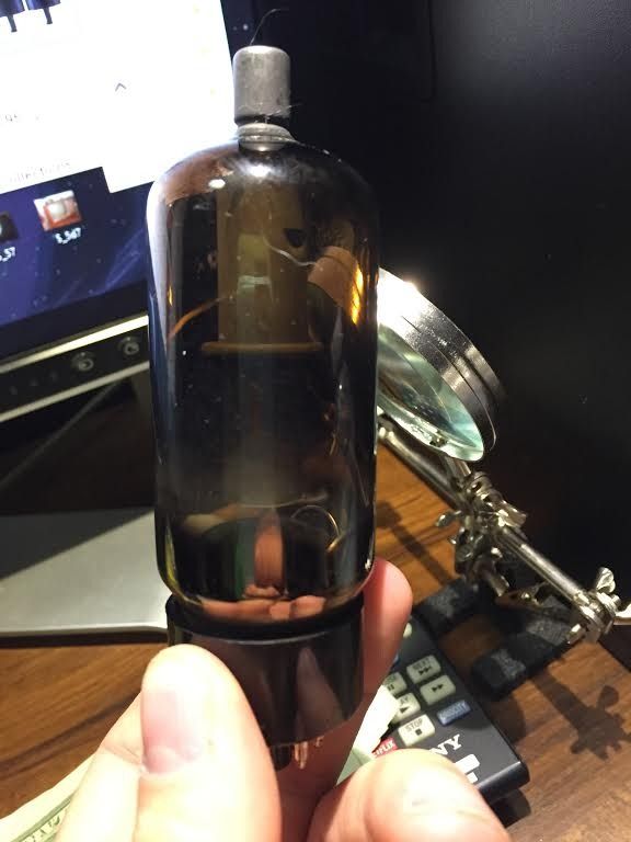

Something tells me this tube shouldn't be so... crispy...and dark. The camera can't even pick up on just how bad it actually is looks.
This is the 6EL4 tube. It's also RCA original.

tube dark from xrays, just means had a lot of use, does not mean bad.
you should 1st try running the set with the CRT plug (the base socket)disconnected, this removes the load of a CRT which may be high due to bad CRT or incorrect bias.
Check HV
if no change, then try disconnect the 6Bk4, this takes the shunt tube out of the circuit, could be a prob if bad or bias is wrong.
check HV
if still no change
Check Horz out voltages, screen and grid
Check Horz out cathode current
Report back findings for whats next.

CRT plug disconnected: 14kv
6BK4 Disconnected CRT plugged in: 14Kv
I'll have to check the other two after my trip to see Jim.
I made sure I had a stonger connection with the probe today, the set is managing 14Kv
