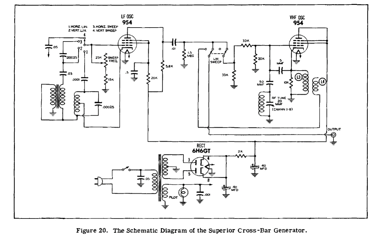

Old 01-04-2022, 07:48 PM
Posts: 785
I finally found a schematic for this so I thought I'd add it to Bob's thread. Now I can get mine going as well. My unit has never had a working bar oscillator.
Schematic and article was found in How to understand and use TV test instruments by Milton S. Kiver. Page 99 - 100
The schematic predates the use of a war surplus 7193 for the rectifer.

Old 01-06-2022, 08:41 PM
Posts: 785
Lol this. Their choice of a 954 VHF tube was total overkill. I was working on mine back in 2008 when I first got it and it turned out it was completely wiping out analog channel 6 over at my Dad's place 150 feet away with no wire attached to the RF output.
