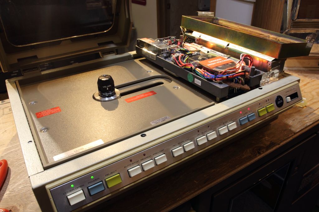

After about two months of work and planning this thing landed on a workbench late last night. I'm gonna take a hit on this but I'm declaring it the first laser videodisc player to reach mass production, beating the VH-8000 almost exclusively by its internal use for quality control.
I'm working on pictures right now but immediately I'm running into three major issues. While it does turn on and suck a spinning disc under the fixed laser:
-The laser interlock is sticking. There is grease or a perished rubber bumper somewhere beneath the laser assembly that prevents the disc from automatically opening the path for the laser
-It's struggling to focus/find a sync signal off the disc. I can hear the focus servo run a few times before the player gives up. I can see some of the optics are fogged but cannot tell if this is front or rear coated mirrors which complicates cleaning them without scratching them

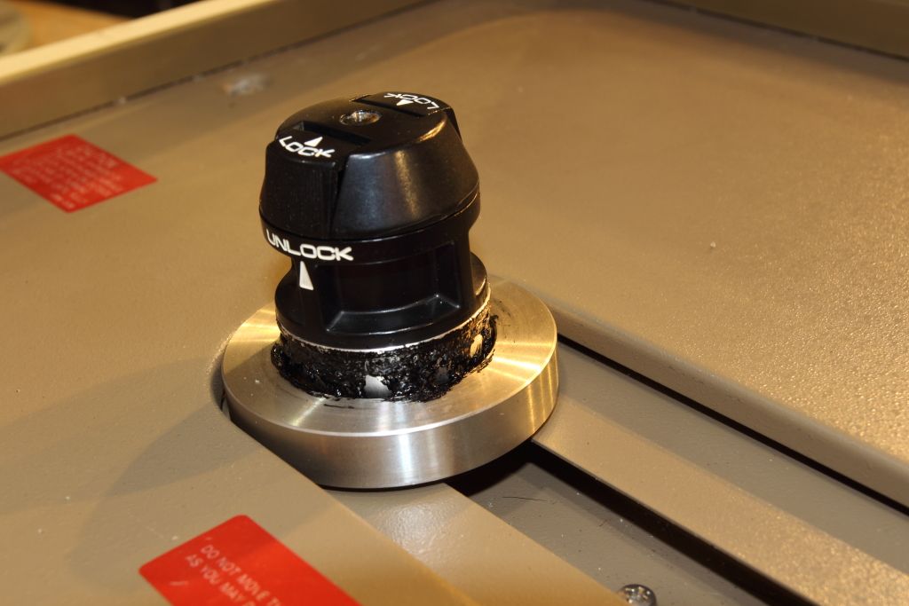

-There is an o-ring on the spindle lock that has perished. When a disc was loaded and clamped it immediately proceeded to glue itself to the disc hub.

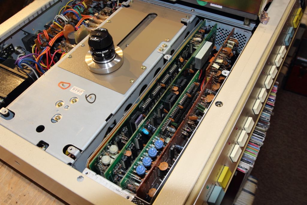

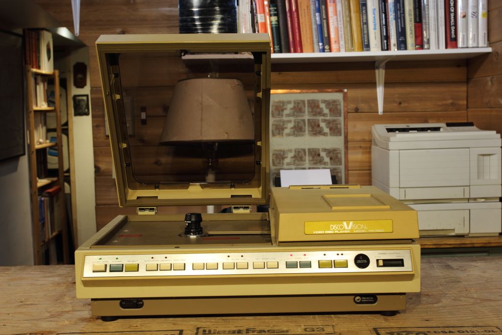

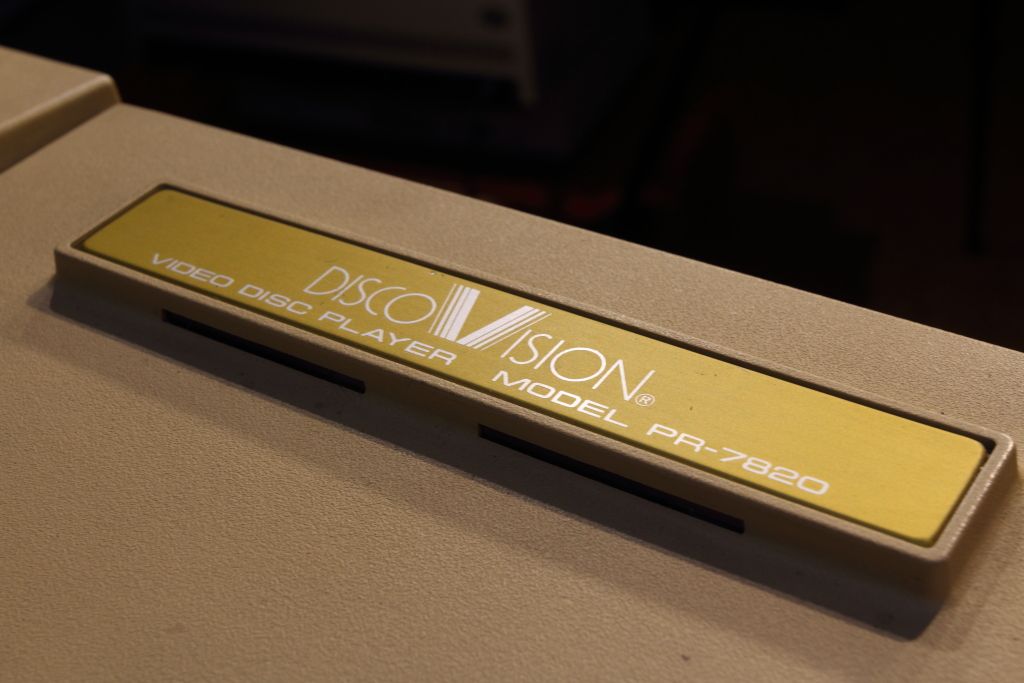

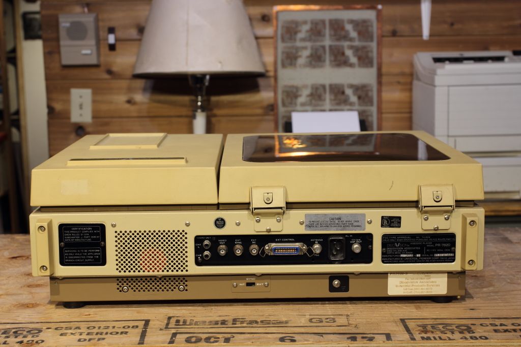

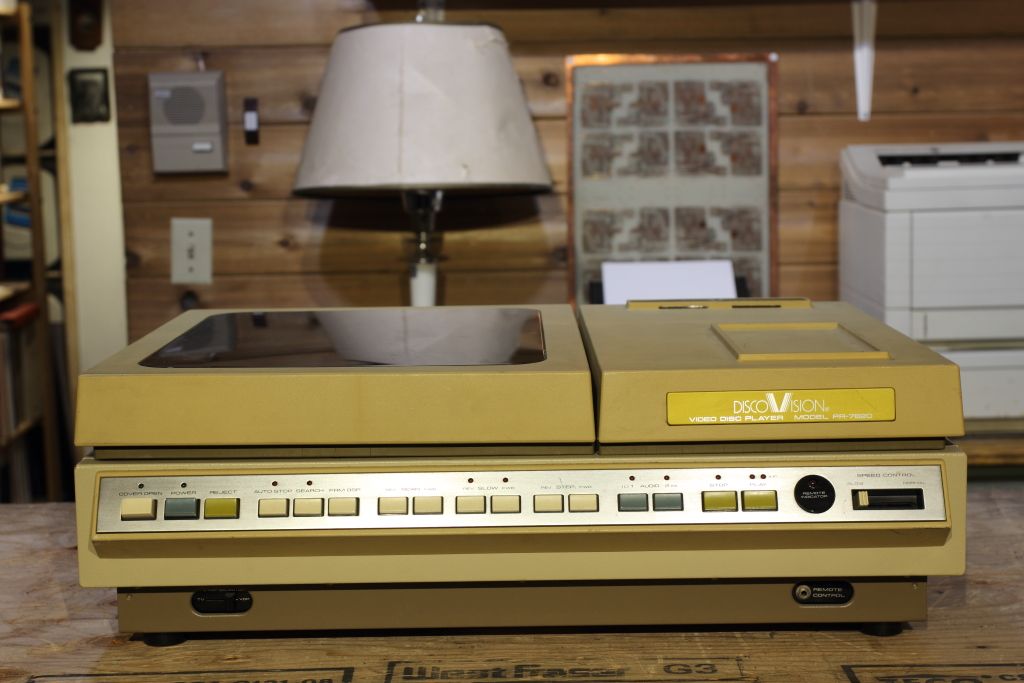

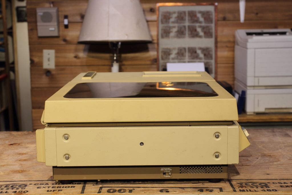

Anyways I had to get it home to do more work on it, plus photos, so here are some of the cleanest photos you'll probably find on the internet.
This particular unit was manufactured in February 1980, four months before Pioneer would release the VP-1000 and likely not long before PR-7820's stopped selling under the DiscoVision brand and instead under the Pioneer PR7820 Model I/II/III name. I do not unfortunately have the remote.
I cannot really proceed much further until the rubber hub bumper is replaced. A suggested replacement was part of a bicycle inner tube as opposed to an O-ring. I need to dig through the service manual (I found the FULL thing, it's 135mb!) on how to remove the spindle for cleaning but I cannot proceed to the laser issues until then.
Like I mentioned with my initial check the laser is good. The mirrors were oh-so carefully cleaned but with a disc loaded the focus assembly drops down and then snaps back up to try again. It does it as well with a disc not loaded (the machine lacks a disc presence sensor so you can operate the unit without a disc installed) but is a lot gentler with the focus attempt, so it does know SOMETHING is spinning but I can't tell if it's because of a pickup issue or the molten bumper causing the disc to wobble too much to permit tracking.

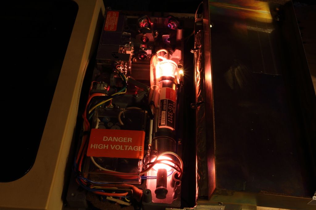

The laser is also delightfully dangerous.

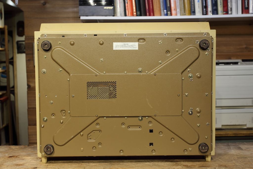

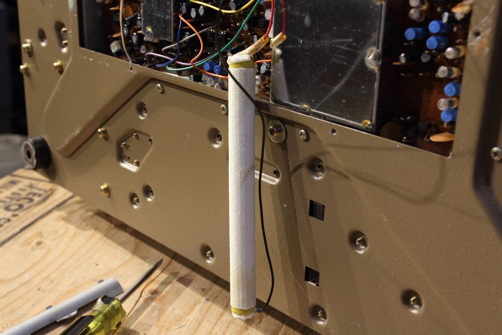

The only other thing I still need to research is that there is a battery in the unit! It's behind a panel underneath at the lowest point of the machine where a leak is acceptable and it's easy to clip the leads and remove. I have no idea whit it might be for aside from keeping the 1K dump memory alive for short periods of time.

I was able to clean the rubber off by removing the screw on the top of the spindle and disassembling the latch but when it came to the sticking laser stop I had to get underneath the optical deck as up to now I was just pushing it open with my finger when the disc moved into place. The deck is mounted with three posts and three hex nuts. As it turns out if I had read the manual this step requires realignment once the deck has been moved, so sure the stop moves freely now but without the specialty jigs I have no way to realign the deck. Mother$*&@.
Also as it turns out there's a Ni-Cd battery mounted underneath the machine in the lowest possible place. Apparently the 1Kb of dump memory (the player can operate as a standalone device for interactive discs by data being stored in audio format at the the beginning of a disc in the Right channel) has a battery backup for power interruptions. Why it has this exactly I can't figure out as after a power failure you will need to restart the disc again anyways which would automatically reload the dump. Anyways a battery of this age is obviously going to be leaking and it's pretty easy to clip out.

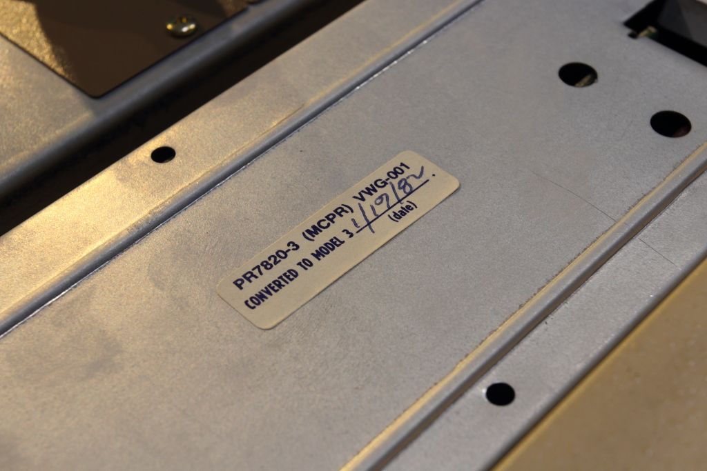

Edited: Oh but this is kinda cool. While this is all the original DiscoVision livery, the internals have been upgraded to the Pioneer PR7820 Series III, which was the late revision just before it was discontinued. The two big things here is faster access times and complete support for all the available interactive DiscoVision titles, plus backwards compatibility with the older host interfaces.

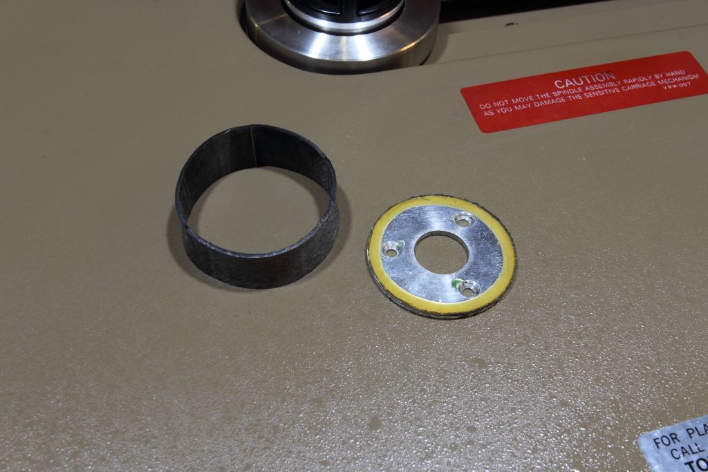

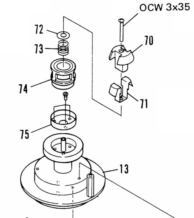

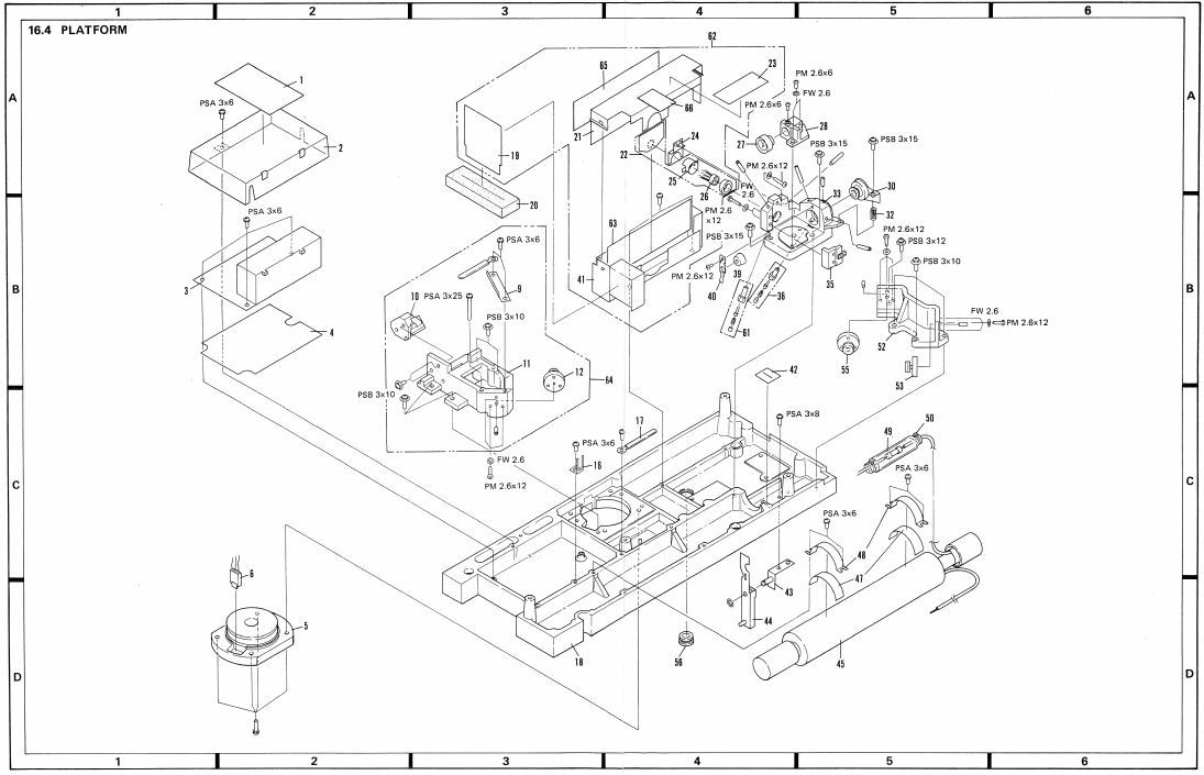

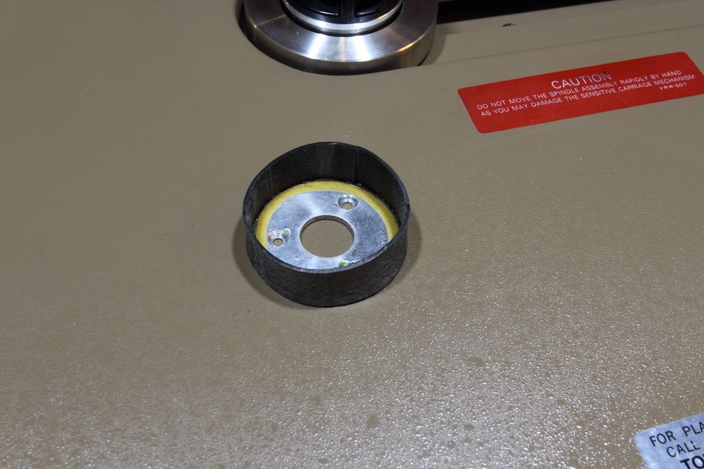

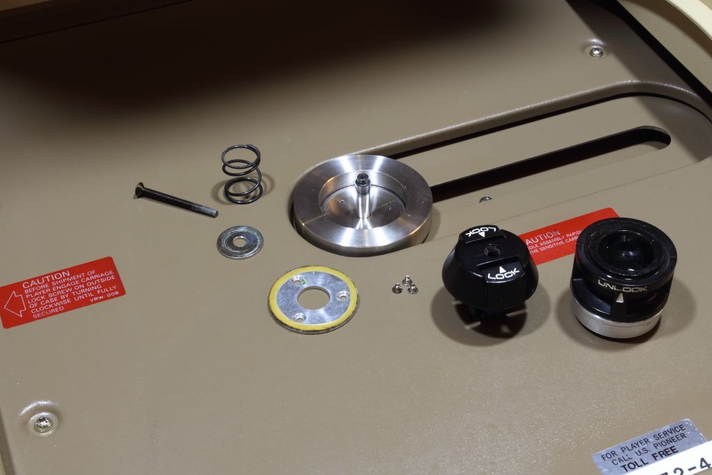

I'm currently experimenting with various sized inner tubes to replace the rubber sleeve. So originally it was a rubber cup that's exactly the diameter of the hub ring on a laserdisc and the spindle. The spindle latch is a tapered assembly that under spring load is extended. When you press down to lock the disc the tapered portion pushes the sleeve of the cup outwards and uniformly holds the disc by the hub. Right now I have a bicycle inner tube that is a close fit but a millimeter or so too wide, so I have to hunt down another one to see if I can get a better fit. If it's too loose it overhangs the spindle and the disc won't fit.
This is the assembly disassembled, plus the manual diagram.

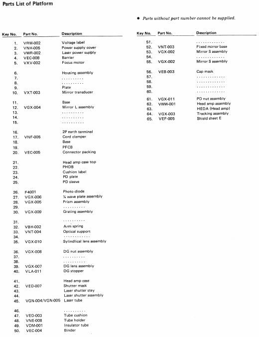

This is the cup itself. MCA and Pioneer list the part number VXX-003 "Rubber Plate Assembly". Pioneer's parts department still lists it as existing and costs $51.20 however as of this post the page indicates it is no longer available. - http://parts.pioneerelectronics.com/...tNum=VXX%2D003
Note the yellow material is the original adhesive that was used to bond the rubber to the disc.

So testing found the voltage rails were stable, the photodiode was detecting "something" and when I poked at all the capacitors I could reach with a Capacitor Wizard they were mostly reading fair but many of them are bipolars so I don't immediately have replacements readily available.
I made the bike inner tube behave and with no less than two different remote controls I can now say the player is completely functional, except for it still will not lock onto a disc and display anything. There is a test point for indicating a focus error condition and that doesn't seem to be indicating a problem.
