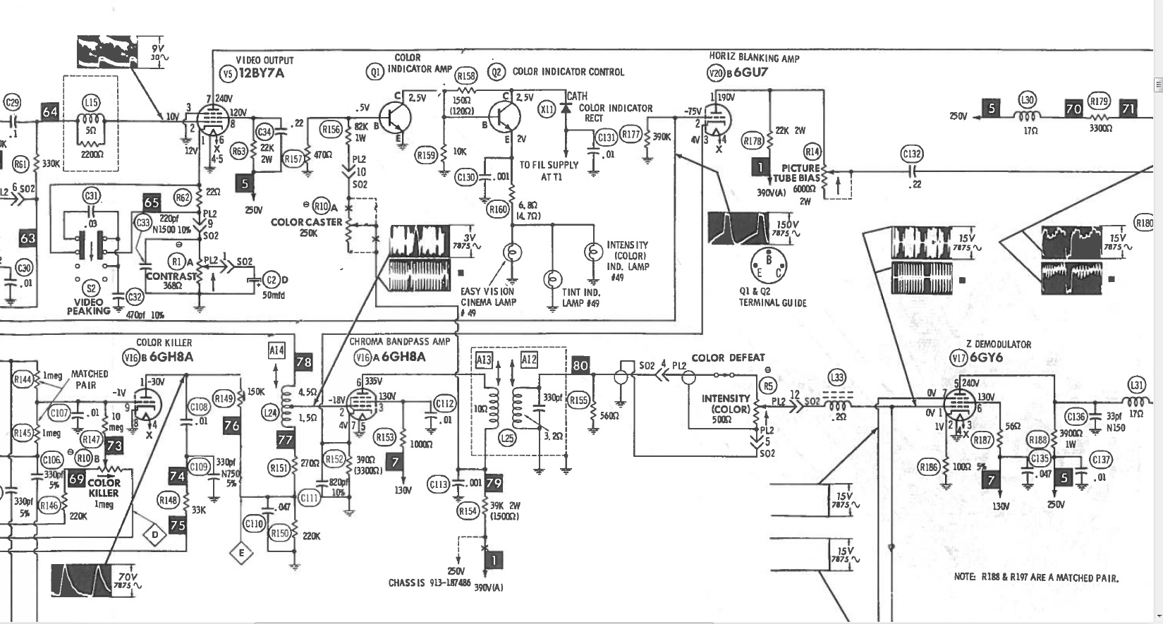

I have been looking at the SAMS for a while now, and just LOLing!
It's obviously an RCA CTC-17 -ish type clone, with mods, but what got me was the totally pointless mod of what is called the “color caster” color indicator circuit, which is 2 NPN transistors hooked to the color bandpass, which turns on 3 lights when color is present.... WHY BOTHER? :O
HEY, WE HAVE COLOR! let's light up the color, and tint controls!

Well, hypothetically, the color could be turned all the way down accidentally by kids or even the supposedly intelligent owner.
Of course, in later years we had cable systems that never turned the color burst off on anything including black and white movies, producing crosscolor when it should have been killed. By then no sets had a color indicator, but it would have been useful to me after I turned the color down deliberately on black and white movies.
Edit: well, not really useful, as it would always indicate color, but it might remind me to turn the color up again.

1 is good, 2 is a charm, 3 is nuts! :P
http://suzaku.live-evil.org/crazy-color.jpg

Wow - they even had a color defeat switch. This would make the indicators useful as the user might have turned the color off with the defeat switch.
The reason for a color defeat switch was for cases where a set was used in a fringe area and the noise might have made the color killer unreliable. The color killer control could be set to make sure color programs got through, but the switch could be used to eliminate color snow on black and white programs without disturbing the color control setting. Obviously the color killer and color indicator could have different thresholds. I wonder if the color indicator tended towards false positives or false negatives under noisy conditions.

I always thought the color defeat switches on the various brands were to eliminate color on fringe color programs where the picture looked worse in color with snow than without color.

What gets me is the 3 parallel lights, " Easy vision cinema " Say what?
