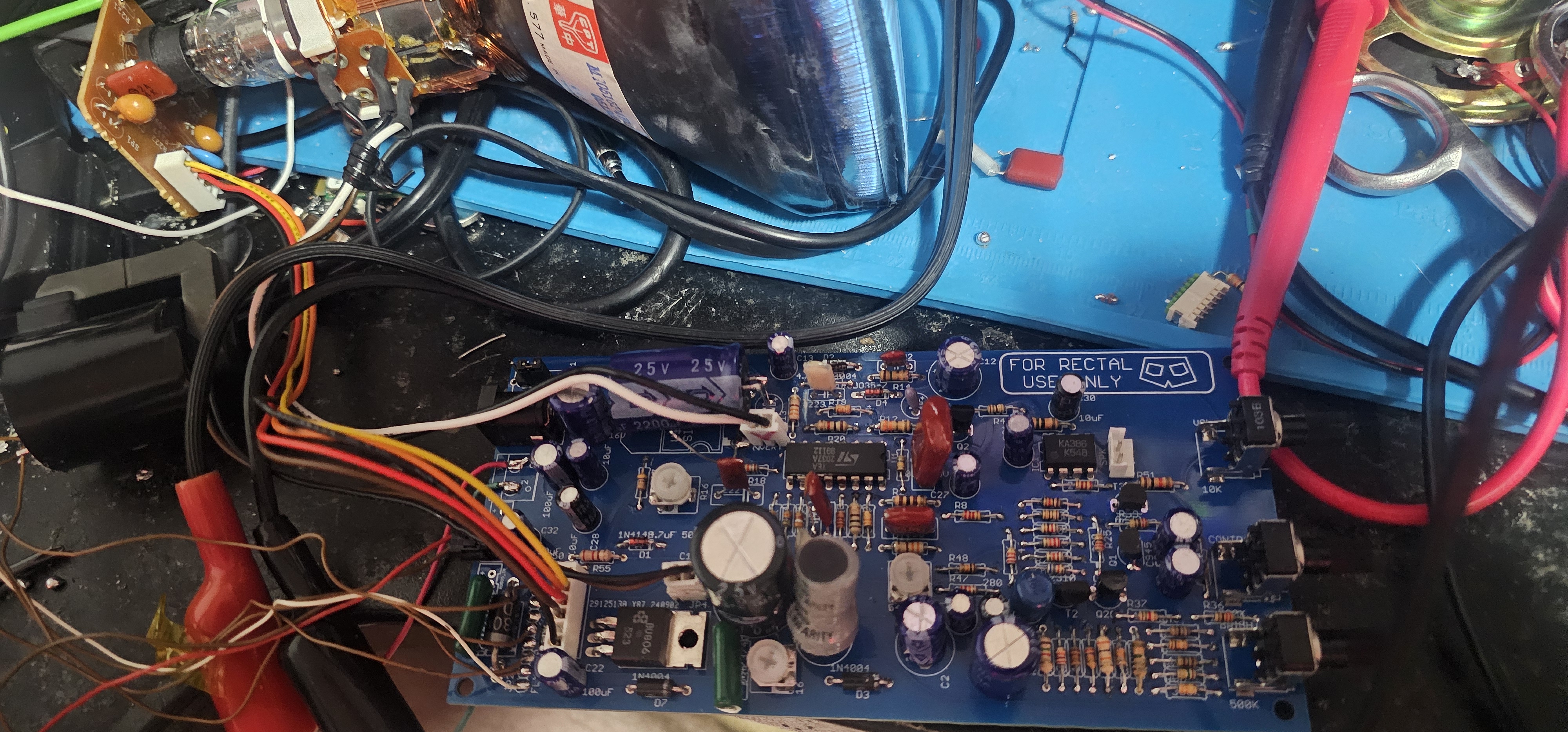

So, I've decided to build my own black and white chassis, based around the TEA2037A IC.

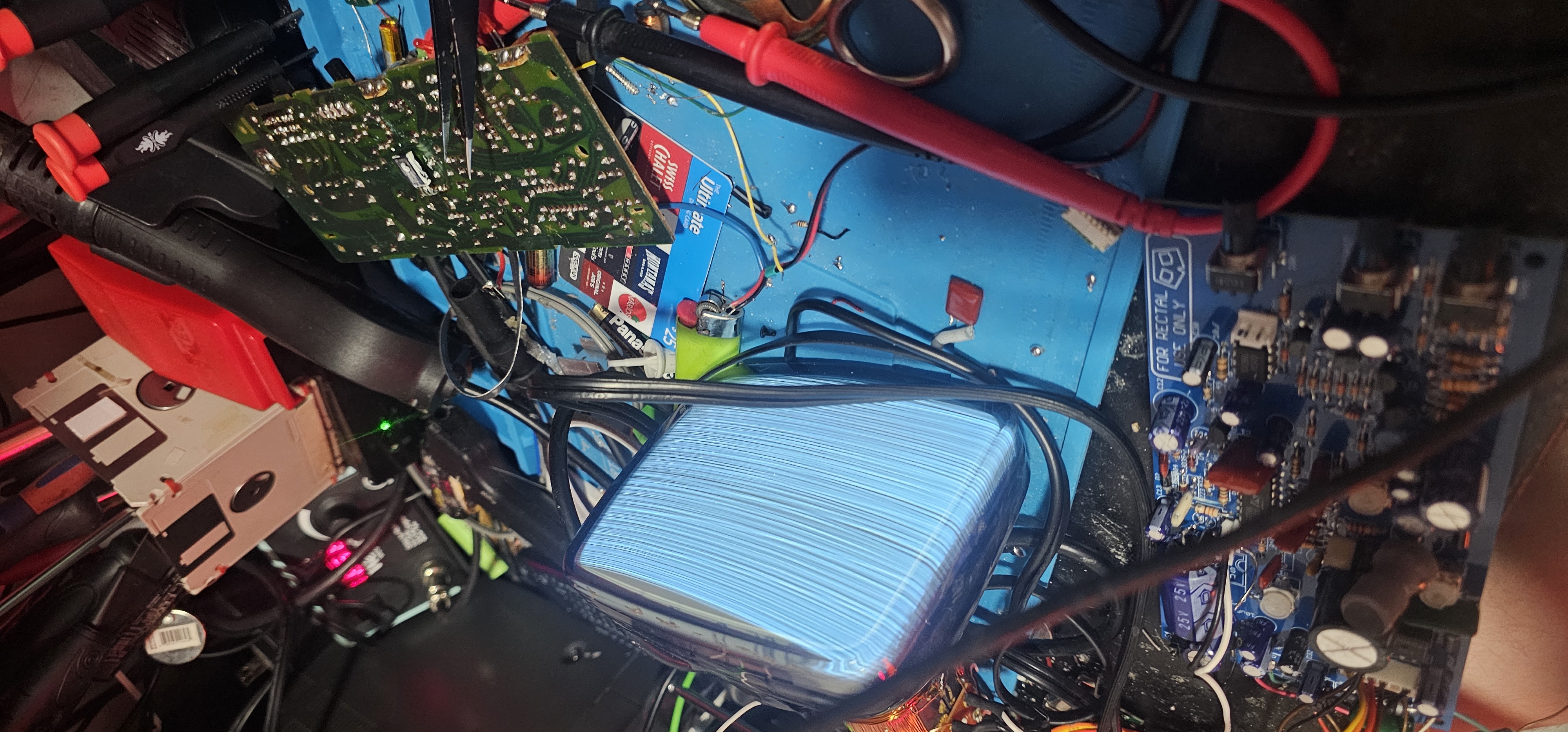

Got the HV Working, and the deflection partially working. Here's where I'm having issues. Horizontal works, but the vertical is very noisy, and not a smooth raster. What fo I need to do to fix this?

Seems that the H freq is out... if signal (video) are being injected.
This is without video injected, but when I connect video, it displays the same. I'll look into adjusting the H frequency

Seems to have even a linearity coil
BTW; maybe a interference in the H (making the lines jittery), or V circuit, like you first suspected, also, is good to check

Could be that. I'll check next time I'm at my bench. Supposed to have a blank raster, like if you removed the tuner from a TV set.
