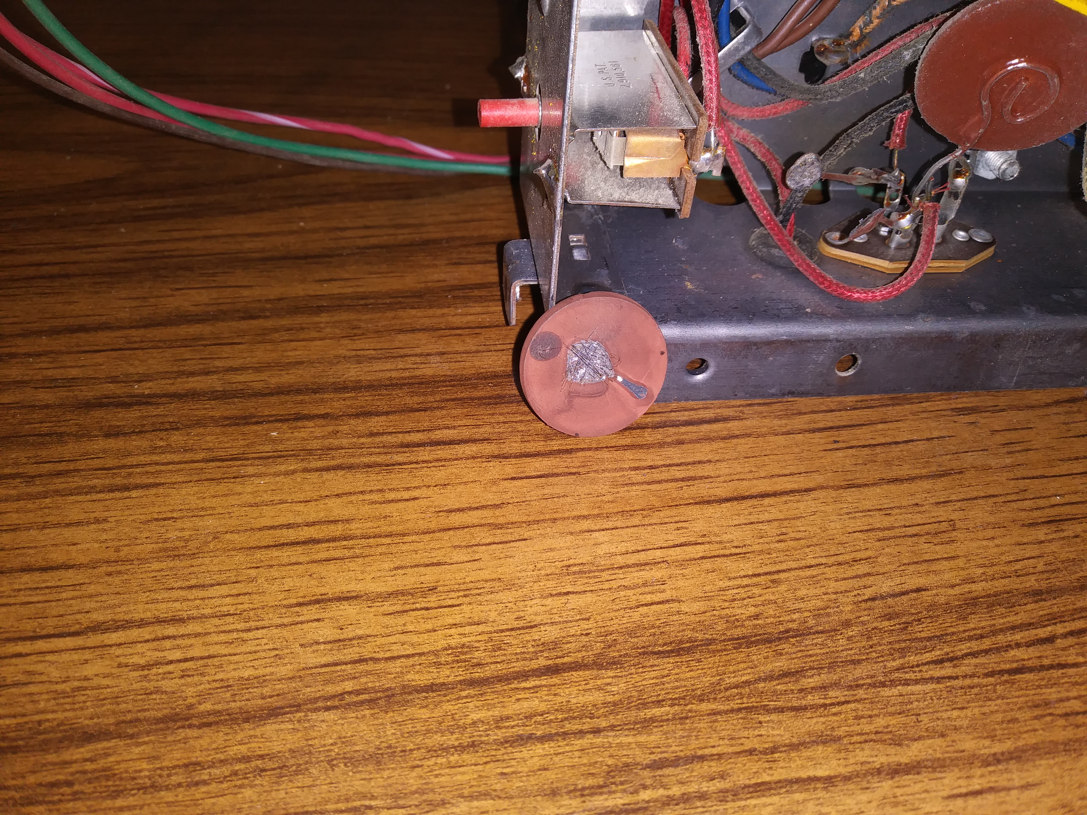

These things?

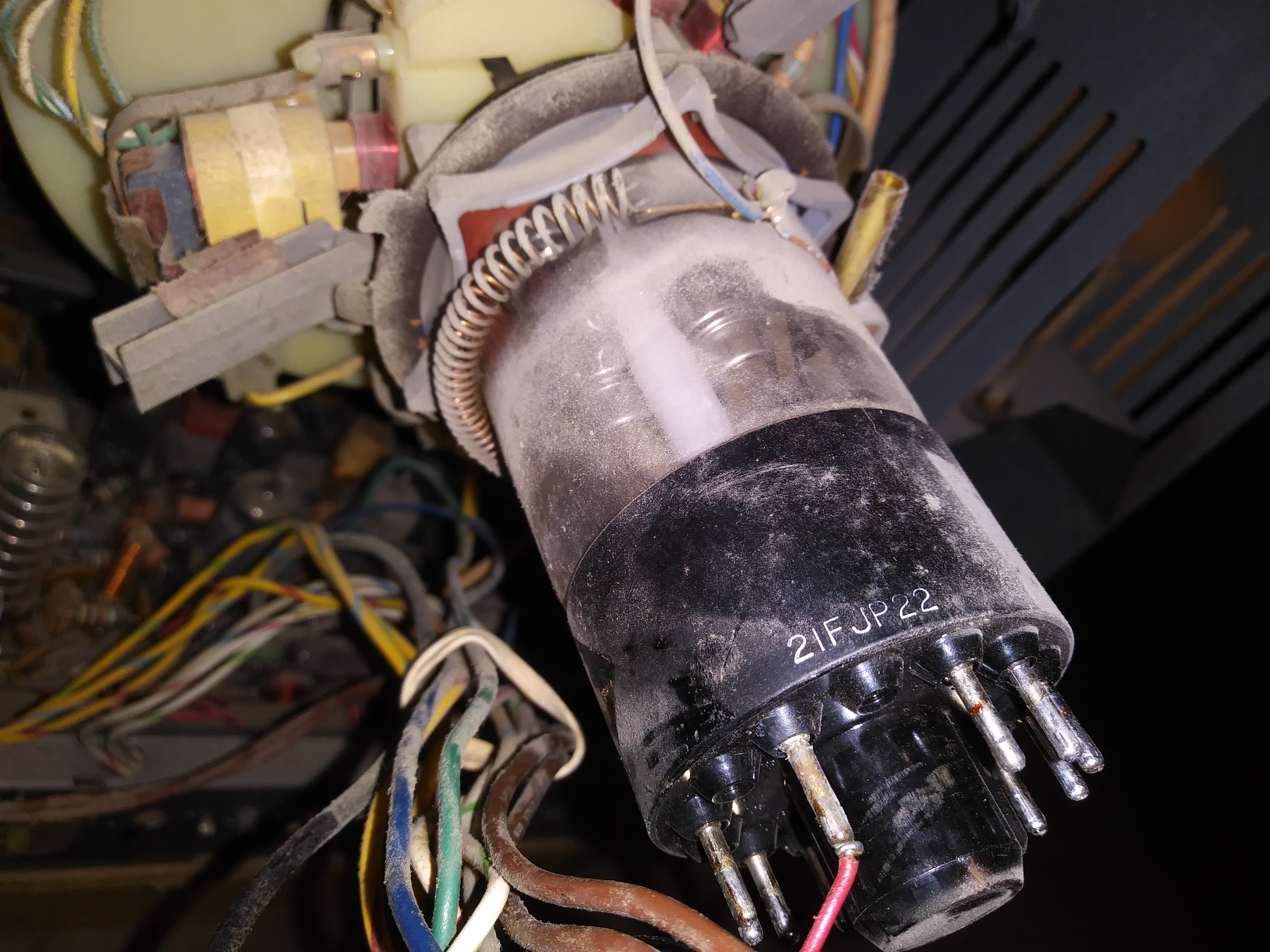

Looks like there was some trouble with the focus pin. Wire is directly soldered to the CRT pin!
Decided to pull the chassis so I could give it a good look over.

OK I'm really glad I pulled the chassis now. That terminal in the center of the screen was never soldered!
Are these vintage EM type capacitors plastic film?

yes, those clips hold rear of the chassis.
Looks like C146 & C147 Think they are just standard orange drop film, they should be OK, id they did not burn.
