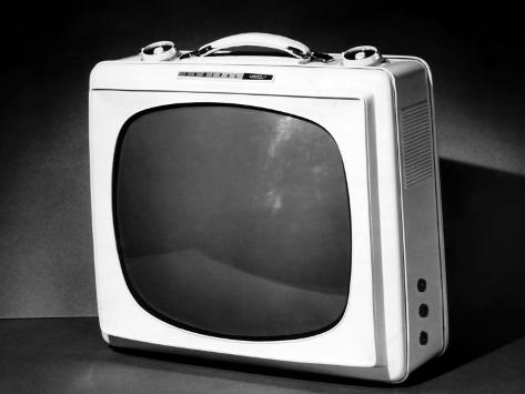

Finally got this Olympic delivered to my door today.
The seller originally wanted to use UPS, then FED EX, and finally went with USPS, which I asked for, and I will always go with them when possible for shipping.
Everything looks intact, all I did was clean a little of the top, just to see what was there under all the dirt. It's a very cool looking redish cloth like material, similar to the coverings of the portable record players from the 60's. The material is still in great shape, no tears or rips, all knobs present, only some rust on the handle hinges. This should look like new after a good cleaning.
Took the back off, and looks like this baby sat for a long time.
Will need to check the CRT, then hopefully, bring this set back to life!
I really liked this set because it was very unique looking, and much different then the others sets I have. I would love to find an ad for this set somewhere, as of yet I haven't seen anything similar....

Interesting set, what is the motor up top? Remote or Timer?

That was the set I was thinking about. US made, power transformer, etc.
It looks like the motor is a Telechron auto shutoff timer.
It's a little rough, but an example of probably the last US built Olympic portable.

I think that is an auto-shutoff time, too. This set would not be a bottom of the line model. Most of the Olympics I saw were series string designs.
When you clean on those tubes, be careful. The Olympic badge will just wipe off, if you are not careful.
I'd just use a clean paint brush and a vacuum cleaner to get the dust.

Is that yellow filter cap just dangling in mid air as it appears, or does it have a nonexistium support bracket?
That can't be original, can it?
