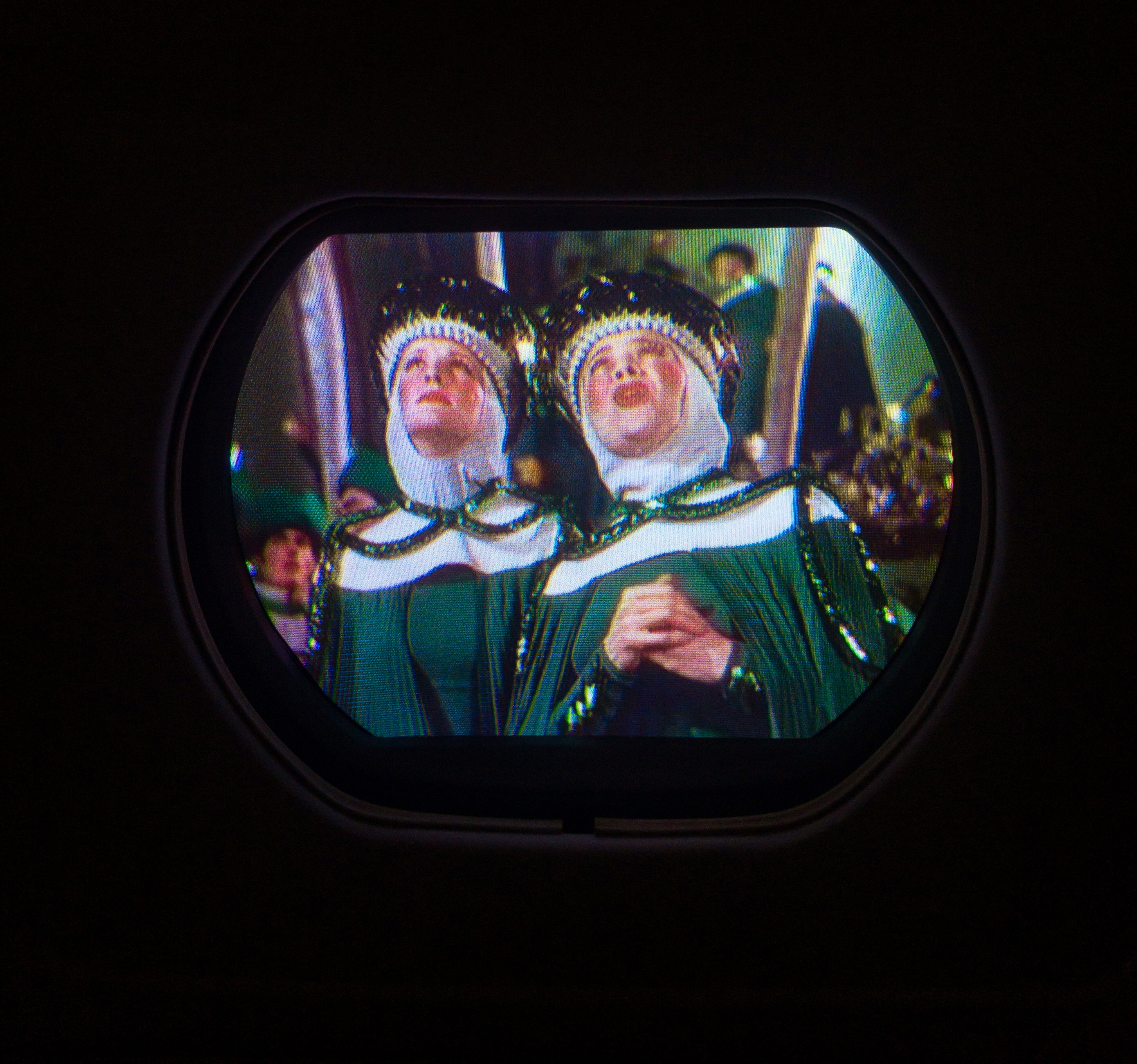

It was suggested that we try rendering photos in Tiff file format to show 1954 NTSC extended color gamut color phosphors. Tiff is an uncompressed format, unlike Jpeg, that captures the full dynamic range of the photo. My Sony A6300 so far, will not download Tiff files to my iPad Pro 2 with WCG P3, using a mini USB to Lightning cable and Imaging Edge Mobile software Sony supplies with the camera. So we found an APP for my iPhone X that allows Tiff image capture. We used Lightroom for iPad editor for processing. Lightroom automatically converts the finished render to Jpeg which seems self defeating, but it does seem to capture the edited colors correctly to my untrained eyes. I have saved Tiff files with Affinity Photo editor and compared them to the edited JPEG’s and don’t see much difference on my P3 display.
I have set up a low resolution gallery with commentary to fit VideoKarma’s page format followed with 11 VERY LARGE Jpeg files. I can say that the greens are rendered as I see them on the 15GP22 with the movie, Wizard Of Oz. The reds are deeper, but I can’t say they are 1954 NTSC correct. In the meantime, will be working on getting the Sony to talk to my iPad.
Note: First three links are the low resolution preview files. REMAINING 11 FILES, YOU MAY NOT SEE THE CORRECT COLORS WITHOUT A WIDE COLOR GAMUT DISPLAY.

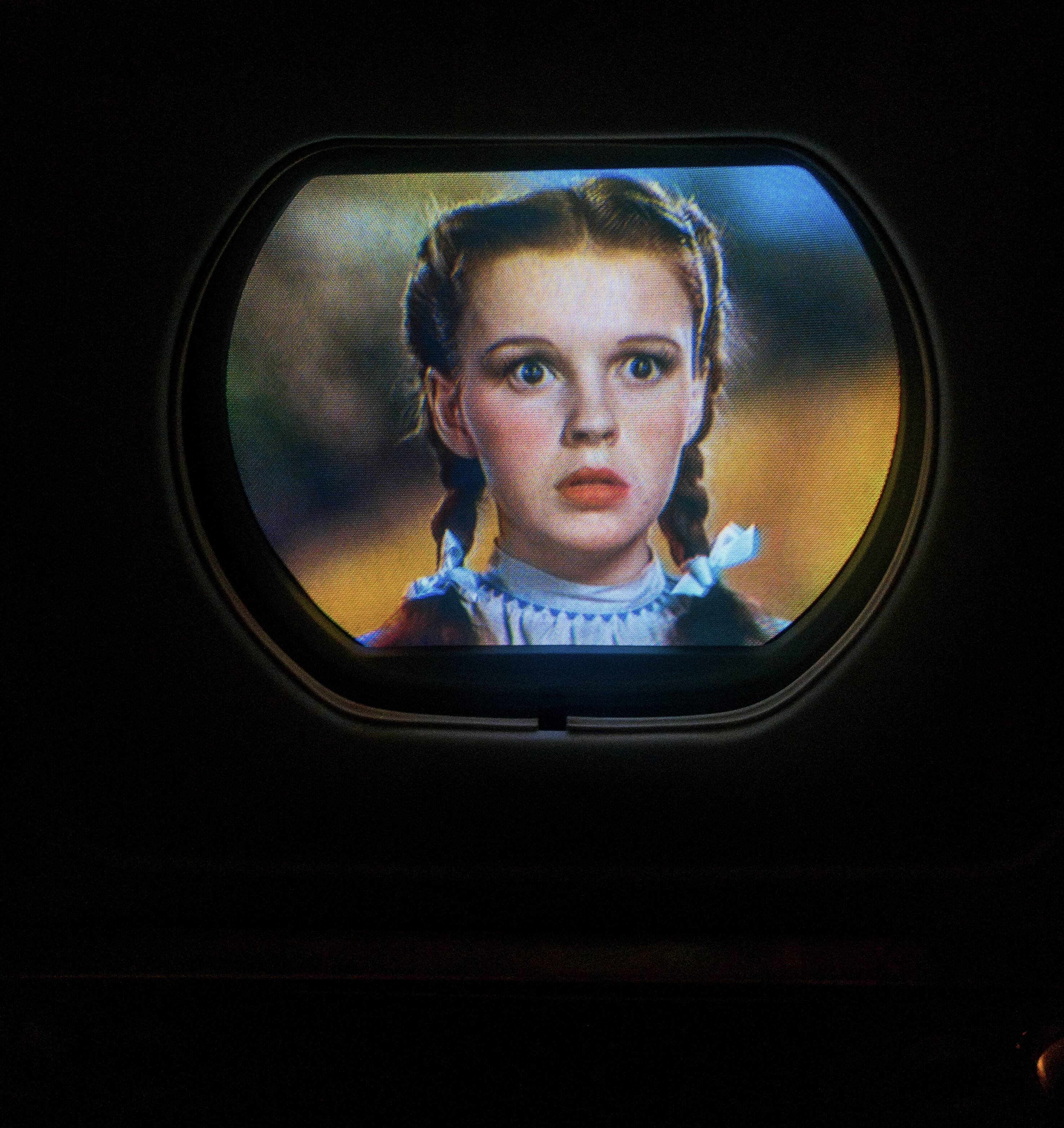

We continue to learn photo processing and how the various settings interact with each other and how colors interact with each other. I confess the previous posting was a bit hasty and we could have done better.
We want to document color as displayed on a RCA 15GP22 in a Westinghouse H840CK15 while still operational and working well. We hope to display the “correct” NTSC 1954 colors if possible.
We had to compromise for now, using a iPhone X. The previous post explains why. This time edited with Affinity Photo. The Tiff file prior to editing looks balanced but flat. Minimal adjustments required: Increased brightness (not exposure), increased saturation, shadows and highlights. No color values were changed. The misconvergence in the upper left hand corner distorts Dorothy’s face. You can see a convergence issue at center edge right. Also the center characters cape needs more magenta, but close. This photo approximates what I see live. I chose the file because the scene seems to “pop” when viewing, probably because it’s well lighted. This file is jpeg converted from tiff. Continuing.....

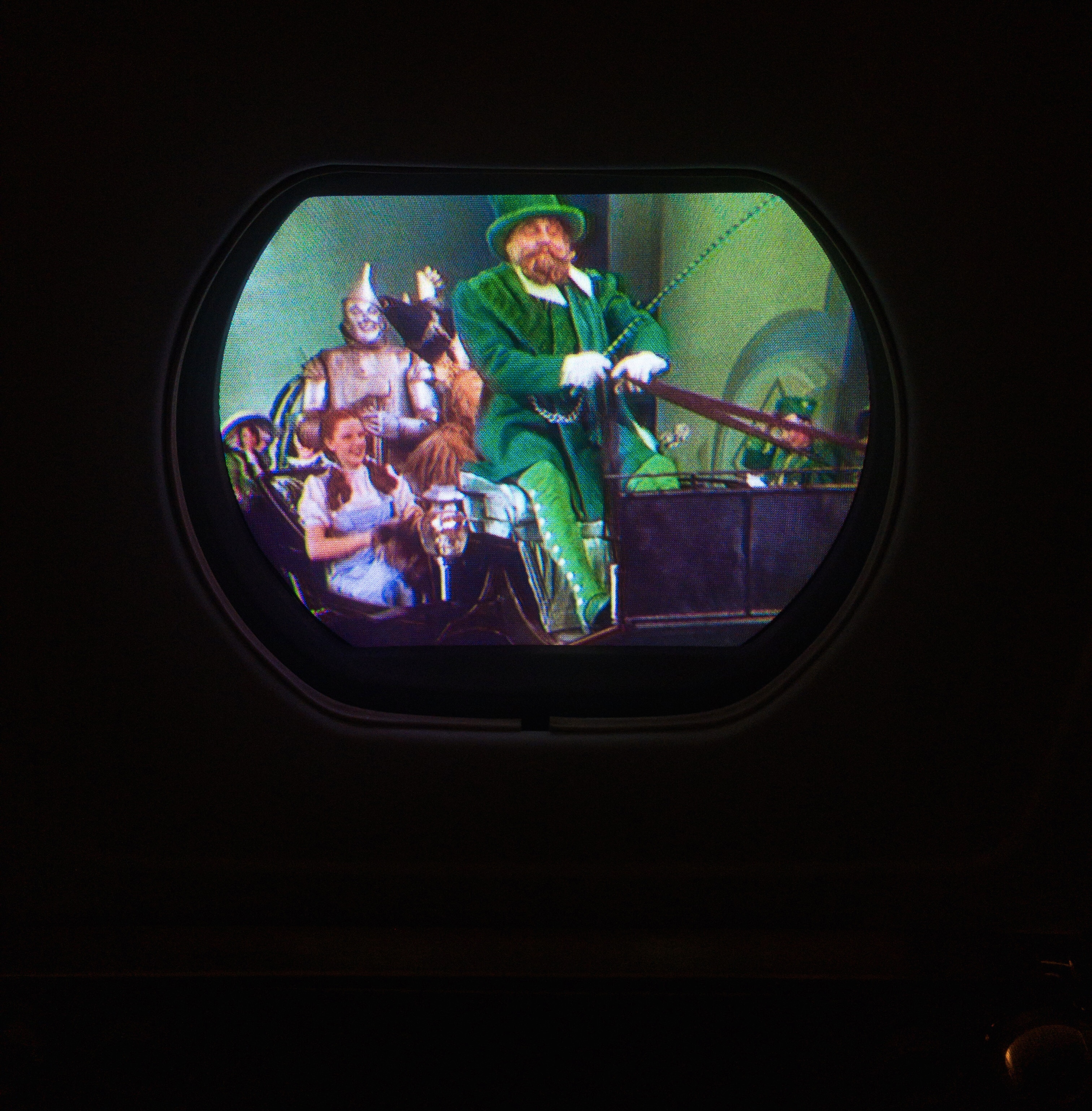

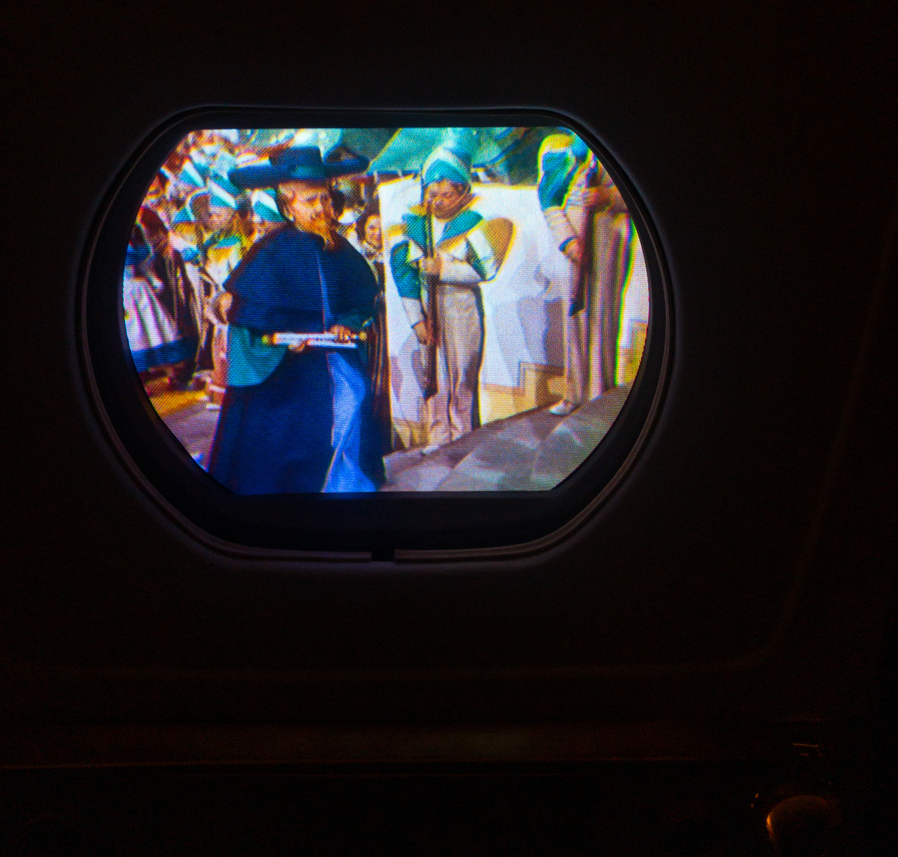

Test five. 15GP22 screenshot processed as a Tiff file. Can we see correct 1954 NTSC colors? Best viewed on a WCG display.
First 4 images are screenshots. If VK prevents Tiff files, the next link after is processed as a JPEG. I see little difference between the two files on my WCG P3 display.
Un-edited Tiff loaded into Affinity Photo editor. Blue noise in the background. The 15GP22 is much brighter. For some reason Tiff files look bad prior to editing.
