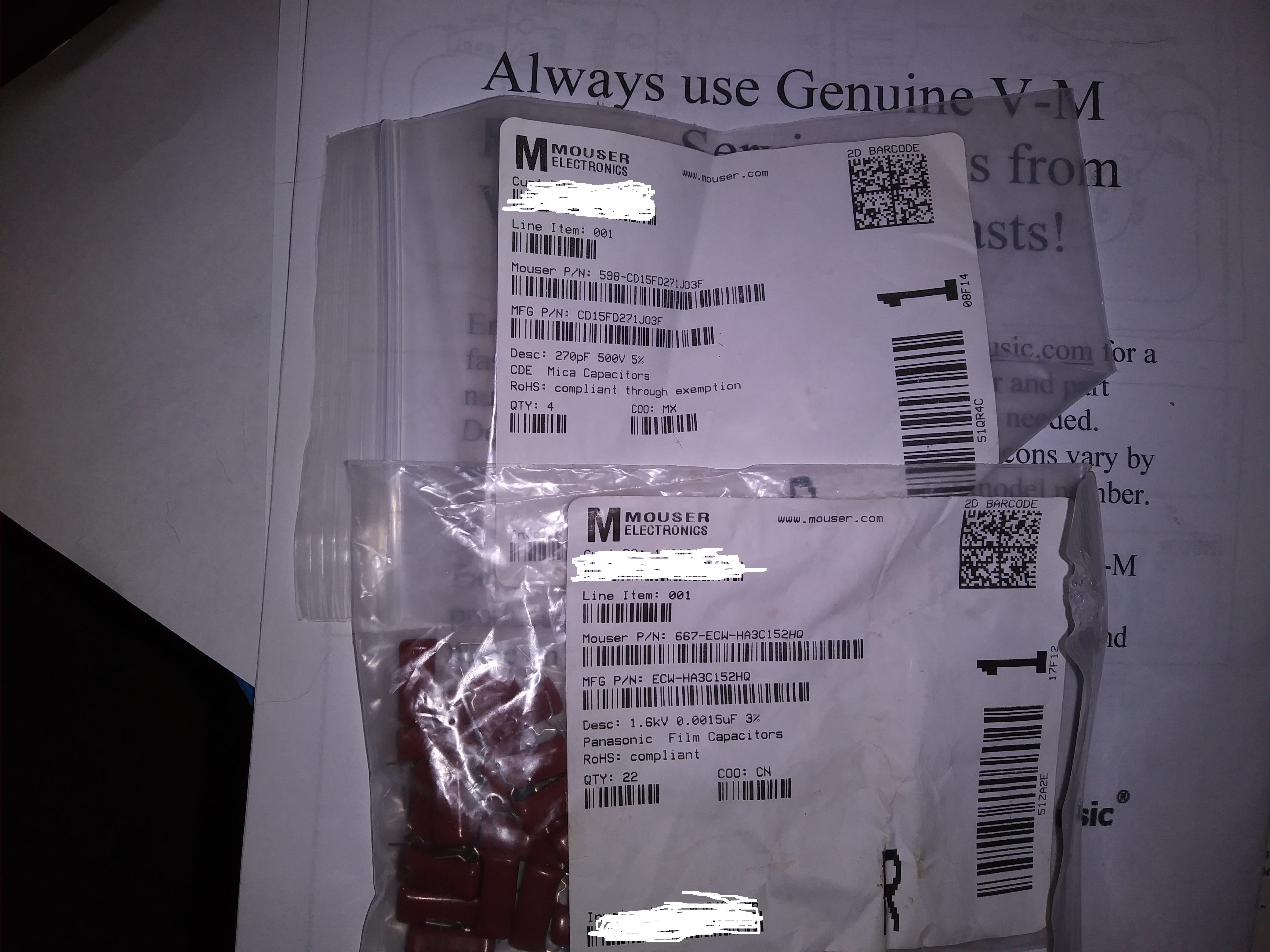

http://suzaku.live-evil.org/0624241853.jpg
yop. I still have the caps.
But I will wait til it gets cooler before I even think about doing it!
