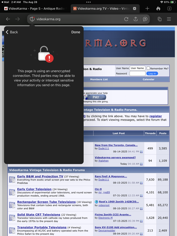

Grumpy: If you haven't already seen the thread on Antique Radio Forums, you have their web site person willing to help solve the issue. See Here: https://antiqueradios.com/p3890629
