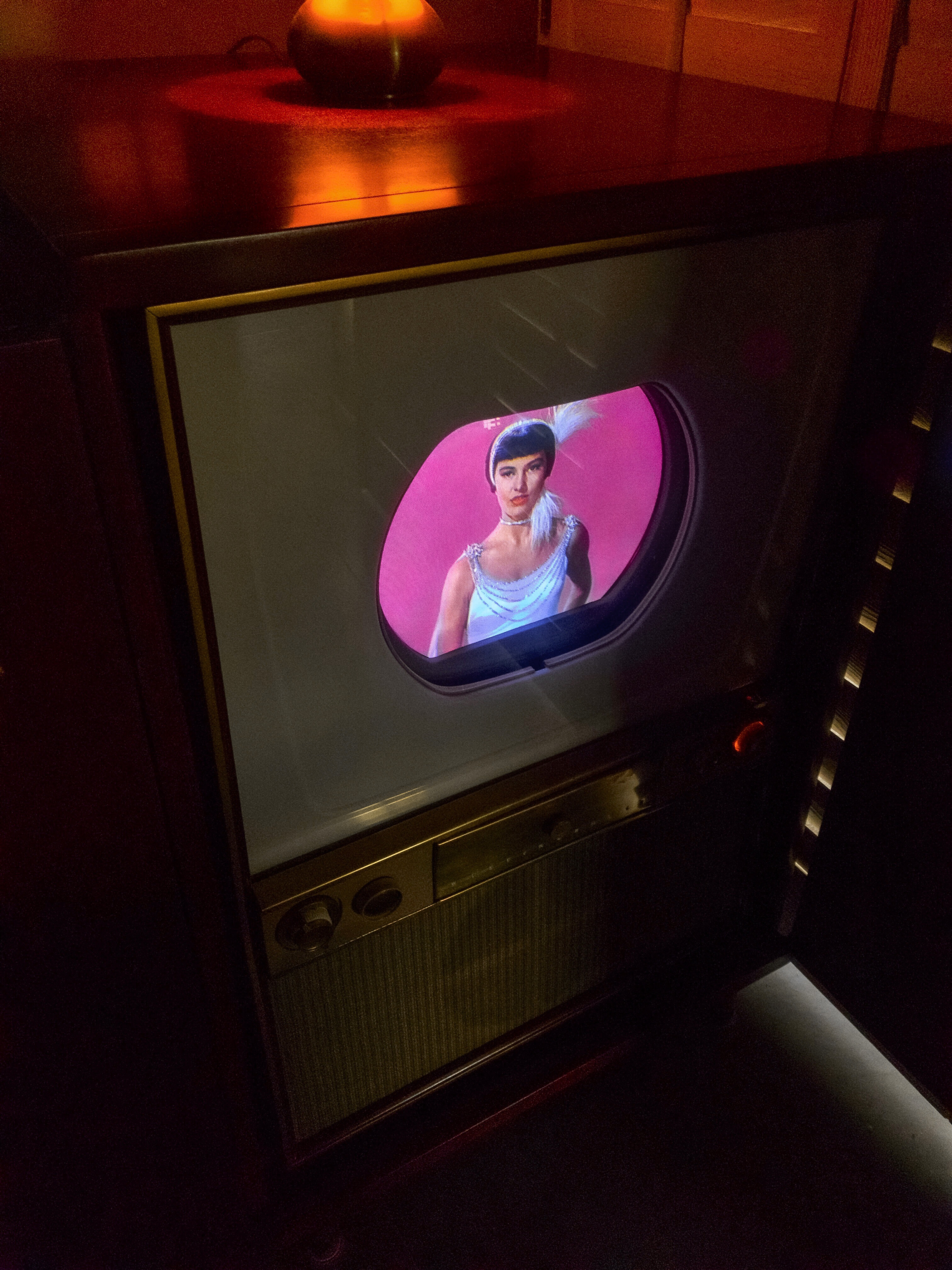

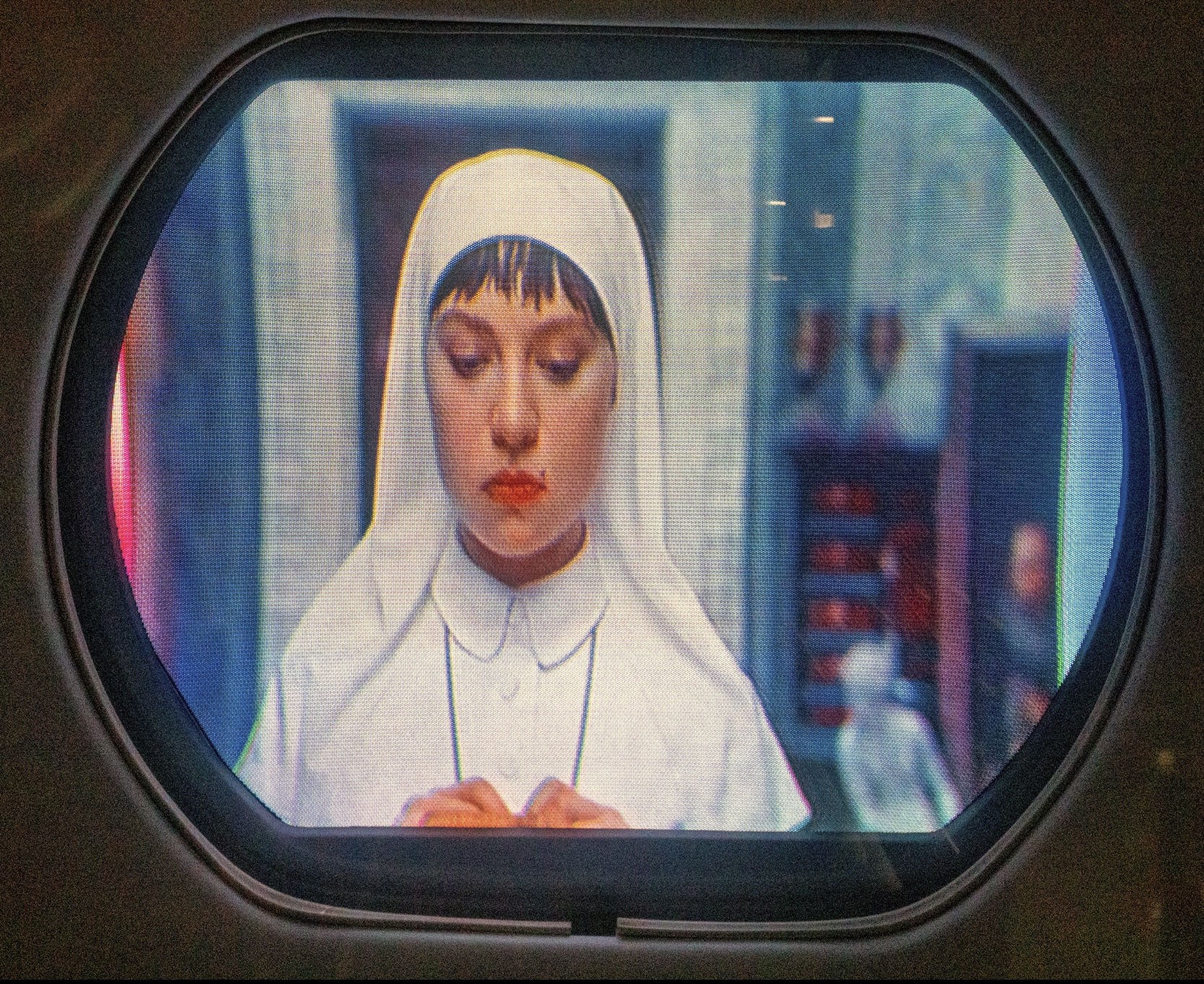

UPDATE:
First: I’m glad to see VideoKarma back up and running.
Posted September 22, 2025
Six Years.
Another year has passed since the completion of restoration of our Westinghouse H840CK15, six years ago on September 29, 2019. I want to take this opportunity once again and thank Mike Doyle who restored the chassis with recap, alignment, parts repair and replacement while I restored the cabinet. Mike also replaced the flaking aguadag coating over the 15GP22 CRT. The Westinghouse is holding steady with strong, stable performance. I don’t have much new to report since last year, so at this time will post the below screenshots photographed the last few days for judgement on the performance.

Old 09-22-2025, 08:06 PM
Posts: 7,704
Nice! Thanks

Old 09-22-2025, 09:19 PM
Posts: 5,863
Stunning! I have incredible respect for those who created these sets with what was available to them in 1954. Nothing else that you could buy for your home could have been so advanced. And, here we are today, over 70 years out, and we can still just sit and wonder at what they did.

  #643
Old 12-09-2025, 11:21 AM
Videotechie Videotechie is offline
Join Date: Jun 2022
Posts: 51
Glad to hear this set is somewhat reliable without constant attention as early rca sets many which do. Zenith roundies are solid performers also..
  #644
Old 12-09-2025, 11:52 AM
Posts: 1,620
No doubt about it, I’m being cautious with the set. The tuner does not drift, but it takes about 5-7 minutes for the hue to reach proper value. Westinghouse located the hue control in the back of the set! What were they thinking? Did they think they developed a drift free hue control?! I managed to squeeze 5 console colors sets along the back wall in my media room, so it’s a tight fit and a big deal to move the Westy to access the hue control. Initially on first setup, we waited for the colors to stabilize, then made final adjustments. Fortunately its working out.
