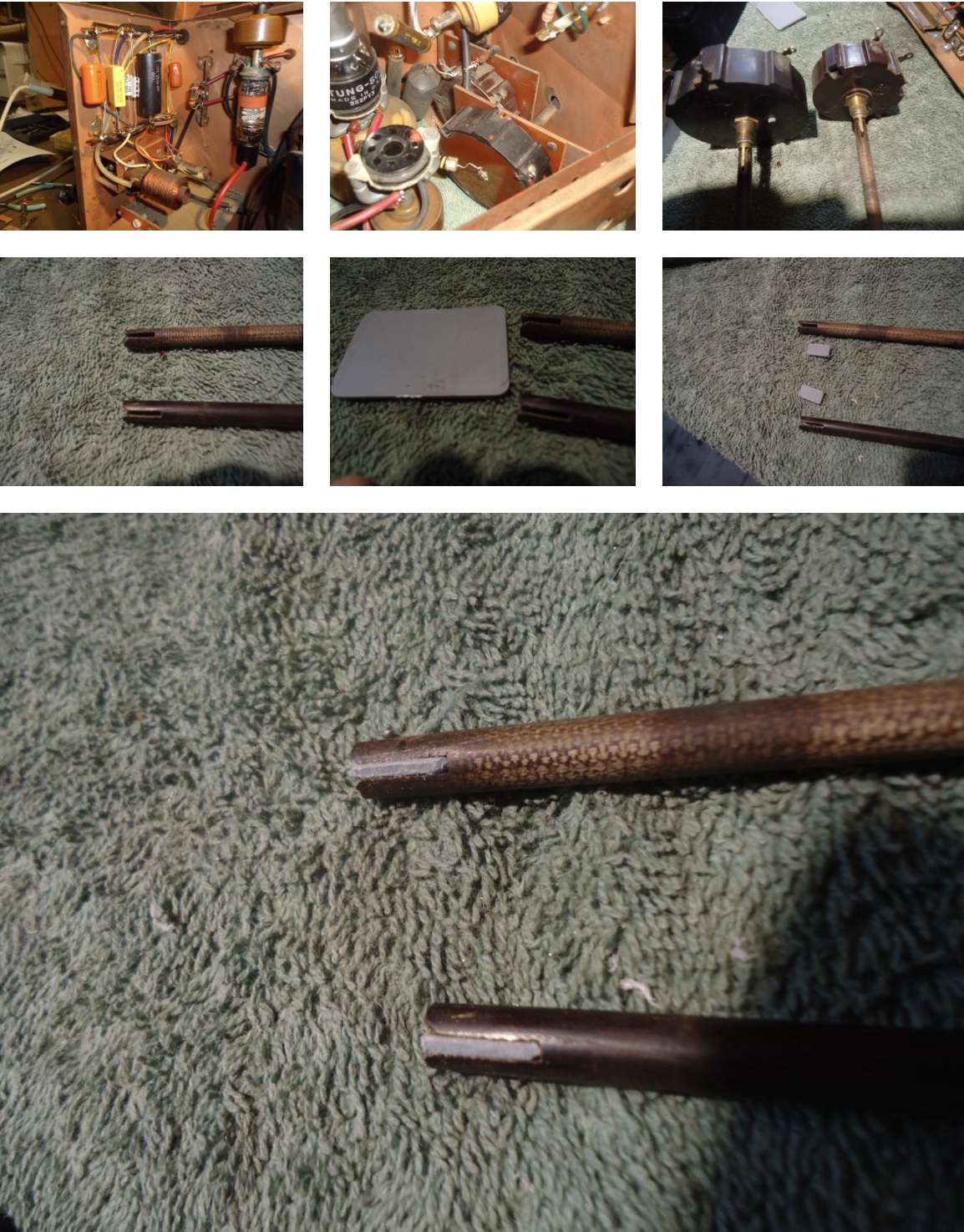

Preparing for the new pots
Update February 26, 2019
From Mike: UPDATE, FEBRUARY 26, 2019, DAY 210.
“Greetings. I will be moving forward on a plan to install a new Focus pot and a new Convergence pot into the High Voltage cage. My exact plan is not yet in place, but it is close. The following pictures show preliminary steps for the process.
Pix. 1 New caps installed in high voltage cage.
Pix. 2 The old Focus and Convergence pots before removal.
Pix. 3 The old shaft drive system using slots in the fiberglass shafts where they mate with the old pot shafts.
Pix. 4 The slotted shafts that will need to be fitted with shims so that they will mate with the new pots later.
Pix. 5 The shafts with a piece of PVC sheet stock that will be used to make the shims.
Pix. 6 Shafts and new shims.
Pix. 7 Shims installed.
Cheers, Mike”

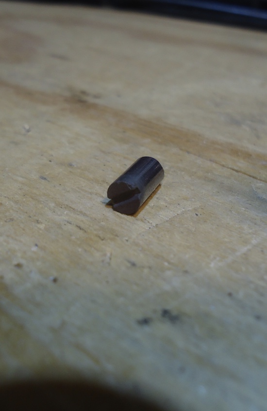

UPDATE, MARCH 6, 2019, DAY 218 FROM MIKE
Greetings. While I am waiting for more parts for the high voltage cage rebuild, I have taken a step back in order to repair the Burst Amp coil that I previously reported to be broken. I found the iron core in the bottom of the cabinet when I removed the chassis a few months ago. I later learned where the core came from. The powdered iron core was mostly intact and all that was needed was JB Weld Epoxy, and then fine sanding in order to restore its original cylindrical shape. The JB weld worked equally as well on the coil form repair.
Pict. #1 Broken coil assembly
Pict #2 Broken core and bent lead screw
Pict #3 Broken coil form
Pict #4 Repaired and straightened iron core and coil.
Pict #5 The finished coil re-assembled and ready to install in to the chassis
The high voltage cage rebuild will be completed next.
Cheers, Mike
