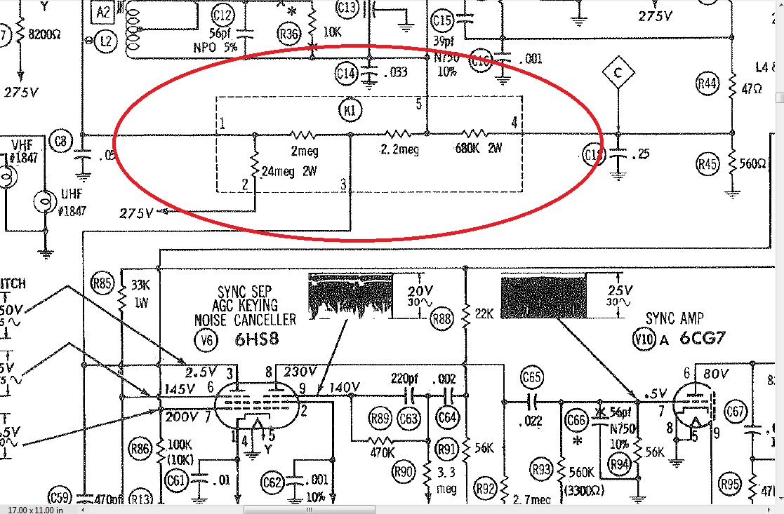

Old 09-09-2022, 09:18 AM
Posts: 3,697
I believe I changed those 3 caps already but m1 is a fuse wire if that’s bad then no power to the set.
  #298
Old 09-09-2022, 09:26 AM
Posts: 3,161
that should have been K1, the couplet for AGC, I saw it wrong, the schematic is a bit fuzzy. :/

Where did you see k1 I can’t find it.
  #300
Old 09-09-2022, 09:49 AM
Posts: 3,161
http://suzaku.live-evil.org/k1.jpg
it can be located via page 6 on the SAMs, left side 1/2 way down,
