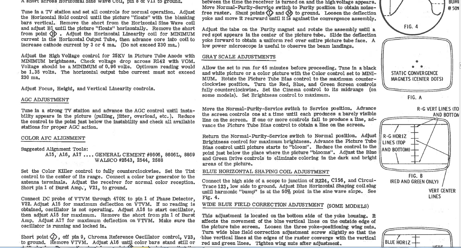

The greyscale setup in the SAMS is a bit odd, of diff from what I have seen before, this may be cause it's a set with a POT for bias and not a switch.
but that last step of turning it up till it blooms, then backing off, seems a bit odd to me. :O
http://suzaku.live-evil.org/greyscale.jpg
