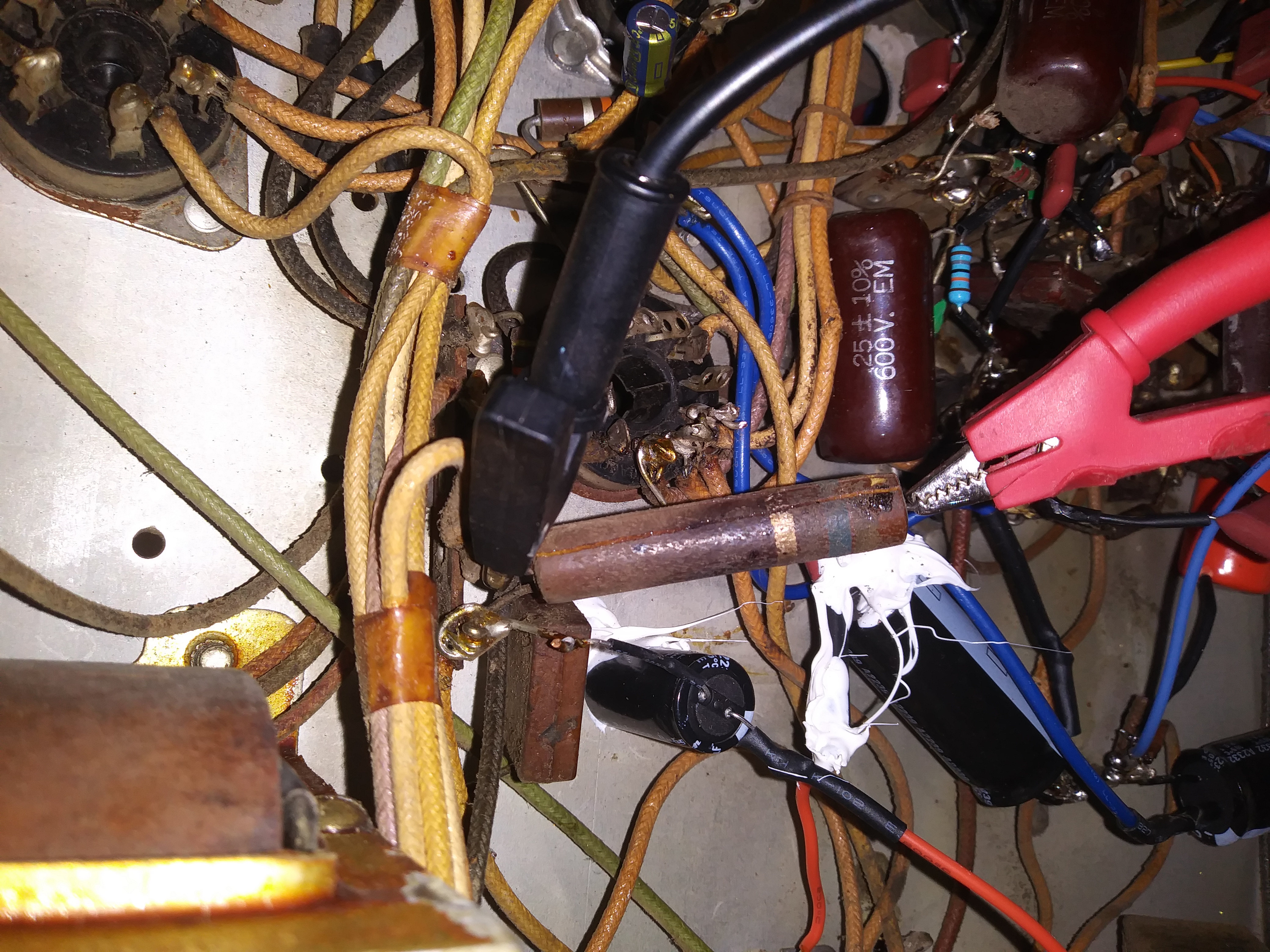

I did have a burnout when I did the raster test this weekend, the pair of resistors I had in for R255( 1.5m) overloaded and went up in smoke.
Seems I exceeded the voltage rating of the part and they could not take it, parts list just says HV resistor, no power rating, have 3 1w ones in there and they are holding, but getting quite warm.
Finding the right HV resistor in the right range is proving to be tricky, so I intend to something a bit silly ( overkill ), not silly if it works, right?
I'm getting a bunch of 300k 3w resistors, hook 5 in series, for 1.5m, since I'm not sure of the voltage or power rating of the original part, I'm sure this replacement string will far exceed the original part, and not fry again!

no short, it's just under a lot of HV stress, and I first tried to replace it with 2 1w normal resistors, and they could not take the voltage across them.
http://suzaku.live-evil.org/maggy-solved.jpg R225
There is a lot of HV across it, so 5 normal resistors should do, as 3 seem to be OK, but a bit warm.

How much hv are you taking about ? So your putting in the equivalent to 5 watts, is this anode or focus voltage 5 watts seem like a lot of wattage to keep something happy. What did the old one look like as far as wattage. And the schematic didn’t show that resistor that was in there ?

I assume there is 5,000 VAC or more across that resistor.
Standard resistor voltage ratings are as follows
1/2W = 350v
1W = 500v
2W = 750V
5 normal resistors is not enough voltage rating.
I suggest using Vishay VR68 resistors. 10,000 volt rated 1W.
1/2W = 350v
1W = 500v
2W = 750V
TKS, That is what I was looking for, but was unable to find in all of the types they have to order.
On the way from Mouser.
VR68000001504JAC00
As always the shipping costs more than the part.
"What did the old one look like as far as wattage. And the schematic didn’t show that resistor that was in there ? "
The old one looked like a 50s-60s 1w part, but the bands were dark and not readable, tested at about 1m, schematic says 1.5, parts list only says (1.5m HV resistor 1w).

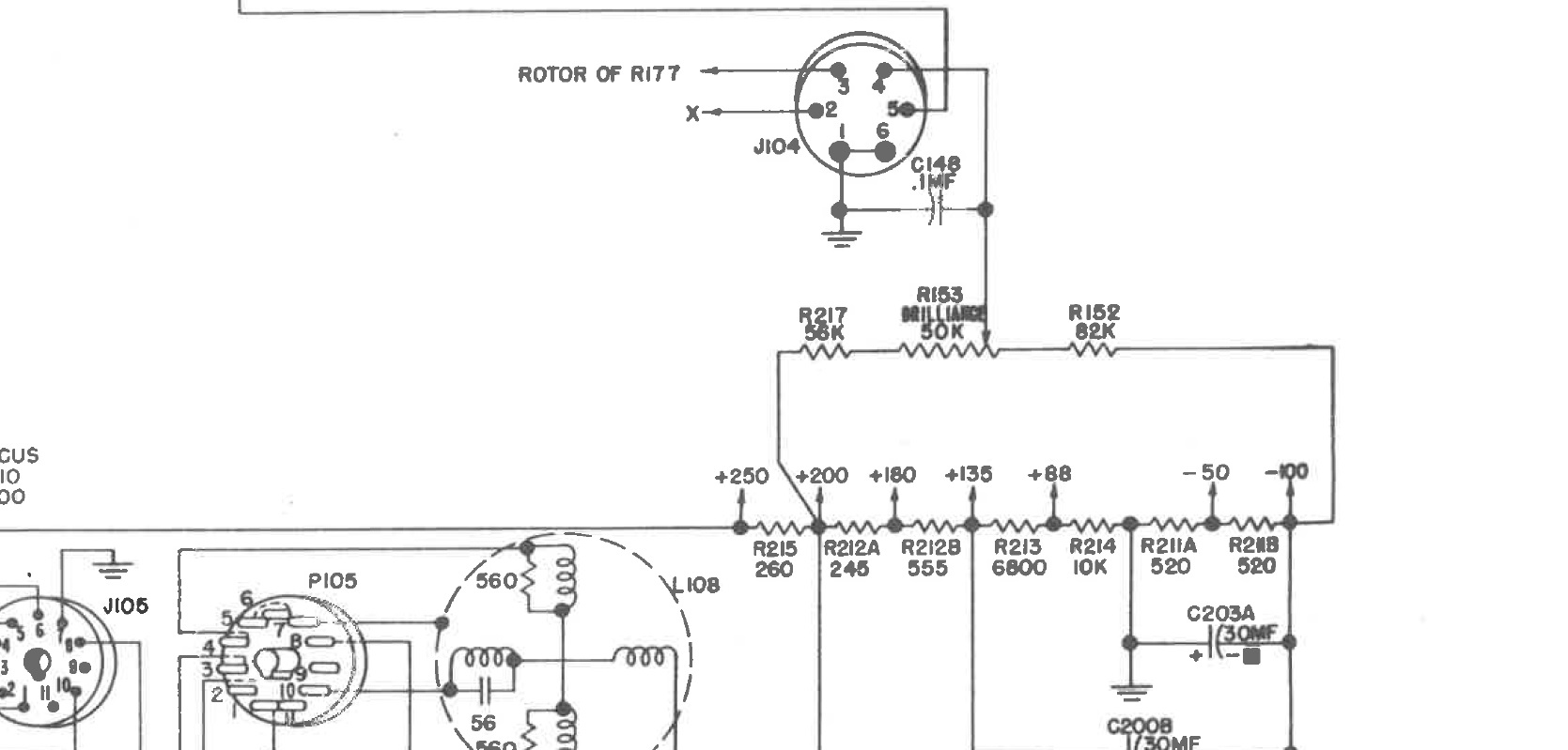

http://suzaku.live-evil.org/maggie-bright.jpg
R217 is at 93k and 152 is 70k both gotta go,
the pot is OK
at first I thought it may be the 8YP4 not liking the setup, but with the bad resistors, it's being driven full on.
new tubes due today, so says USPS
And if i hear nothing negative about it, will order the new focus pot Monday $27 OUCH!

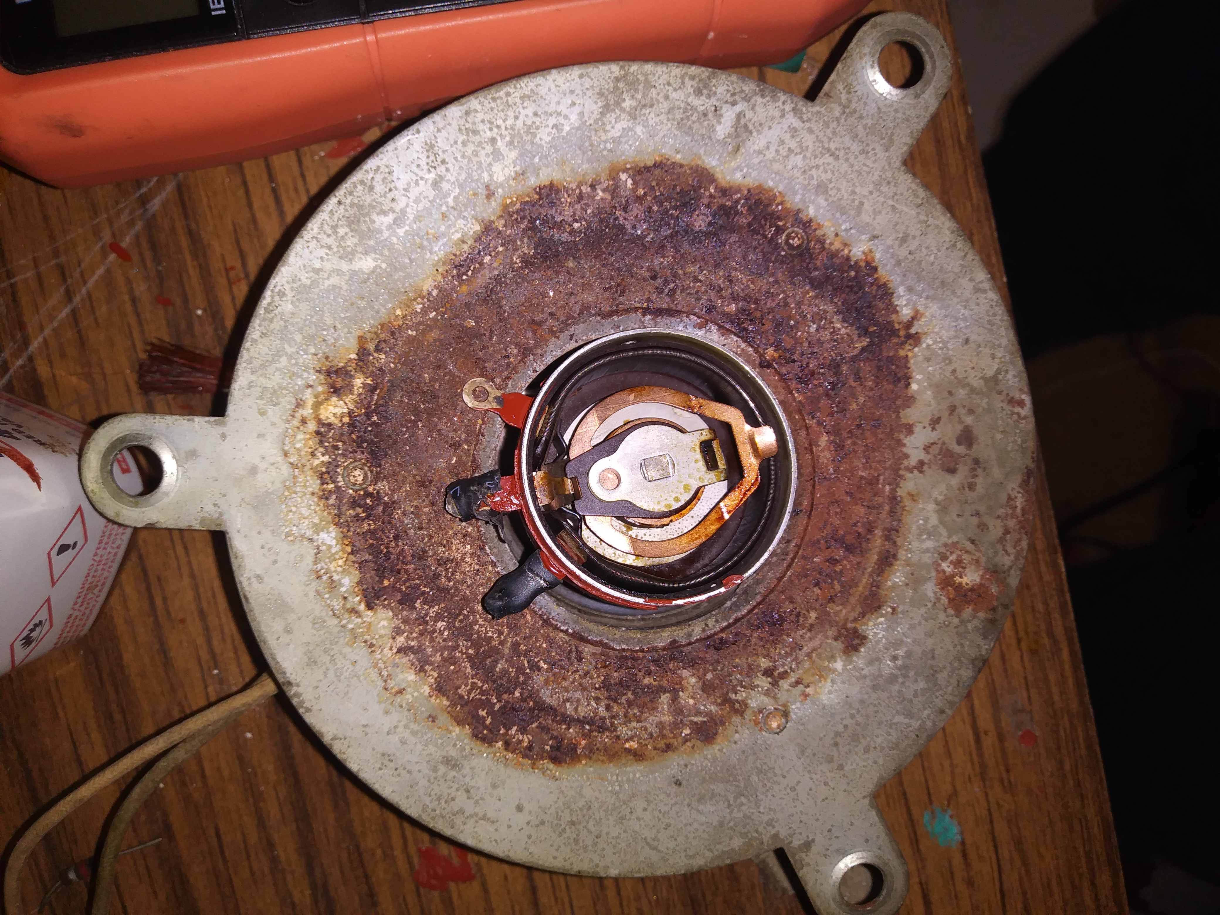

the failed Focus pot, and a very rusty focus coil that still checks OK that i WON'T soak in evapo rust! TEASE! TEASE!
the isolation of the pot has arced trough and can't be fixed.
http://suzaku.live-evil.org/0412251716.jpg
as for the focus coil. it seems OK, but very rusty when i removed it from the yoke, i found the same that many others have found, that the plastic parts have turned to dust,
