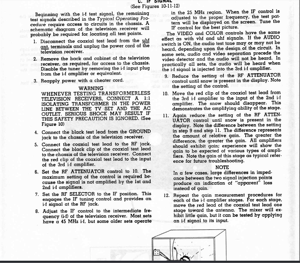

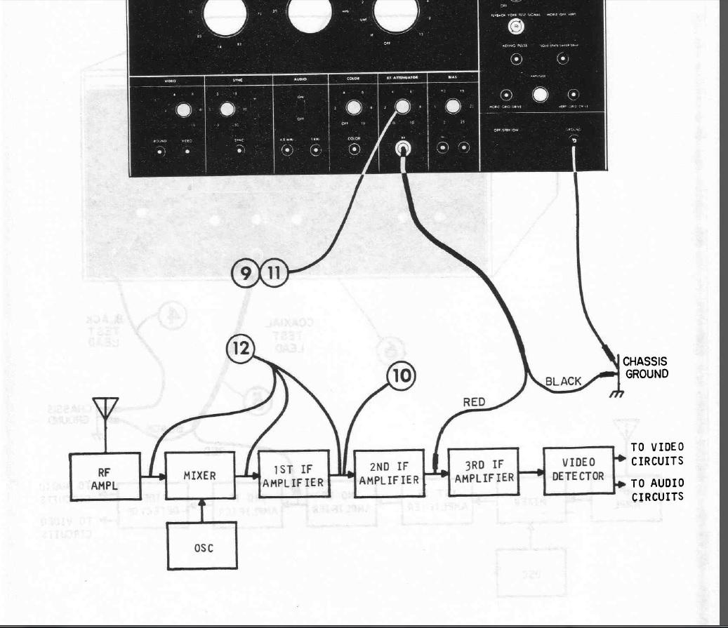

this is taken from the b&k precision 1077b television analyst manual, it's for the most part what you are doing to debug the IF
http://suzaku.live-evil.org/if-111.jpg
http://suzaku.live-evil.org/if-222.jpg
