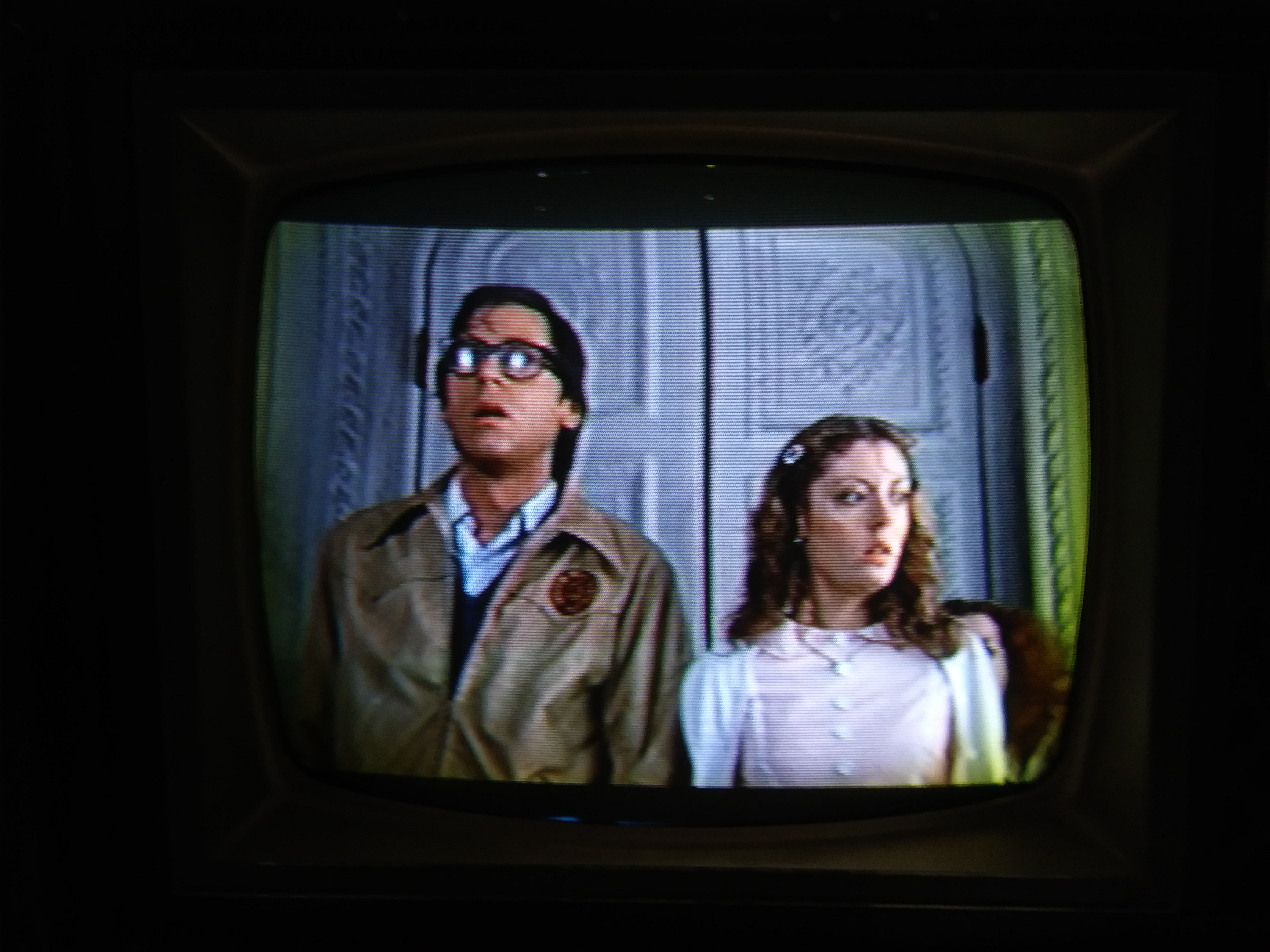

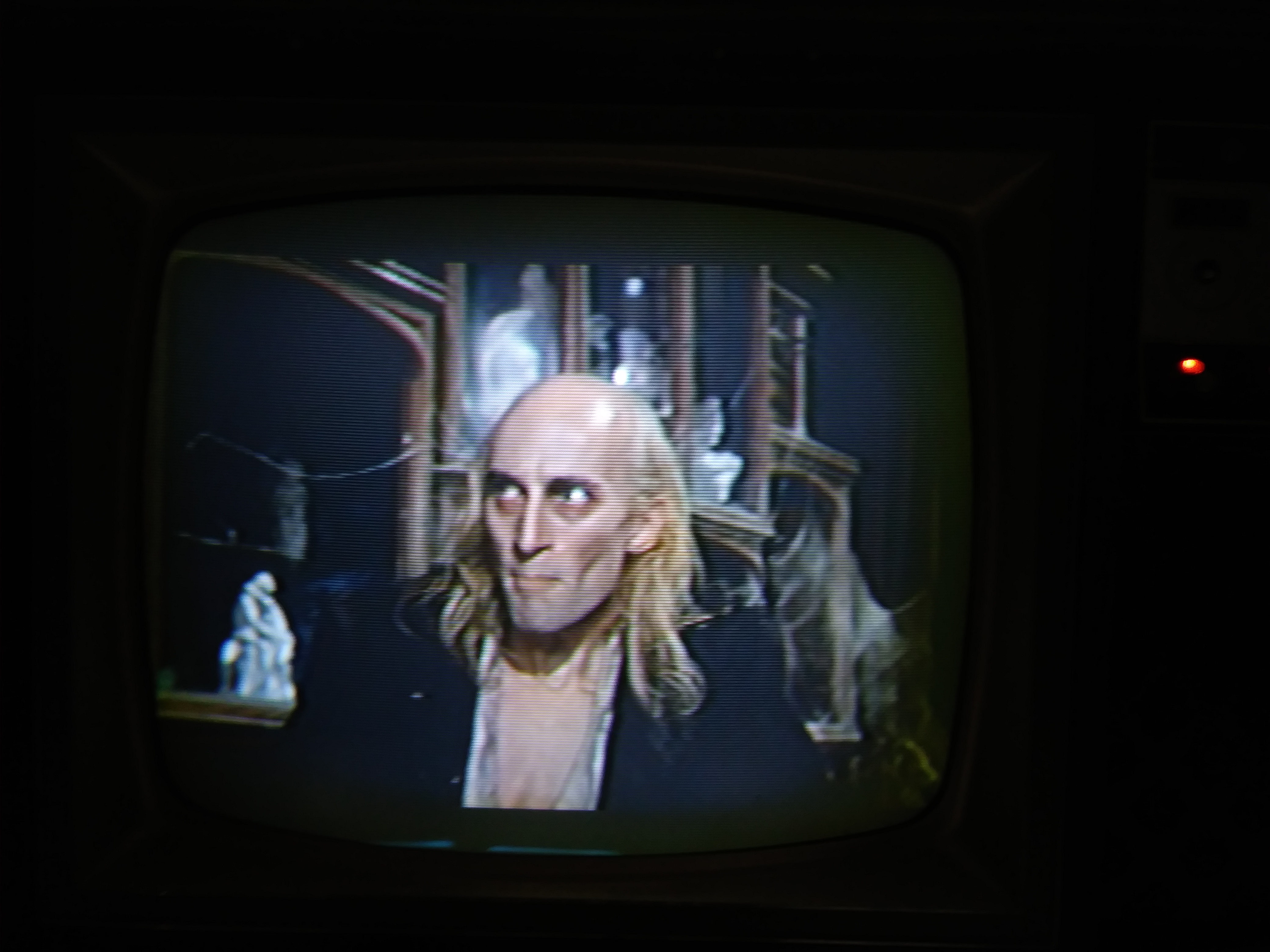

Old 08-23-2022, 08:45 PM
Posts: 3,161
more pix
http://suzaku.live-evil.org/rocky-1.jpg
http://suzaku.live-evil.org/rocky-2.jpg
http://suzaku.live-evil.org/rocky-3.jpg
this time a pro made DVD. :O
  #116
Old 08-23-2022, 09:05 PM
Posts: 7,704
I'd say the green edges add something special to that show.
  #117
Old 08-23-2022, 09:14 PM
Posts: 3,161
I know , but as mentioned above, I don't wanna risk the weak repair on pin 12 by removing the CRT + Cataract removal unless I have another tube to fall back on. :/
If it was not for that broken pin, I would have fixed the green gunk by now.
