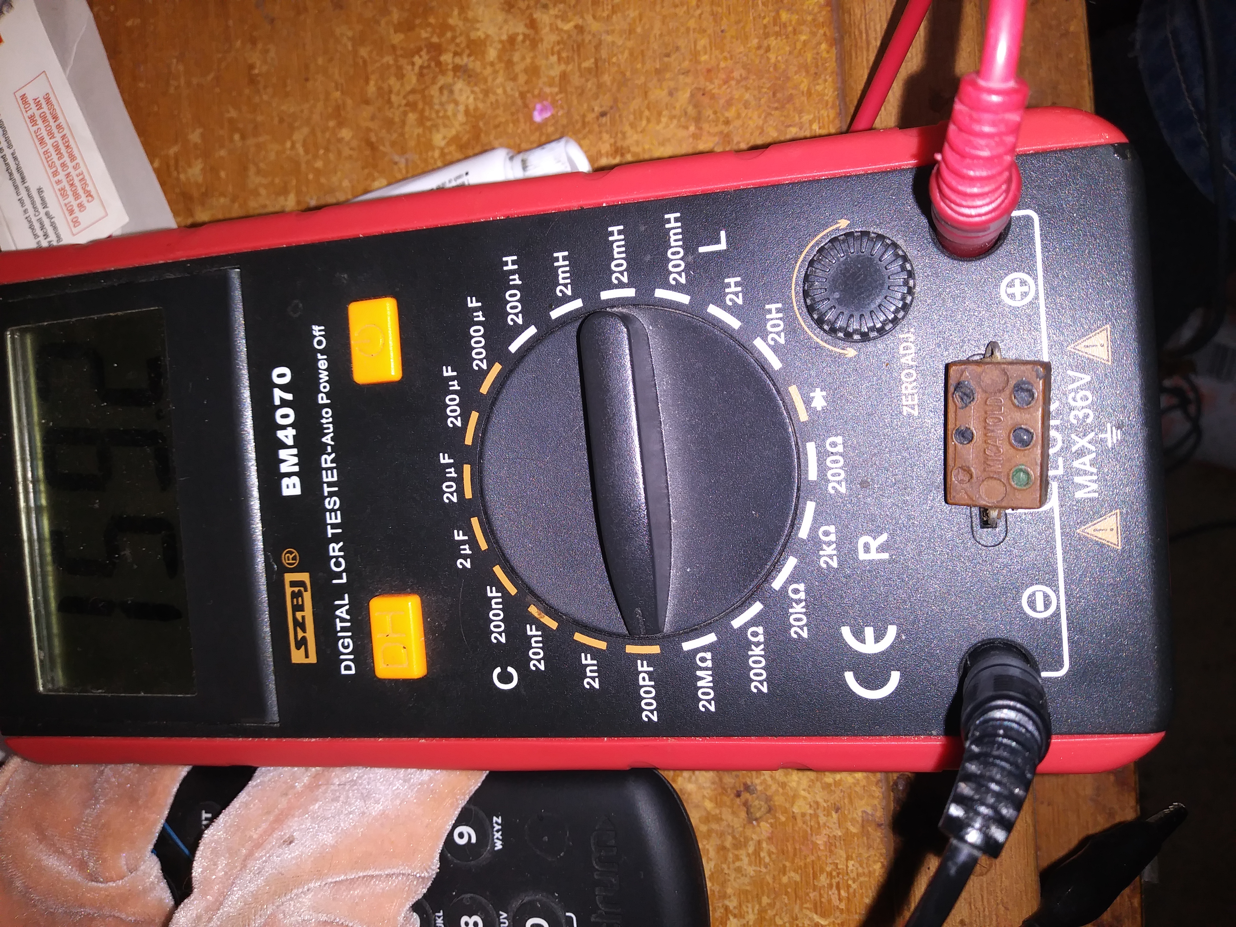

  #239
Old 06-25-2025, 09:32 PM
Posts: 3,160
sorry to be asking for help with these, but the dots just don;t make sense, and there is no standard like the resistors
the schematic SAYS this should be 100pf, but it is testing as 160, so the docs are wrong, or the part is really bad!
http://suzaku.live-evil.org/0625252105.jpg
If it's bad that would explain the poor sync! do the dots say 100 pf?
  #240
Old 06-25-2025, 09:56 PM
Posts: 8,777
Yes, 100pF rated for 500 volts.
brown - black - black = 100pF
