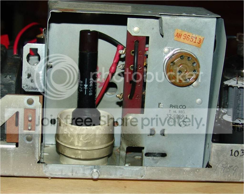

I could use some advise from the group, please. While go over the chassis of my Debutante (10L43 chassis), I found a solid state rectifier installed (ECG508).
Now I am stuck. I can't decide whether to leave it and work with this modification, or to remove it and go back to a 1G3GT tube rectifier.
What would you do?

Wow-that is a real oddball. Really unusual considering the tube that thing is replacing is a component that rarely fails. If it were mine, I would drop in a 1B3, since the diode that is in now is pretty old. 1B3s are plentiful and cheap.

That's what I was thinking as well. But looking at the scorching on the socket and cage made me wonder if that had something to do with the mod being added in the first place. I've noticed a couple of other strange rigs on the main board as well, that may or may not be related to this gizmo.
All I knew for sure was that I immediately and instinctively did not like this solid state device intruding inside my television.

An ECG-508 is a 3A3 replacement, but should work fine in there. Only thing is, it might cause more high voltage since a silicon diode is more efficient than the tube. When you convert a B+ supply from a 5U4 to a solid state bridge rectifier, you have to change the value of the main B+ resistor(s), and preferably install a delayed startup relay to allow the other tubes to warm up before giving B+. If not, there's an unloaded surge that can blast the capacitors. That should not be a problem here with the stick diode in the Predicta because the flyback will still run up slowly with the horizontal oscillator. But you probably will have a couple KV extra HV.

So you don't think extra KV will cause a problem?

Make sure you have a filament supply for the 1G3 - it looks like it's been removed - it should enter the HV cup from the same side as the 2nd Anode lead exits.

I assume you mean IF I go back to using the 1G3, right?
Although, I've decided to see what kind of KV I'll get out of the stick diode. If the voltages are acceptable, I think I'm going to just leave it.
