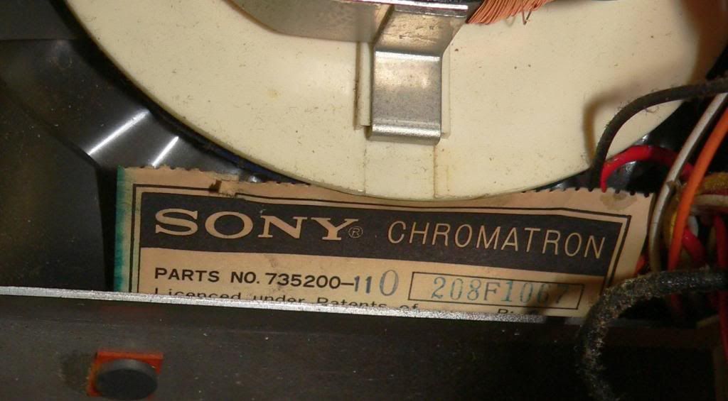

This is a image of the label attached to the Sony KV 7010U CRT.
The portion blocked out reads "Licensed under Patents of Paramount Pictures Corporation" I have another photo showing that and I will try to post additional photos directly to this site.

I would NOT really consider this chromatron a "hybrid set", since only the 2 HV rectifiers are tubes, Many sets in that time period , and even later, were labeled "solid state" but still had a rectifier tube. ALL o0ther ckty. looks to be SS.
Old 07-23-2013, 10:05 PM
Posts: 1,620
The reason I'm calling this a hybrid Chromatron is that we believe it has 3 inline beams within a single gun like the Trinitron, as the original Chromatron used a single beam. It has a fine wire selection grid visually confirmed instead of the aperture grill.
