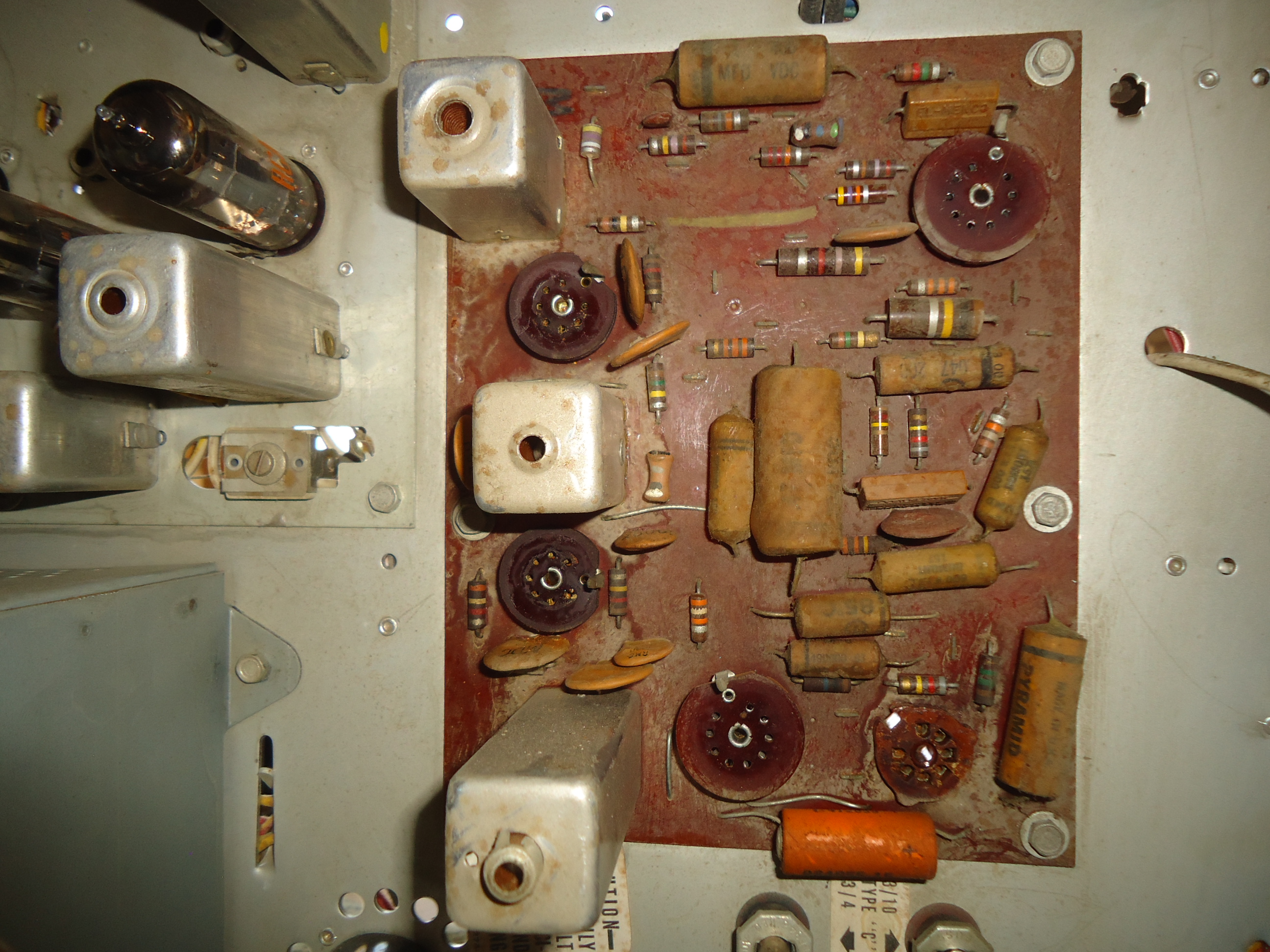

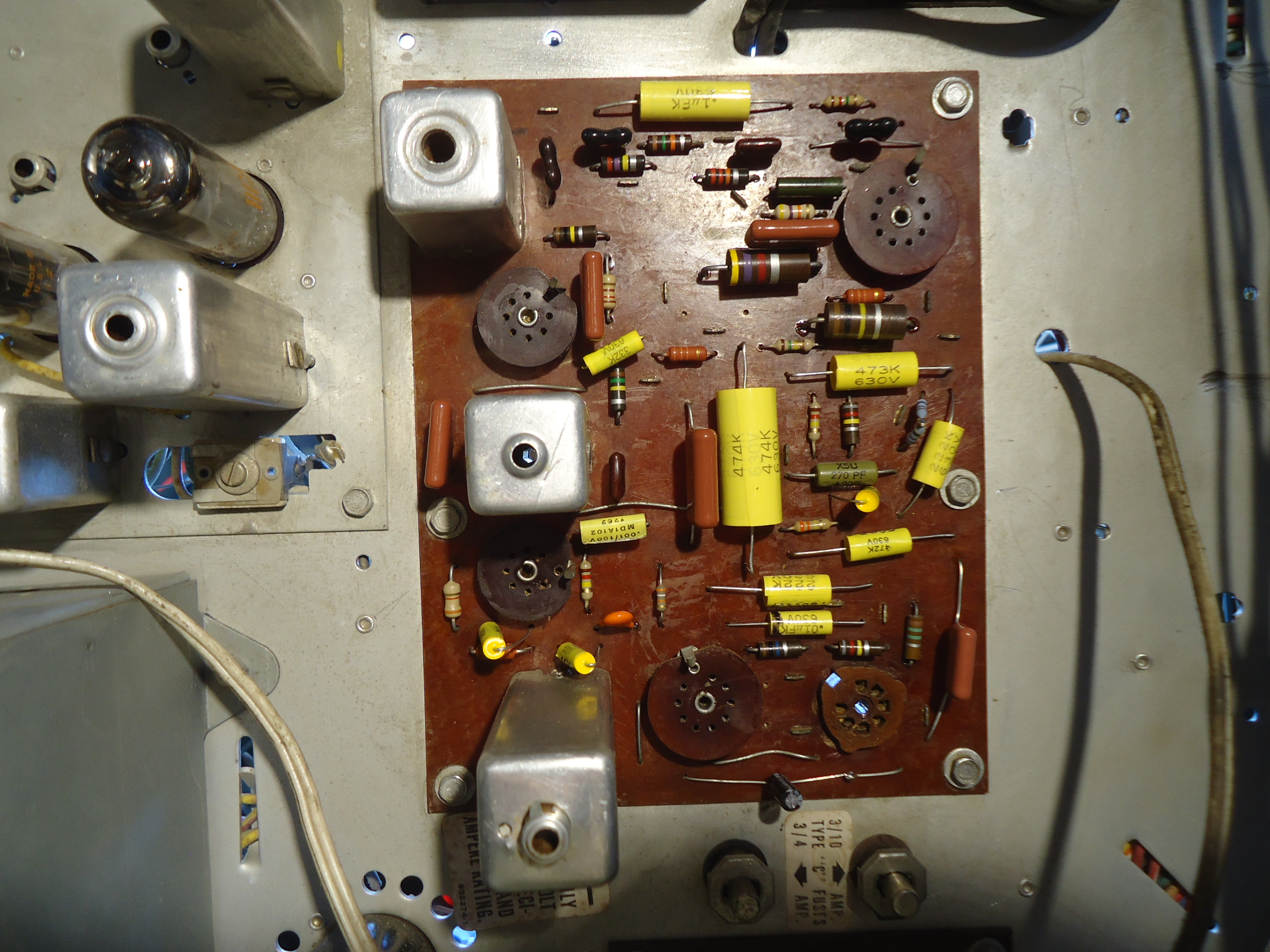

September 25, 2024
Update for AGC, Sync, Audio rebuild
The printed board that controls AGC, some of the Sync and all of the Audio has been completely rebuilt. I replaced all of the components on this board, not just the capacitors. I found some resistors out of tolerance and a number of cold, poor solder joints throughout. This board was no doubt causing multiple intermittent problems for many years, one of which I experienced earlier in this restoration. There was a horizontal sync problem that mysteriously went away. I decided to do a complete component replacement as opposed to looking for intermittent solder connections and/or faulty components. The CTC5 had numerous issues with AGC and most of that is due to the fact that the engineers thought that it was a good idea to create the 140 VDC power source from the cathode of the audio output tube. VERY BAD design to mix any two circuits that way. I do not know why they did not just add a 20 watt resistor to the existing 285 volt supply which would have been a better design. It would have been a very robust design compared to making the audio output tube do the work of making the 140 volt supply which caused many problems that were difficult to troubleshoot.
Pix 1 Board before restoration.
Pix 2 Board after all components changed.
Next, I go to the High Voltage Regulator and make a mod to allow control of the High Voltage setting.
Cheers, Mike

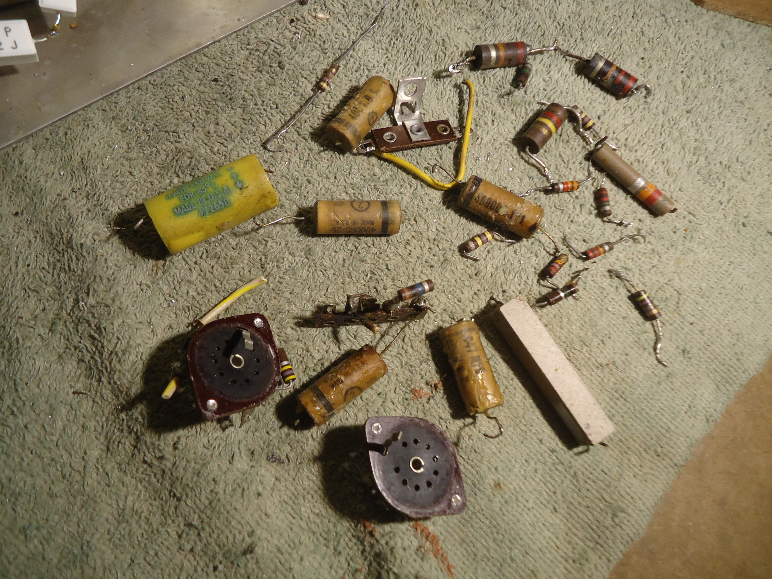

Greetings Marshall. I started looking at the CTC5 again this evening and I will be attacking the H.V. regulation modifications next. The plan is to install a H.V. adjustment control in place of the Matrix Balance control which is located right next to the 6BK4 regulator tube socket. The Matrix Balance control never worked on any CTC5 that I have ever worked on. Every chassis that followed the CTC5 did away with it and replaced it with 470 ohm resistors at the cathodes of the demodulator tubes, and that is what I will do here. The pictures attached are as follows.
Pix 1 The parts that came out of the AGC, SYNC, Audio I.F. board from the last update. I missed sending it at that time.
Pix 2 is the 6BK4 Shunt Regulator socket. Notice the control on the right side with a yellow and blue wire. That is the Matrix Balance control that I will remove. In place of it will go a 10 megohm pot that will allow control of the H.V. regulator. I have already disconnected those wires on the other end where they connected to the demod tubes. Since this modification causes changes in the Chroma circuits, I will be doing the component replacements in that section next instead of moving to the Vertical sweep section. I did a random "in circuit" check of resistors in the Chroma section and there are a number of resistors that are out of tolerance by over 20%. So, that will be a slow task since it is all hand wired. One more note. The H.V. as measured at this point in time before mods is 17 KV. I hope to be able to adjust between 19KV and 22KV if all goes well.
More to come, Stay tuned!
https://visions4netjournal.com/wp-co...SC03198-1.jpeg
https://visions4netjournal.com/wp-co...SC03197-1.jpeg

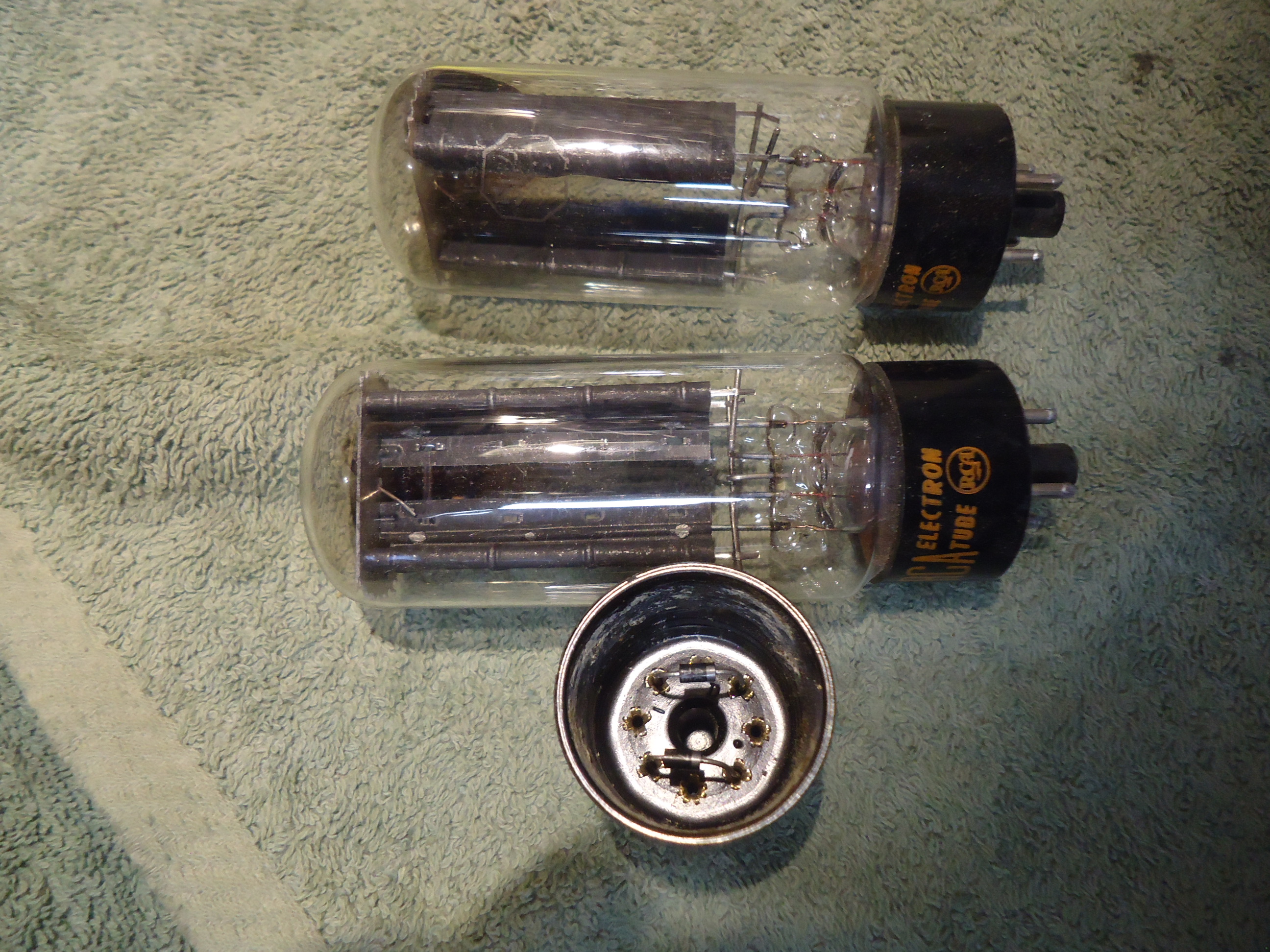

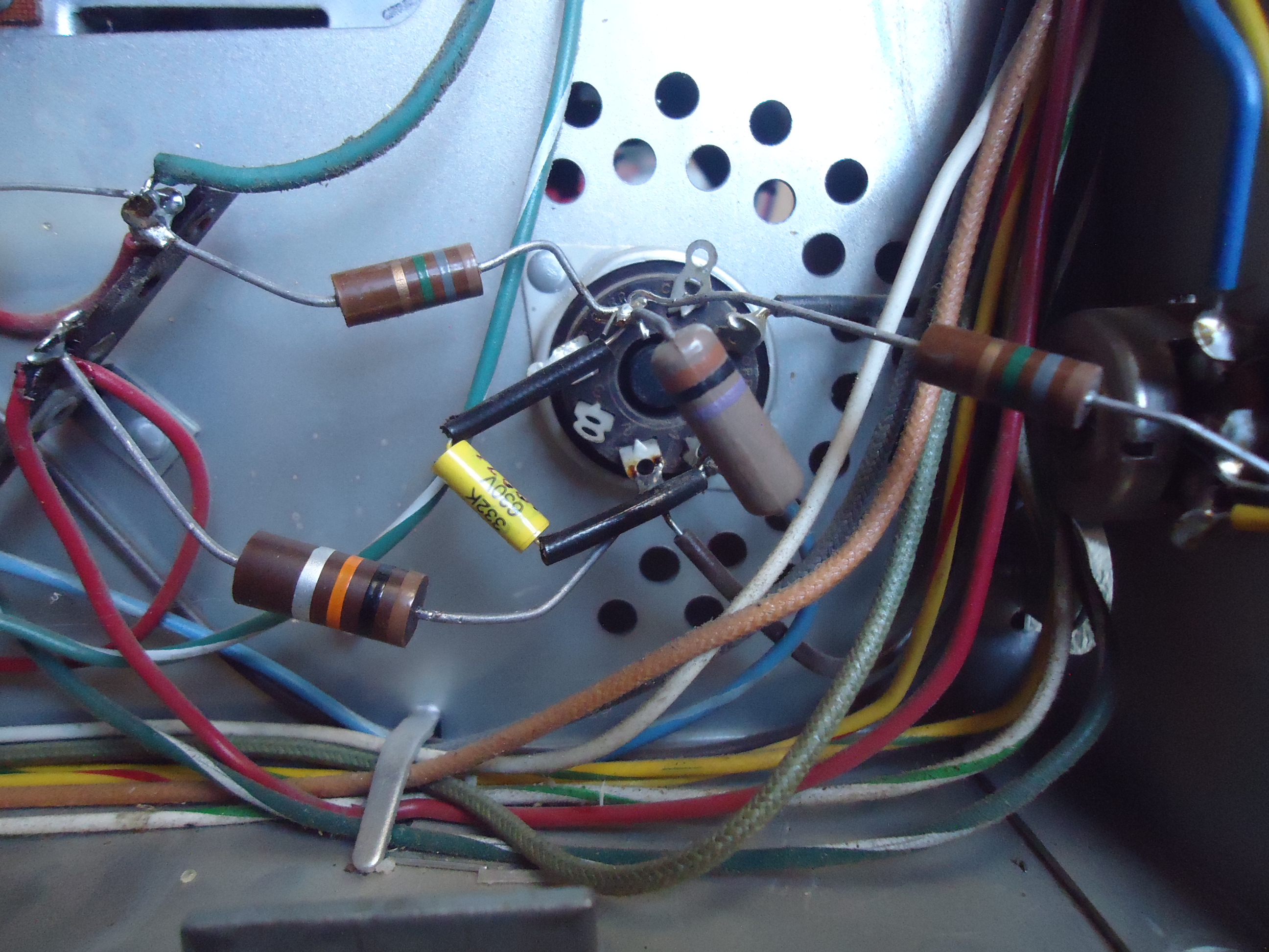

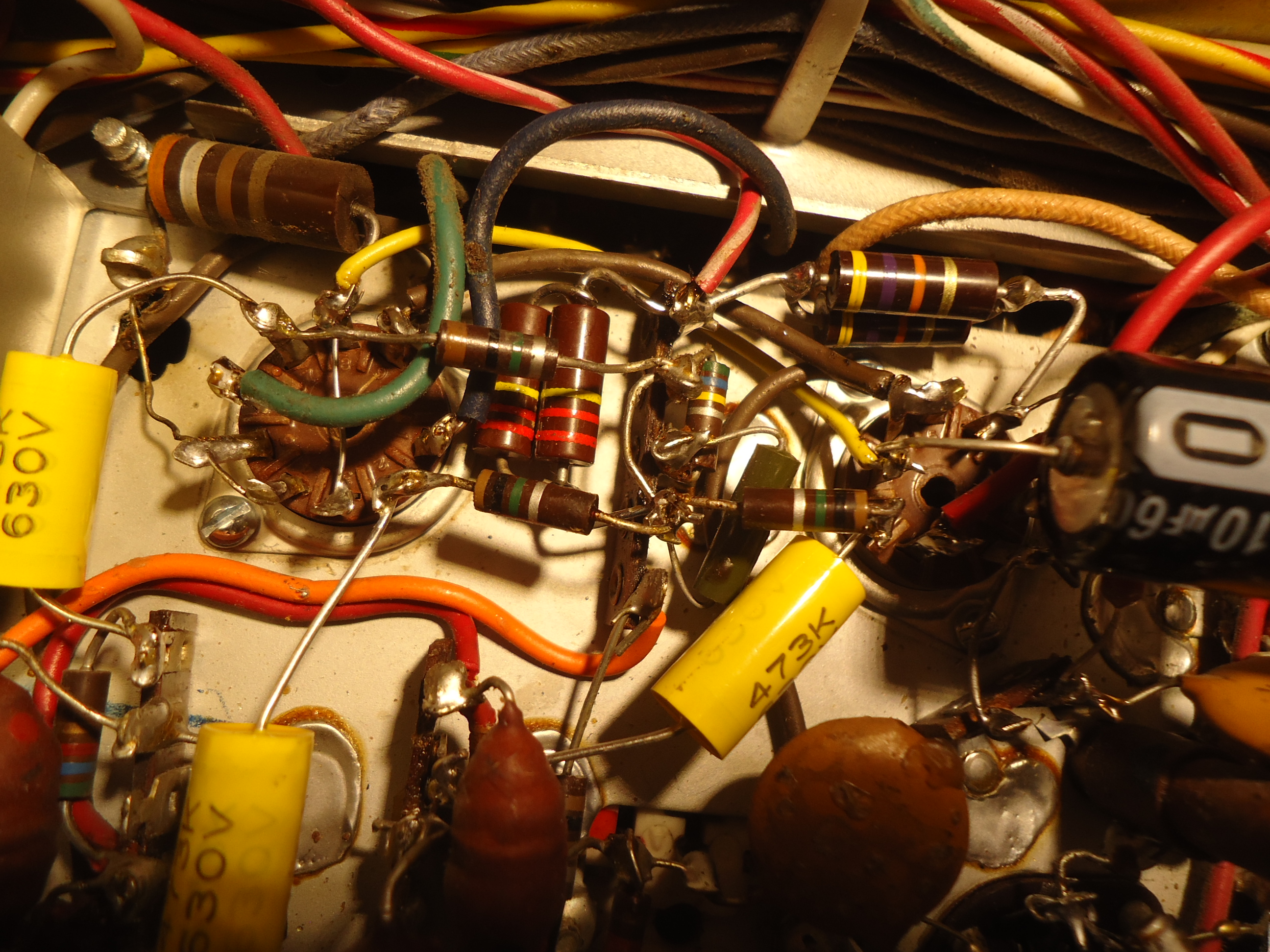

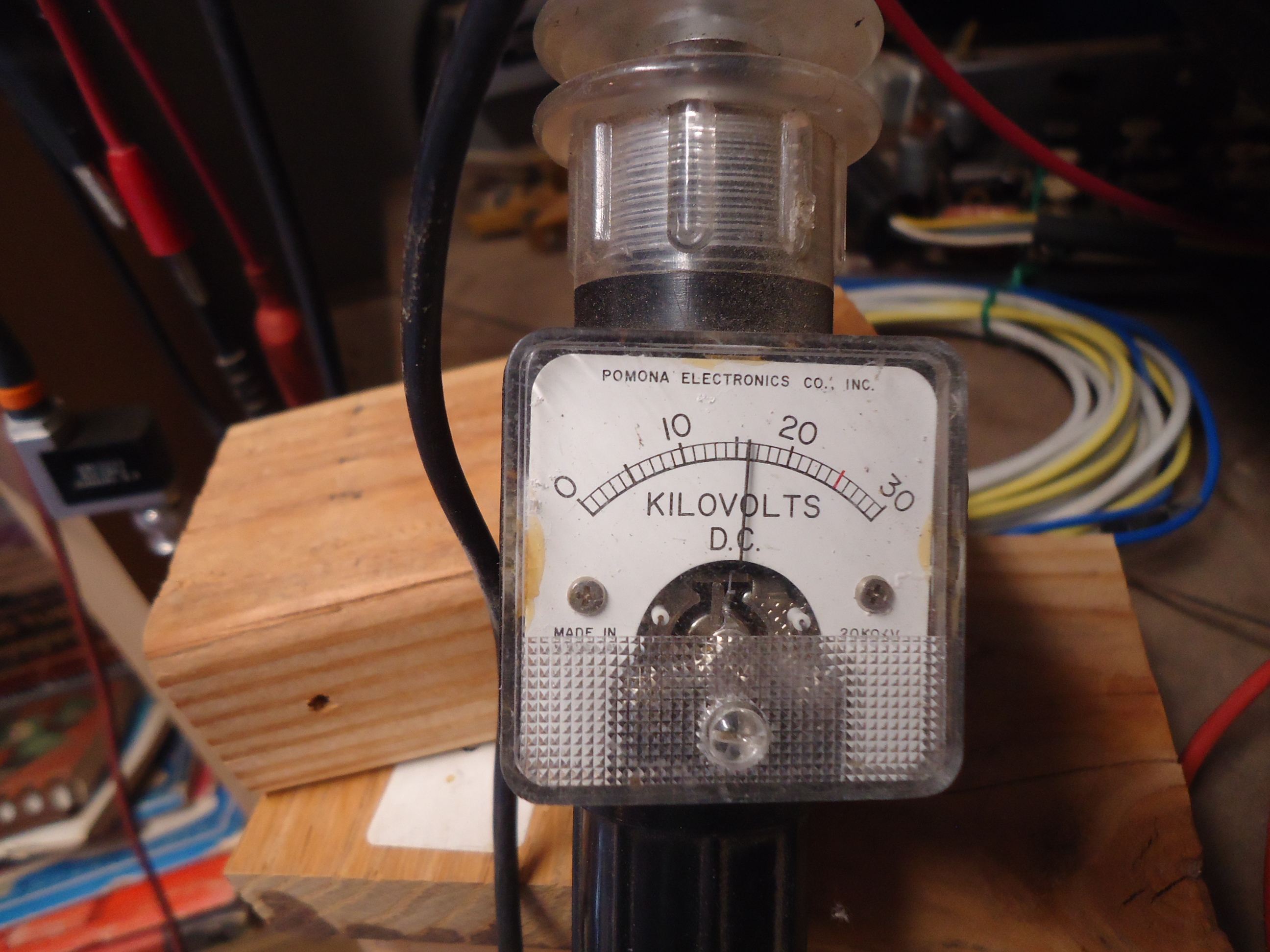

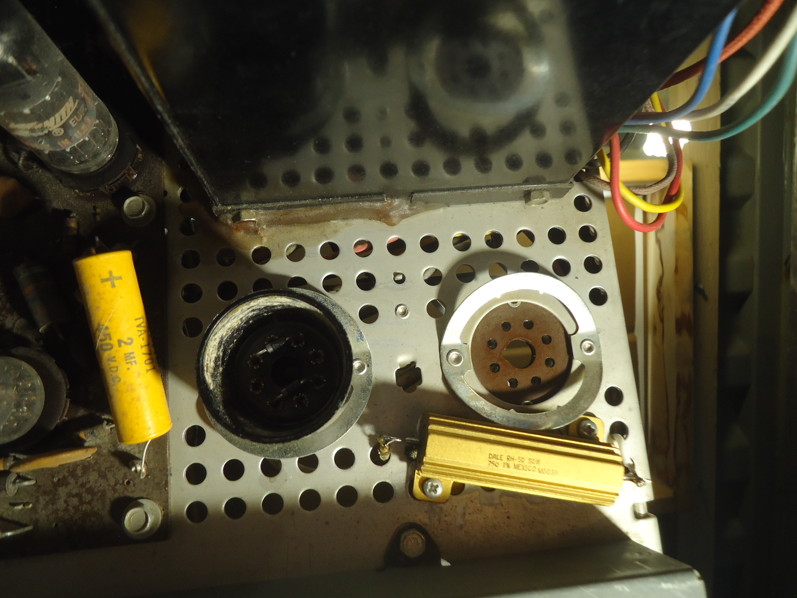

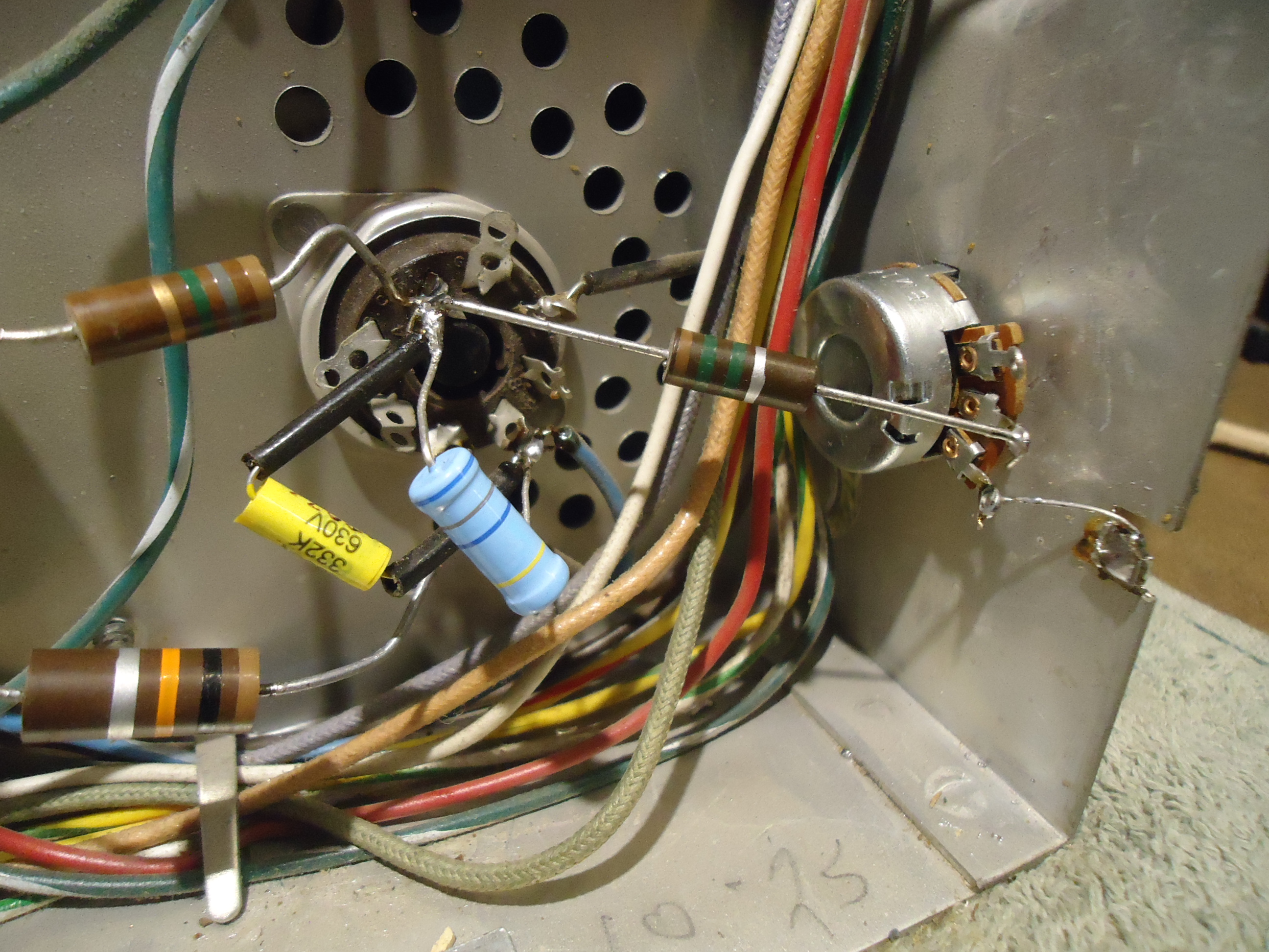

Good evening. I have made some progress over the past few days. The H.V. Regulator circuit has been modified. A H.V. control now exists and the H.V. can be varied from 16 K.V. to 23 K.V. I have also decided to eliminate the 5U4 Rectifier tubes in the power supply and replace them with a plug in solid state replacement of silicon rectifiers that are rated at 1000 PRV at 2.5 amps. These plug in replacements can be purchased, but I make my own from old dead 5U4 tubes. I break away the glass and save the sockets and install the 1N2007 rectifiers into the socket which makes it plug in directly to the where the tubes were. These rectifiers take the place of both 5U4 tubes for power handling capabilities. The improvement is power B+ stability throughout the chassis and it saves 6 amps of current not being handled by the power transformer to power the filaments of the 5U4s. Since the solid state rectifiers are more efficient, the B+ increases by around 30 volts so I installed a 70 ohm 50 watt resistor (chassis mount type for heat control), to the top of the chassis where the 5U4's were. Now, on to the Chroma circuits. First thing I noticed is a very badly charred terminal strip where a 10 watt resistor mounts. I remembered this from my own set and it is weak spot that needs to be addressed. The charred terminal strip eventually turns in to conductive carbon and if it doesn't disintegrate first, it can actually cause a small fire. This is a very delicate piece of surgery and the 10 watt resistor that caused this damage will be re-mounted to the top of the chassis where it can dissipate its heat away from the chroma circuits. Very bad design on the part of RCA in my opinion. Basically it is a 10 watt resistor in a 15 watt circuit. I have also installed a 5 amp pigtail fuse in line with the power transformer primary. That should have been done by RCA in the beginning.
Pix. 1 H.V. reg 6BK4 socket before mod.
Pix. 2 H.V. reg 6BK4 socket after mod with H.V. adjustment added
Pix. 3 H.V. adjustment set for 16KV
Pix. 4 H.V. adjustment set for 23KV
Pix 5 5U4 tubes with solid state replacement at the bottom of the pix.
Pix. 6 Chroma circuit with charred terminal strip. Hard to see from the pix.
I will send pixs in 3 separate emails. I hope it goes well.
cheers, Mike

The chroma terminal strip will be a very slow and delicate piece of surgery. Lots of wire and re-locating of parts to get the heat away from the chroma circuits.
Cheers, Mike

Yes, the H.V. regulation is good. And, I can change it from 16 KV to 23 KV if I want to for best sweep and focus.

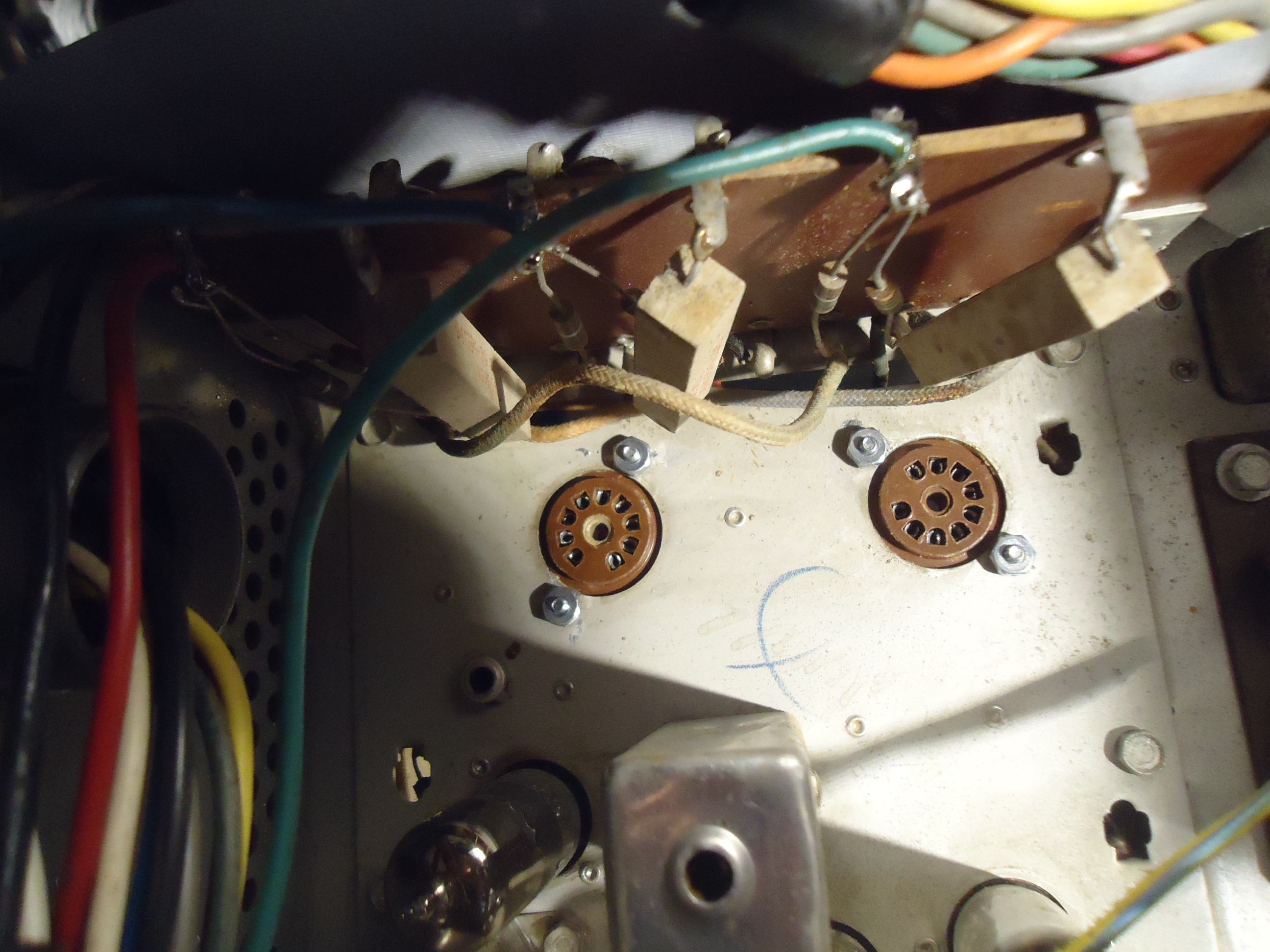

Tonight I was looking at the chroma circuits a bit and noticed that the R-Y, B-Y and G-Y tube sockets need to be replaced. They are very brittle and have intermittent tube socket connections from many years of heat from the tubes. More on that later.
Cheers, Mike

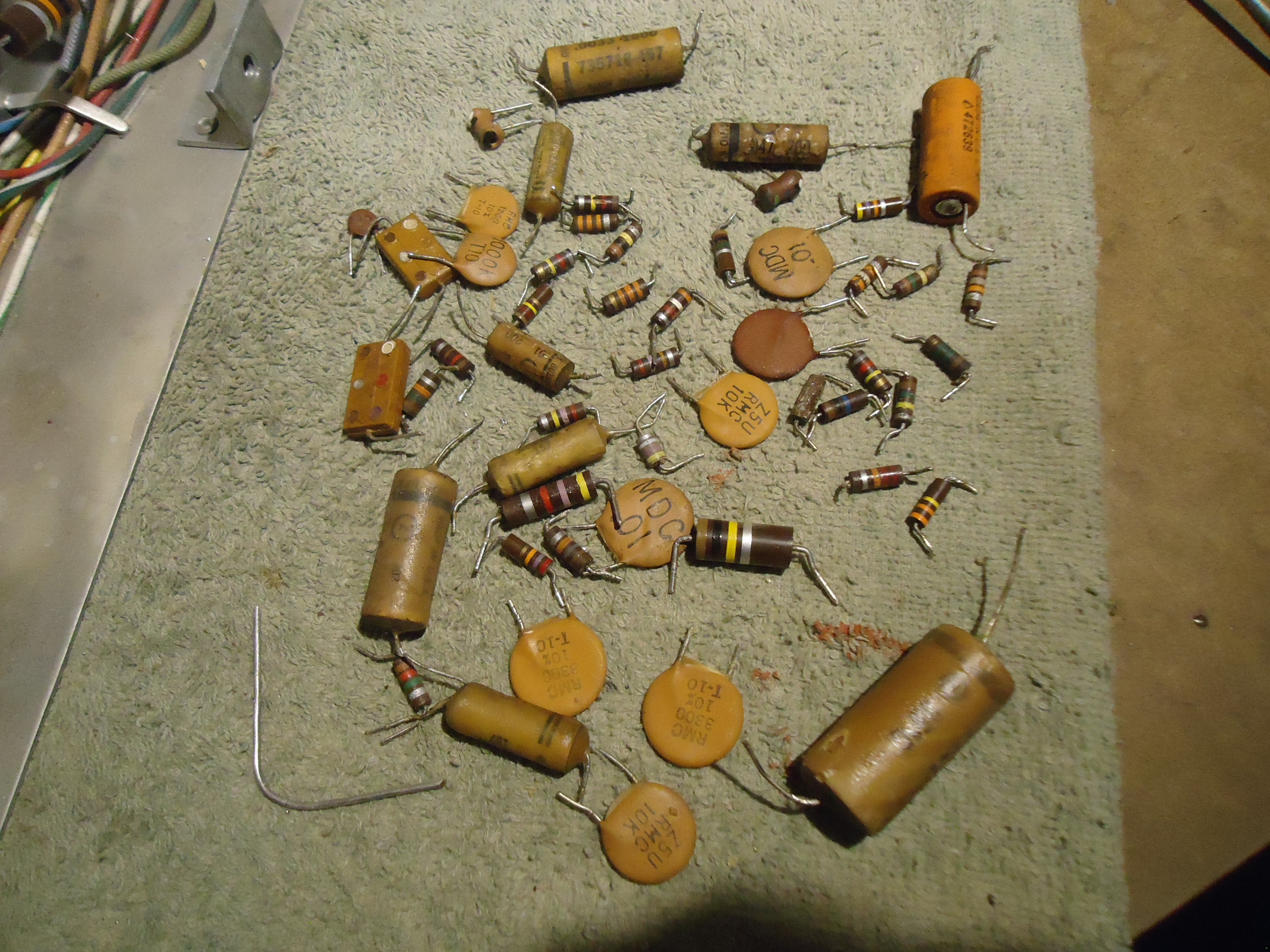

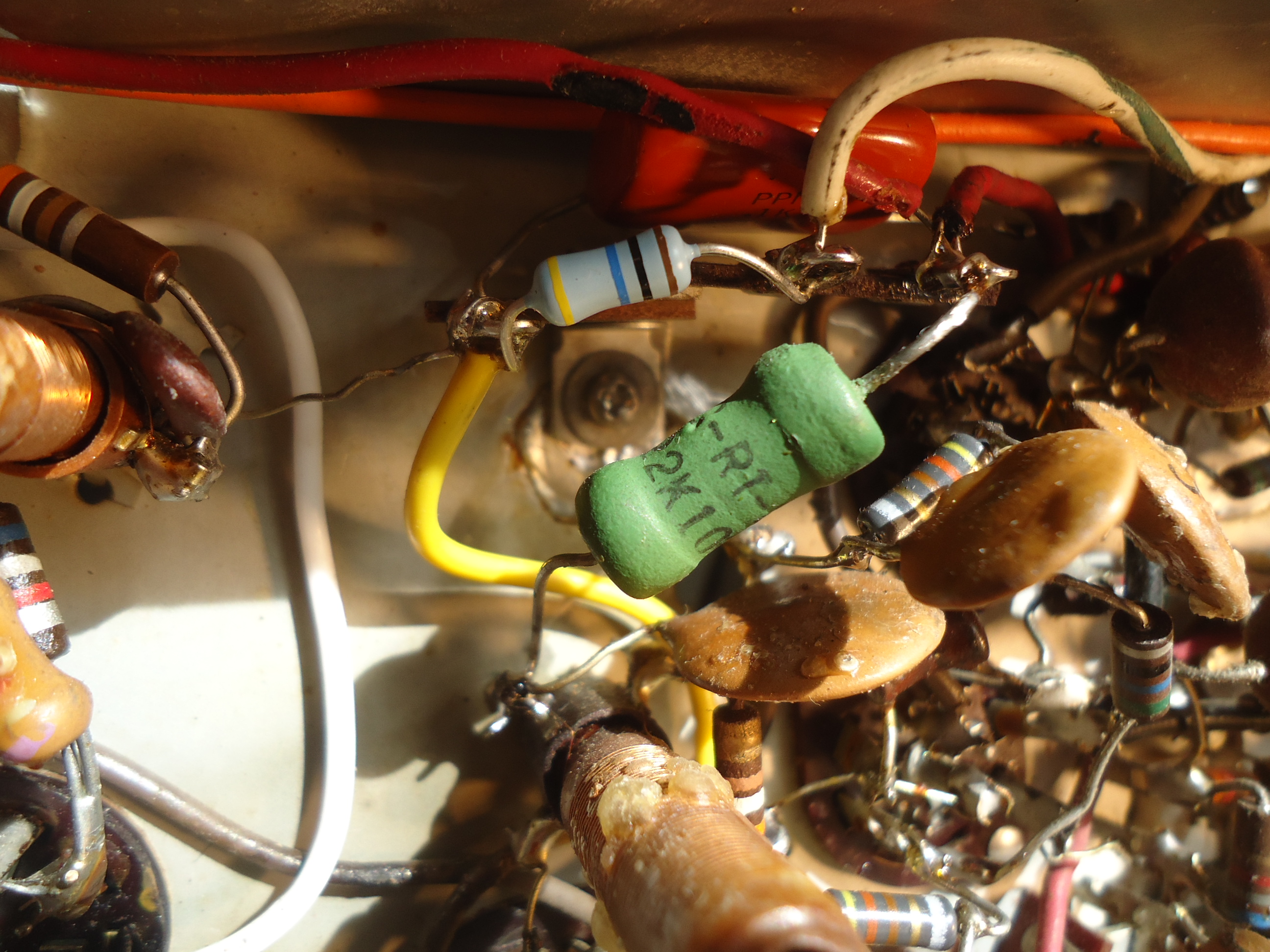

Greetings. I have done many things on the restoration since my last report. A lot of time has been spent on the restoration of the Chroma Circuits. What a mess. But first, let me recap on the last report with details. The first picture will be of the mods in the power supply. Top of chassis showing the two 5U4’s removed and replaced with 1 “plug in” using solid state 1n4007 rectifiers. Also, along side is the 70 ohm 50 watt chassis mount resistor to take care of the increased voltage that resulted in the mod. I also replaced a dual potentiometer for the red/green dynamic convergence. No picture for that. The green section was beyond cleaning. I had a good spare unit in my CTC5 Junk.
OK, now to the Chroma Circuits. There have been a number of things to address. One, problem was that the gray scale changed every time I fired up the chassis. Then it would slowly change from red, to green, to blue slowly, then any color and back again. This usually resembles a failing CRT, which is not the case here. I traced this problem to the tube sockets of the R-Y, G-Y, and B-Y / Blanker tubes. (12BH7’s). The filaments were changing in brightness. It was necessary to replace both of those tube sockets. The gray scale is now stable. Another issue with the Chroma rebuilding was a failing terminal strip. In the picture, this can be seen above center in the full view photo. Also shown close up in another photo. The terminal strip overheats due to a big 10 Kohm 10 watt resistor that never should have been installed there. I have moved it to just above the chroma circuits, and away from the sensitive tuned coils. It can be seen in the full view photo just left of center. It looks like a cement rectangle. In the later photo, it is missing because I moved it out and away from the Chroma Circuits. and you can see where I replaced a burned wire with a new white wire. I replaced a lot of resistors that were way out of tolerance, and of course all wax type capacitors.
Photo 1 5U4 tubes removed and solid state rects installed. Also, 70 ohm 50 watt resistor chassis mounted for heat dissipation.
Photo 2 Chroma strip charred
Photo 3 Chroma Circuits b4 component upgrades.
Photo 4 Chroma strip replaced
Photo 5 Relocation of the 10 K ohm 10 watt resistor
Photo 6 Replacement of the 2 tube sockets bottom view
Photo 7 Replacement of the 2 tube sockets top view
Photo 8 The Chroma Circuits finished with rebuild
Photo 9 All the components that I replaced in the Chroma Circuits.
