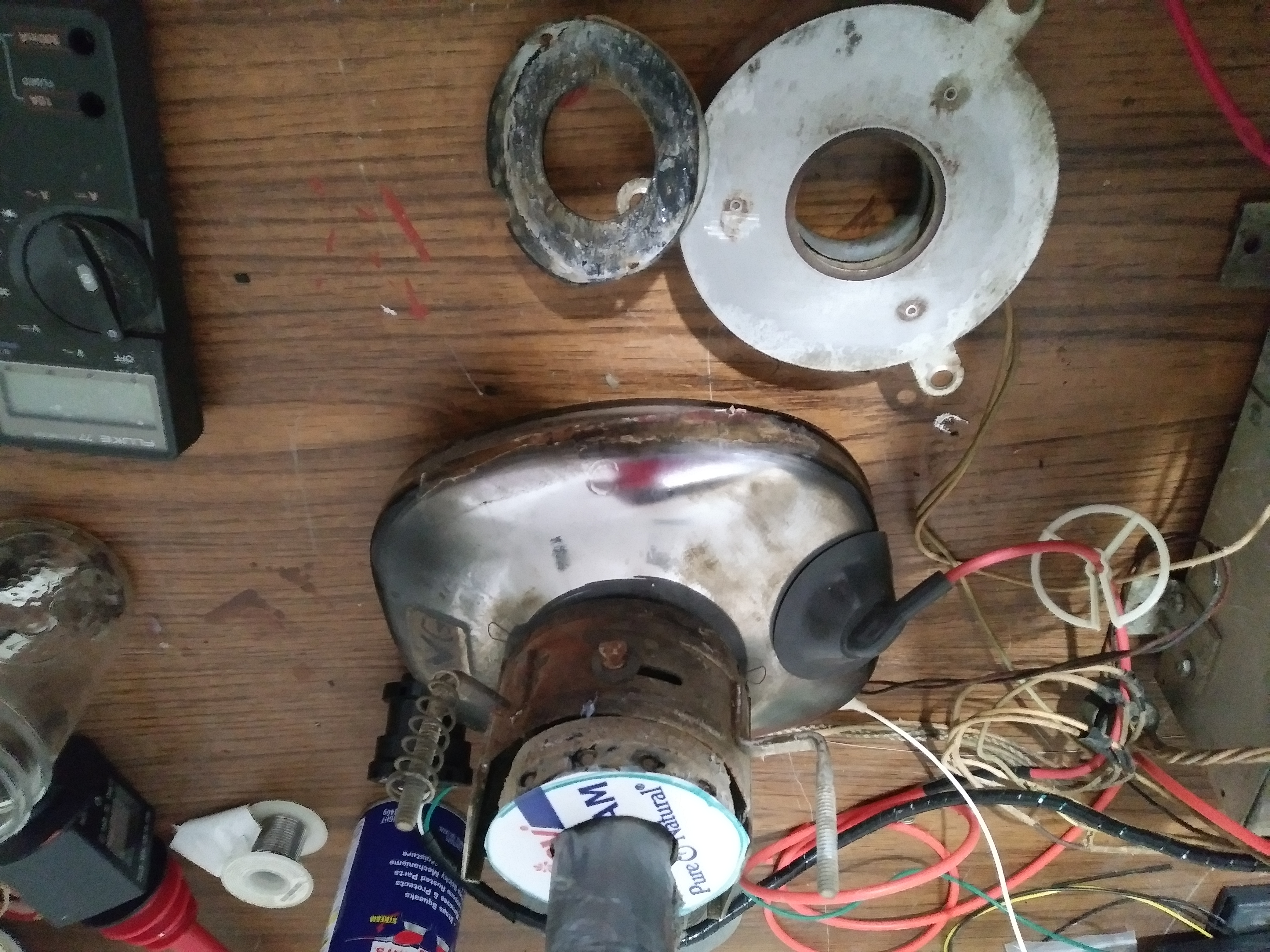

the rust cleaned off the focus coil very well with WD40, and replacement cap for the yoke seems to be a pure and natural fit!

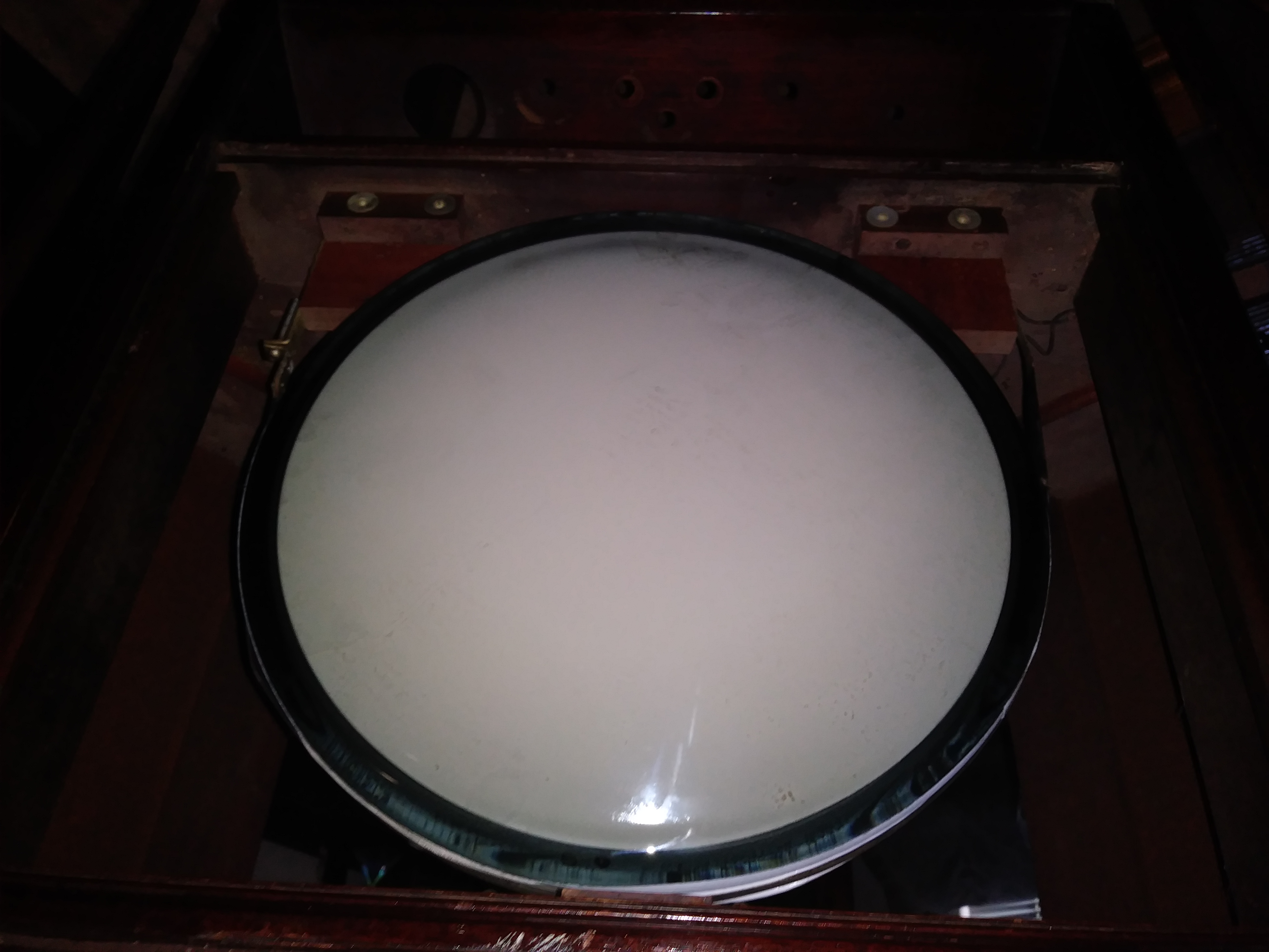

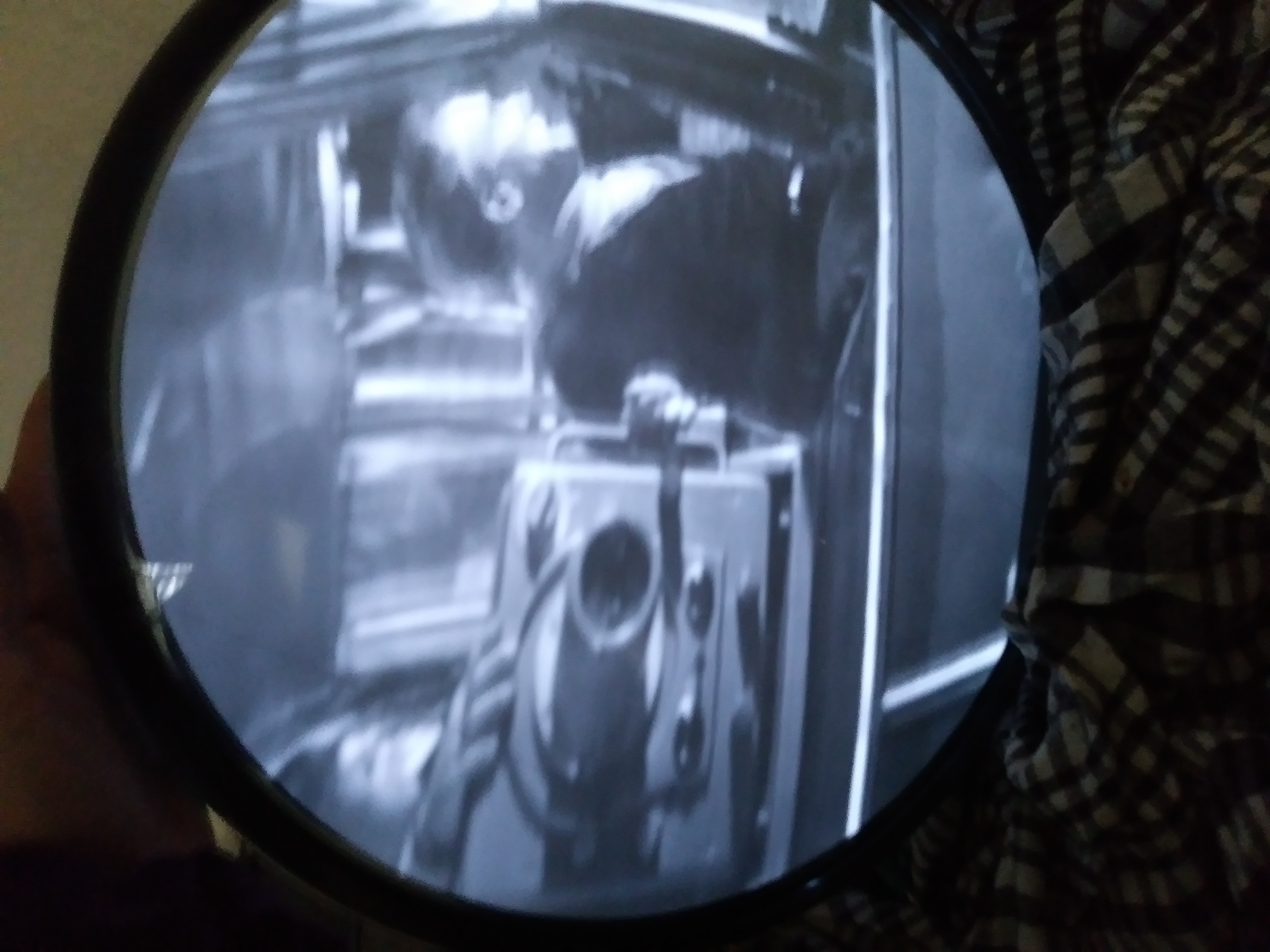

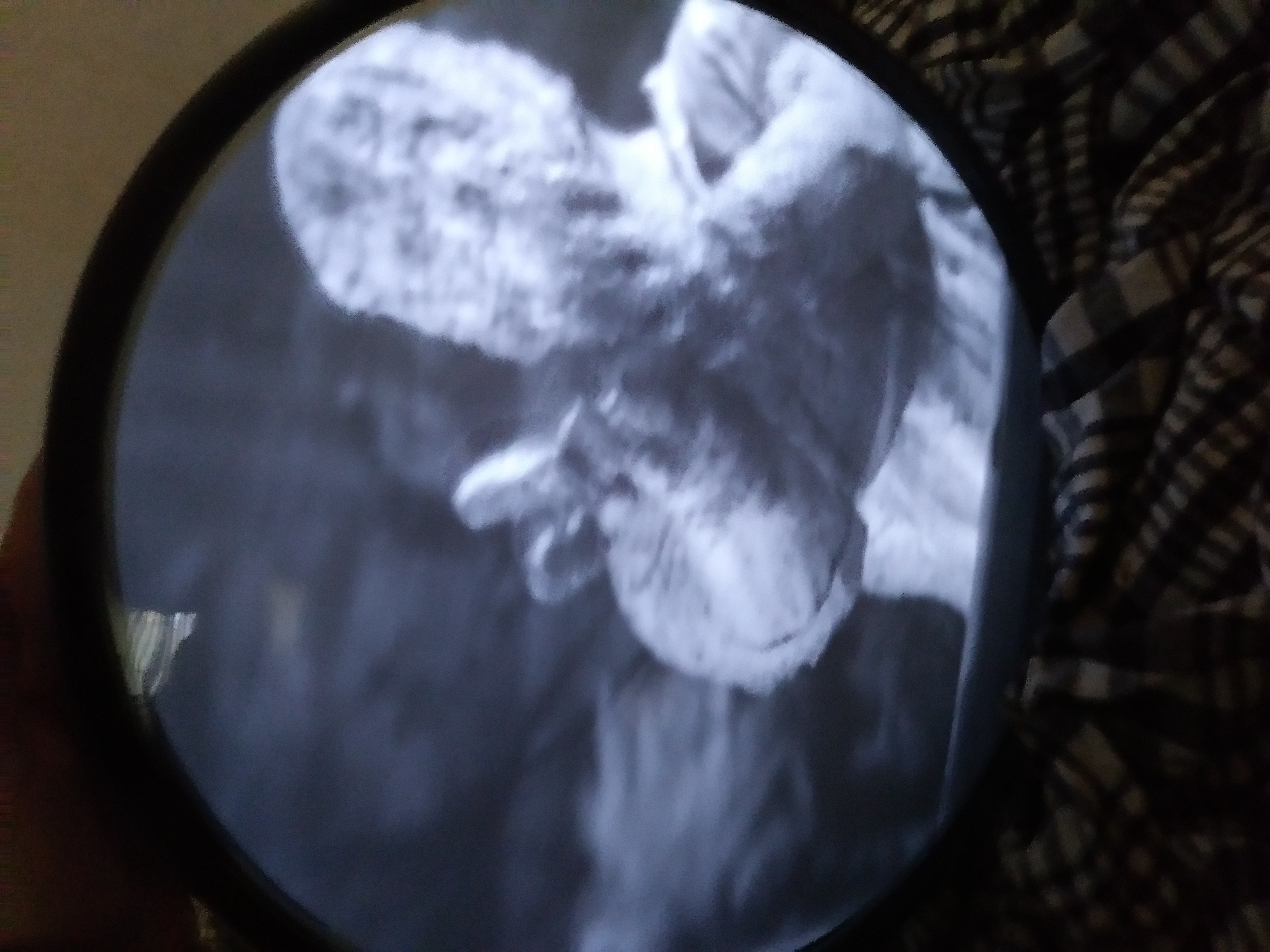

Posts: 3,165
First test of the 16LP4 was a success!
http://suzaku.live-evil.org/0708251931d.jpg
http://suzaku.live-evil.org/0708251931.jpg
http://suzaku.live-evil.org/0708251931b.jpg
The Ion trap works, brightness works, it did not with the test CRT, smearing is gone, I may have to add a resistor in parallel with the focus coil, as I don't have the full range i should, but I expected that as the lp4 has a weaker gauss than the other tubes, but this is a big step forward!

Posts: 3,165

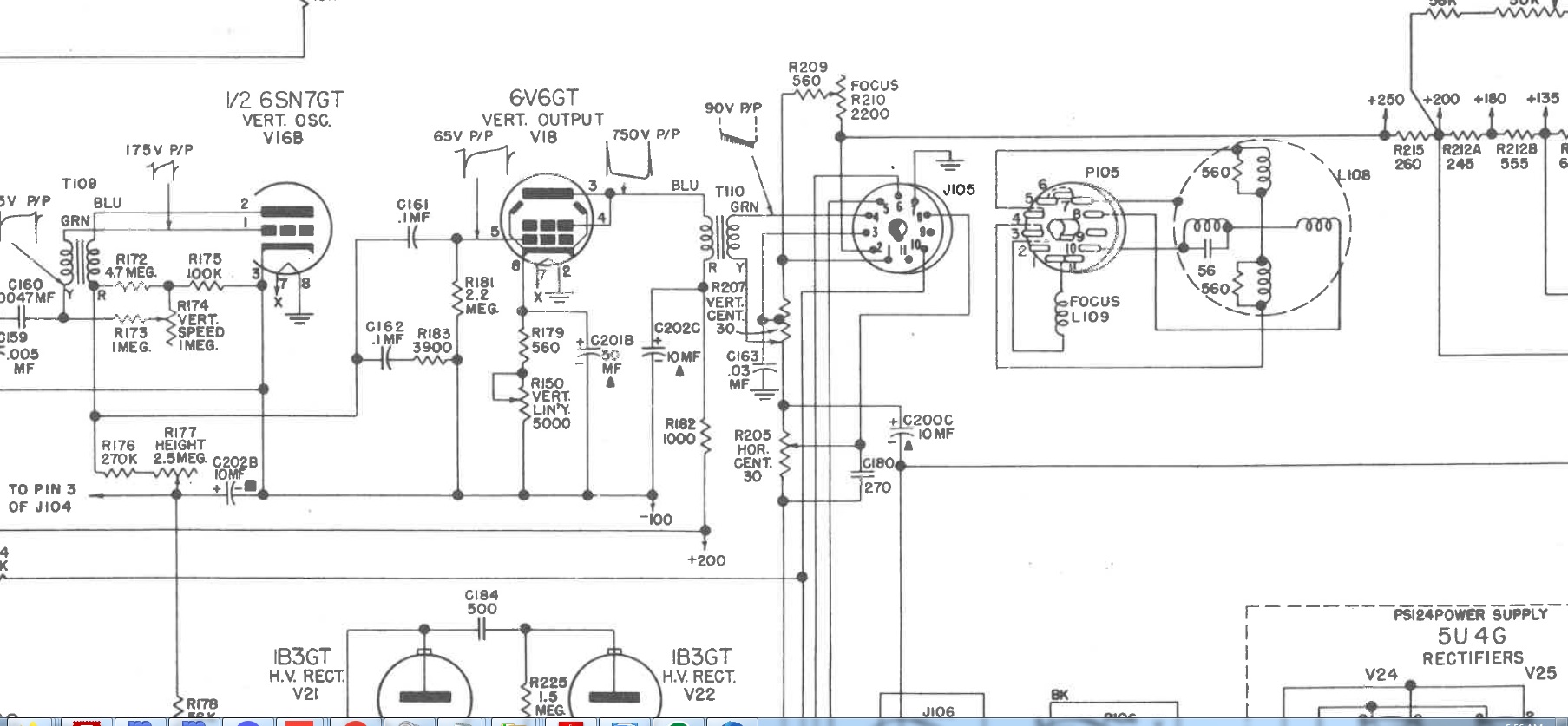

I was sort of expecting to see this with the 16LP4 as mentioned it needs a less magnetic field to focus than the 16FP4 that was in there.
16FP4 = 146 ma
16LP4 = 110 ma
http://suzaku.live-evil.org/focusa.jpg
The pics posted were taken with R209 set to minimum, but the field was still too strong, the entire sets positive bias is being shunted trough the focus coil, via the 2 centering pots (H/V), far end hooked to the main bias pi filter, which is then passed on to the bleeder network after the focus coil. (250v)
To try to get the needed range, I could change the value of R209, but that will put even more stress on R210, or what I will more likely do is put a shunt resistor across the focus coil like seen in the RCA 630TS to lower the field power a bit, 1.5k-2k or so.
  #262

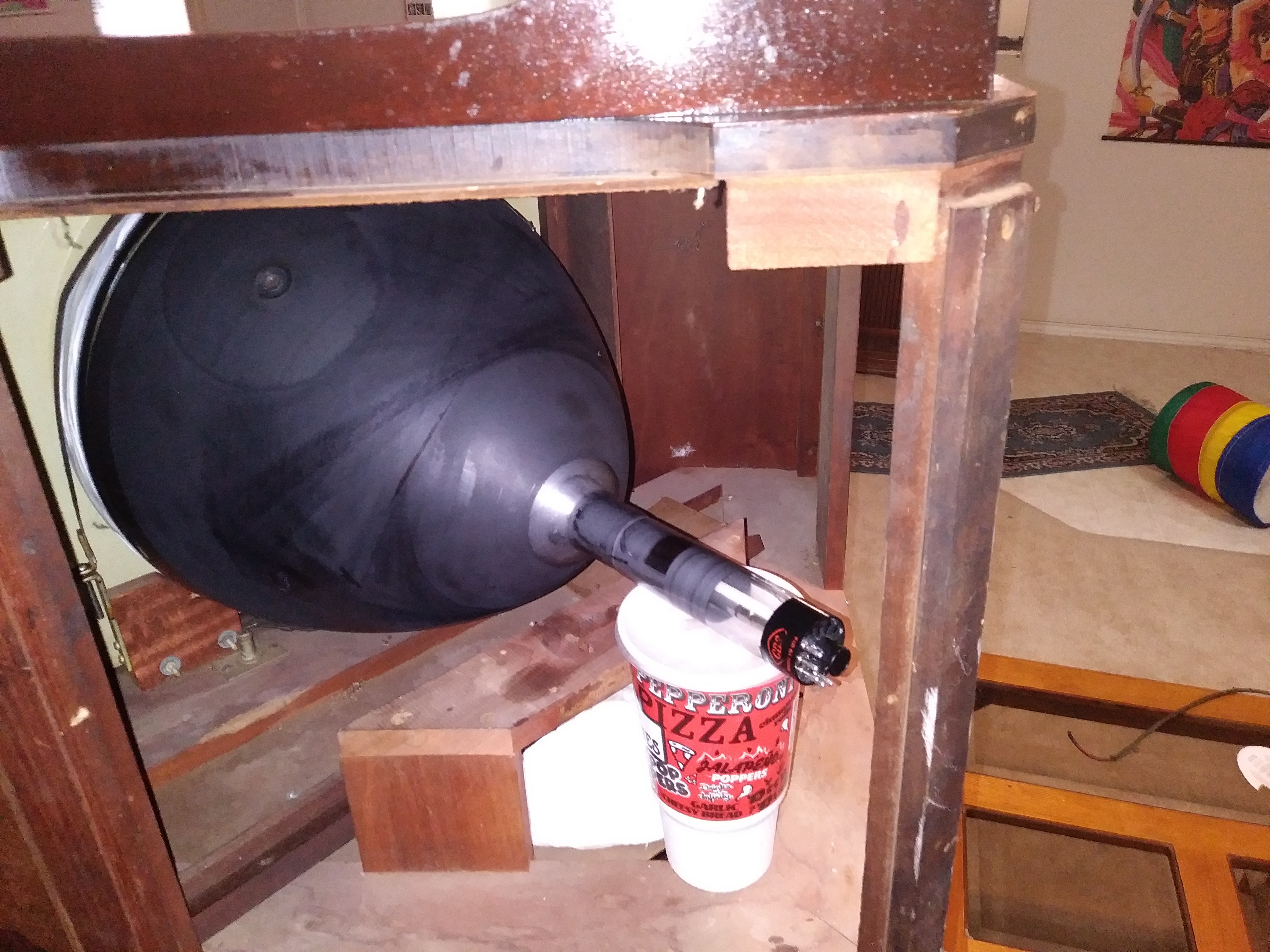

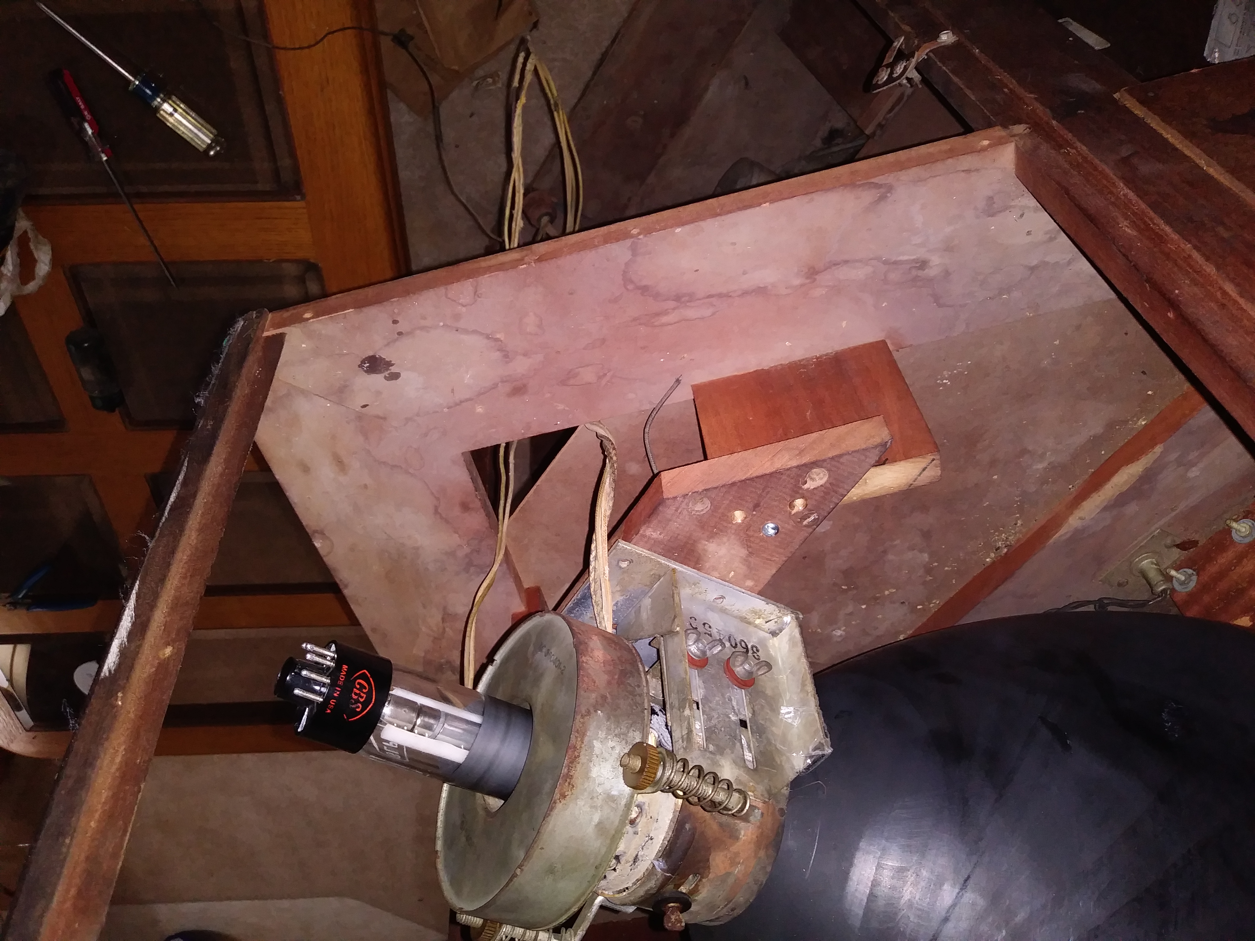

First test fit of the NOS 16LP4 in the cabinet.
http://suzaku.live-evil.org/0711252004a.jpg
http://suzaku.live-evil.org/0711252004.jpg
As I thought, I will have to shift the yoke wooden mount back a bit to get it to work, no biggie.
The front glass is not perfect, but at least it's not broken!

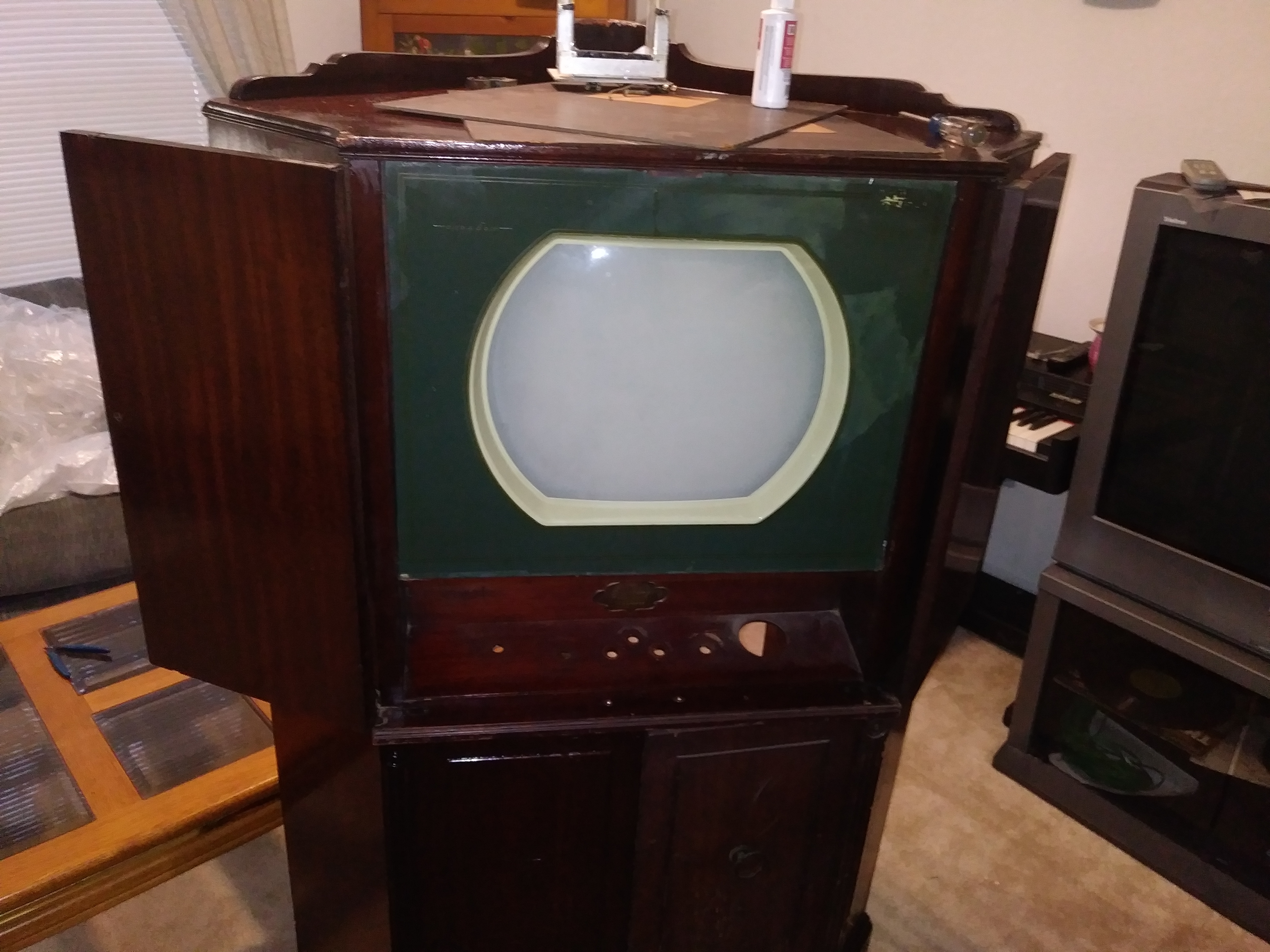

Old 07-12-2025, 02:05 PM
Posts: 3,165
It now fits!
http://suzaku.live-evil.org/0712251351a.jpg
you can see how far I had to shift it back to fit the larger size of the bell on the 16LP4.
http://suzaku.live-evil.org/0712251352a.jpg front.

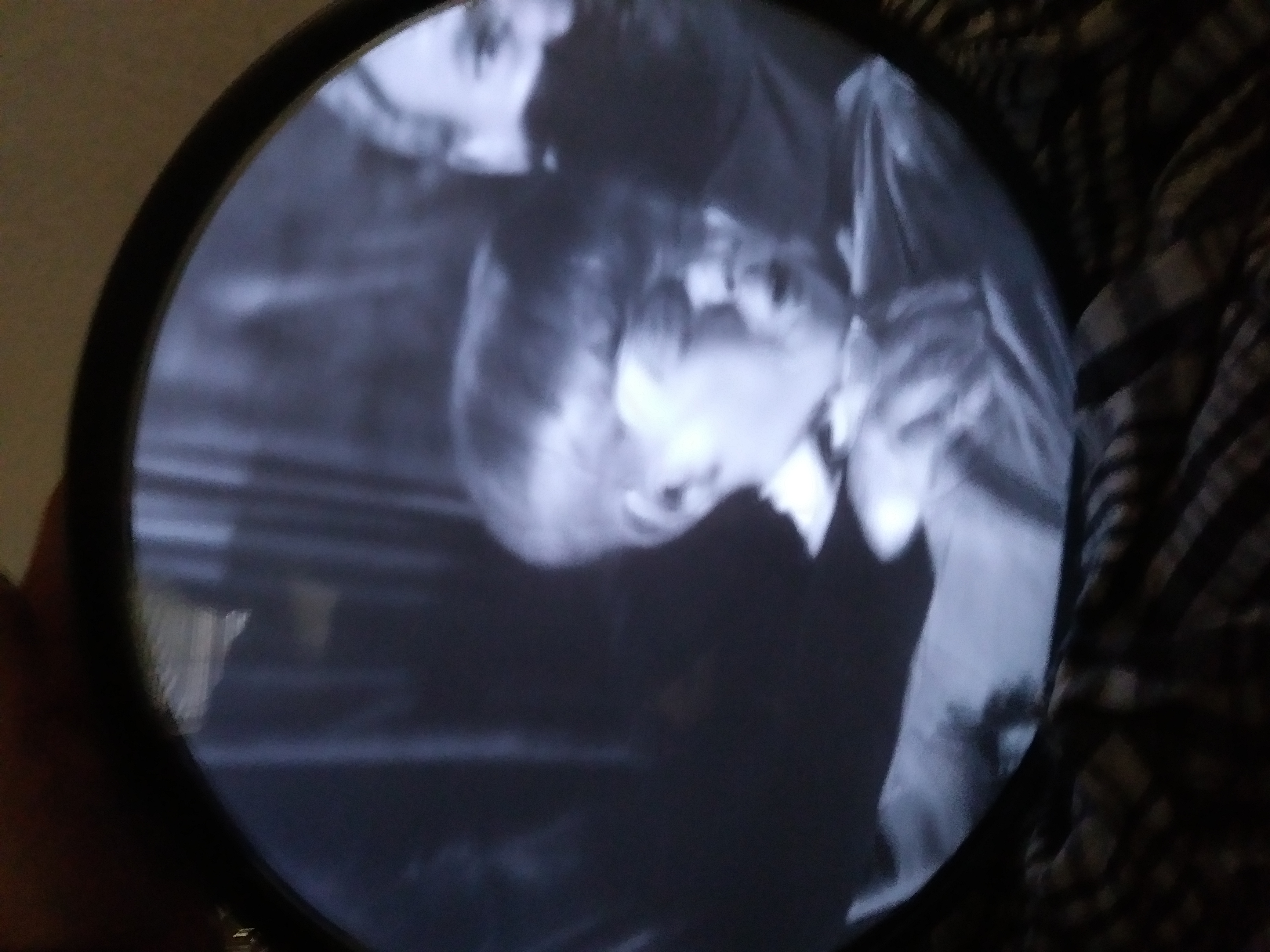

Posts: 3,165
A test of the CRT mounted in the cabinet, using the OEM speaker.
http://suzaku.live-evil.org/0715252030.mp4
Ion trap is adjusted correctly now.
I tried a 1w 1.2k resistor in parallel with the focus coil, did not last long burned up fast. will try a 2k 5-10w later.
still have to adjust screen geometry and stuff once all is said and done.

So far so good.
The flyback transformer holding up well, no a drop of wax at all, no idea why the other one fried.
pic is a bit wide, bit i may be able to adjust it down horizontal linearity is also a bit off, not tried to adjust it yet, but over all it's pretty good.
