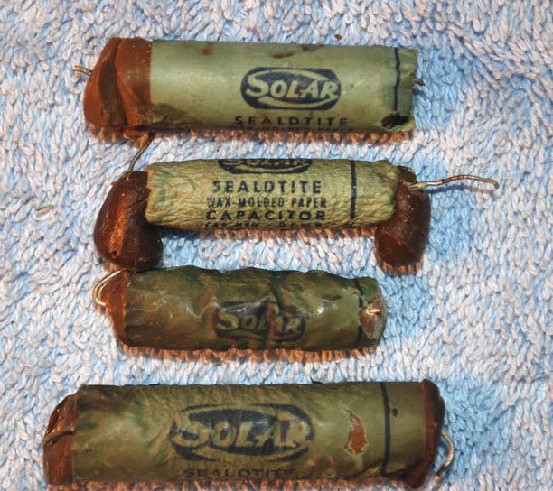

Although the service info lists most of the carbon comp resistors as 1/2 watt, they are all the size of 1 watters. Only one tested out of spec so far.
Old Yesterday, 06:23 PM
Posts: 8,774
Easiest recap ever.
Boy are these "SEALDTITE" caps garbage!
Now as for the eight twist-loc electrolytics... They are trivial to unmount as they barely twisted the tabs.
However, I was quickly reminded why I stopped attempting to restuff them.
Instead, I'll finally give CE Manufacture caps from Amplified Parts a try.
Just over for $300 for eight caps but I figure the labor savings are worth it. Plus, it will look authentic and no need to reroute wiring or install terminal strips.
I had to get creative for some to get the need values, but I think it'll be OK.
For example, I need a dual 40uF @475 which they don't carry.
So, I ordered a 4 X 20uF @475 and I'll tie some sections together.
