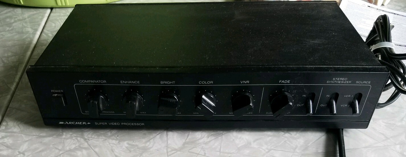

But I do have one of these...
https://i.ebayimg.com/images/g/grkAA...tC/s-l1600.jpg
I can cut the color out completely.
  #413
Old 06-24-2020, 01:22 PM
Posts: 7,712
It would be interesting to know how it adjusts the color level; specifically, does it involve a low pass filter that also attenuates high frequency detail?
