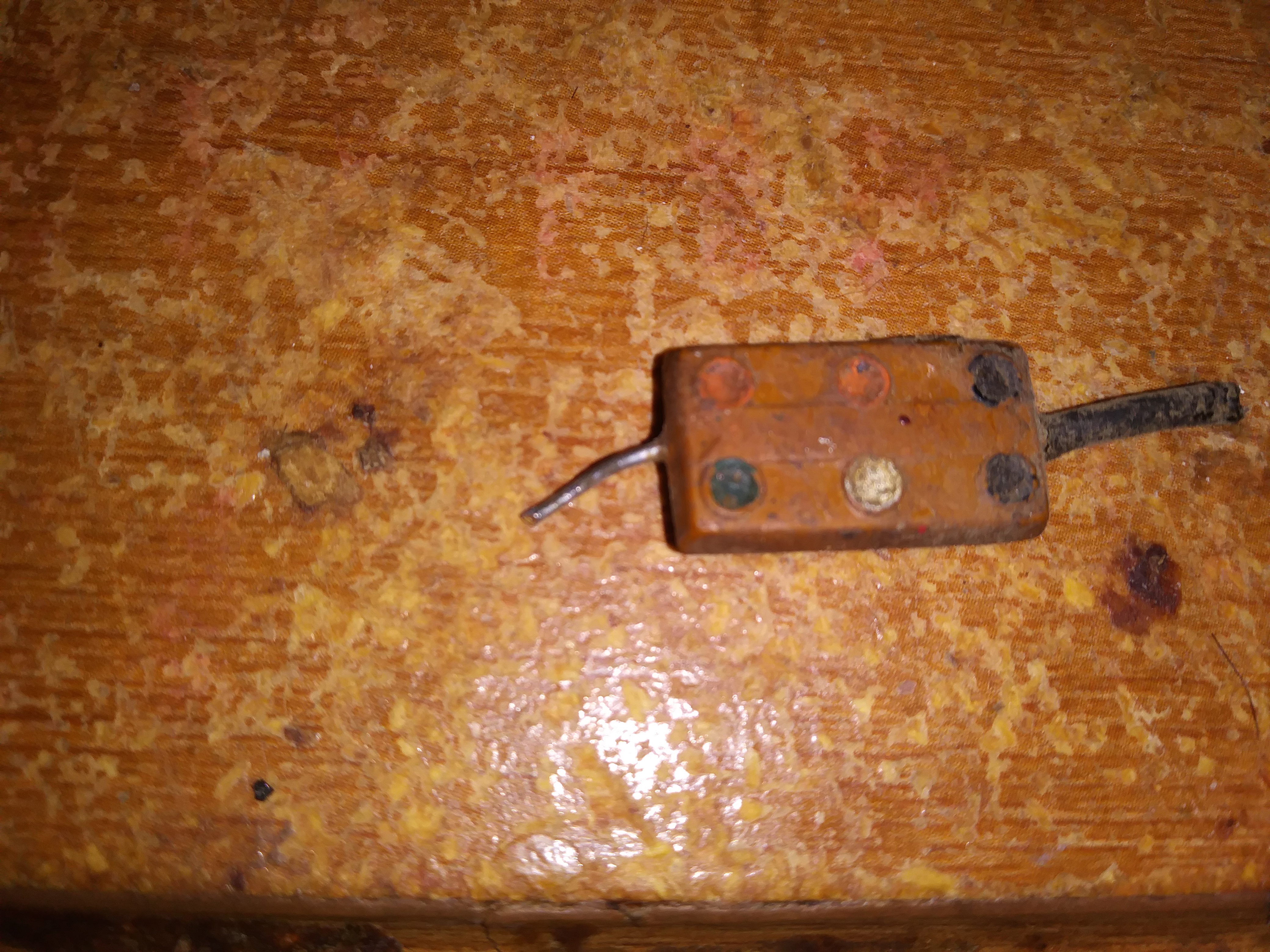

  #241
Old 06-25-2025, 10:01 PM
Posts: 3,162
Yes, 100pF rated for 500 volts.
brown - black - black = 100pF
green = 500 volts
then it's VERY bad, and the source of the weak vert lock! and most likely the wonky horz as well, found my first real bad mica! wow!

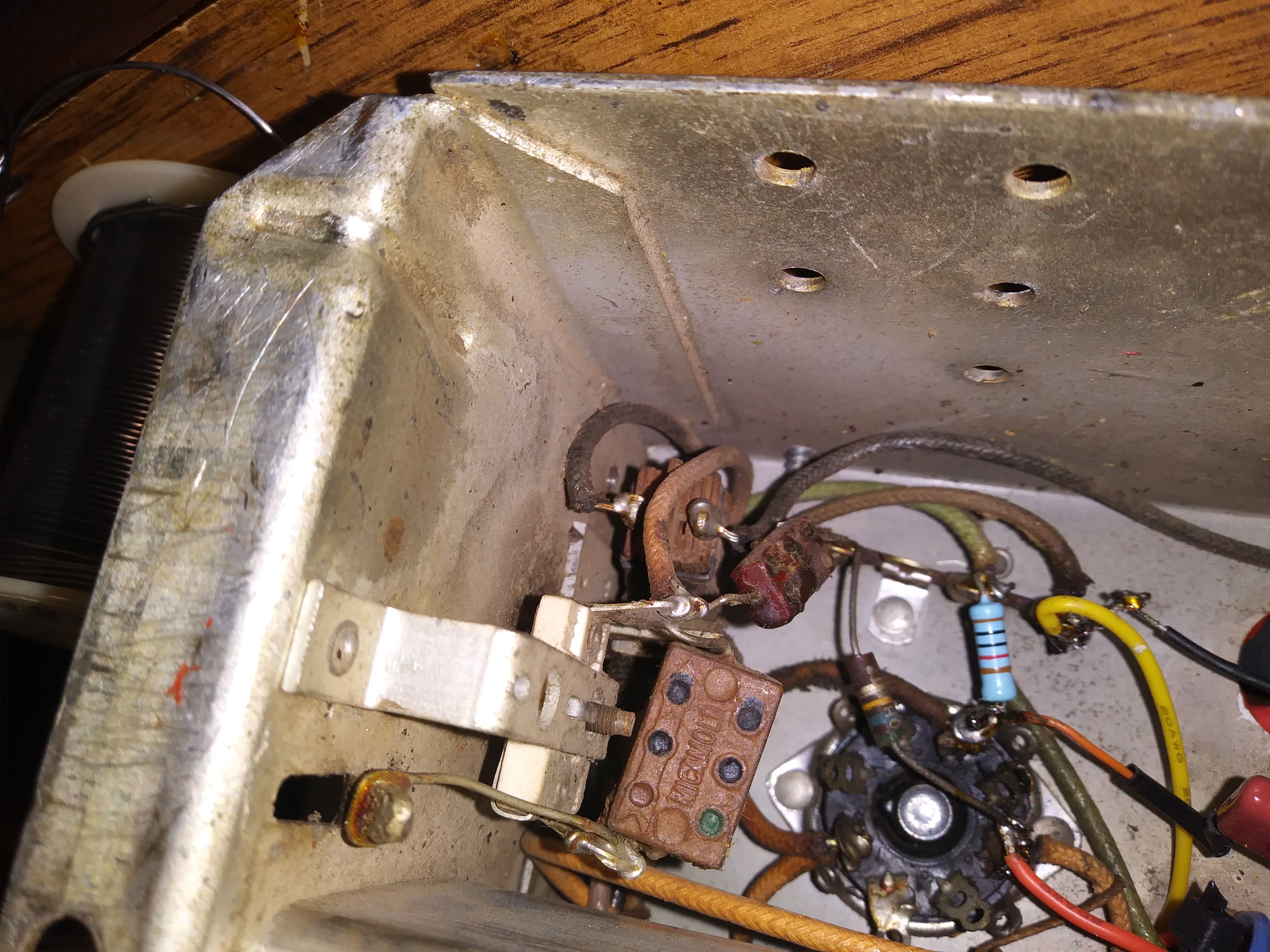

  #242
Old 06-26-2025, 11:22 AM
Posts: 3,162
So, this wonky mica is C155, the coupling cap between V15b 2nd sync amp and V17b sync clipper, with a leveler in the middle, 120v dc potential across it, with a signal of about 90V P/P being passed.
http://suzaku.live-evil.org/magie-mica.jpg
Seems that the part was so bad, that my digital M-tester could not ID what it was, too leaky i guess, but the LCR tester tested it 160pf, way over spec, I would dare say it had SMD, if these types of caps could even get that, which I don't believe they do.
Which brings me to wondering how I ever got any H or V lock with a cap in there that far off spec, and wonder if there are any others in there which are as bad as that one.
I have not put in the new one yet, but did test it in the M-tester, 98pf and the LCR tester 100pf, I guess it's better calibrated, it DID cost x2 as much!

  #244
Old 06-26-2025, 01:00 PM
Posts: 3,162
It has to have been very leaky, as the M-tester just could not ID it at all, I have only seen it do that on really bad caps.
https://www.amazon.com/HiLetgo-Multi...d_i=B01MYU0QI3
Not the best thing, but it has it's uses.
It had no problem with the old 82pf cap in the set, but after 10-12 tries, the 100pf kept coming up as unidentified / bad part, so it be too leaky for it.
The LCR meter, does not test ESR, so it does not care, if i had one of those old style cap testers like you have that could push it up to the rated 500v, I have no doubt the light would be blinking like a strobe light!

Old 06-27-2025, 08:31 AM
Posts: 3,162
Was able to confirm that the 100pf cap is indeed leaky, took it to work, hooked it to the bench power source, turned up as high as it would go, 37v, + into one end and – on the other via a 1m pull down, and the DVM saw about 25v leaking through it. Repeated this with the 330pf cap and it was 0v.
It will be interesting to see what I get when I try this on the other mica caps I remove from the set, I just wish I had a source that went a bit higher like 200-300v to really push these caps.
But to be leaking at less than 50v is pretty bad!

Old 06-27-2025, 11:43 AM
Posts: 3,162
Not sure that it is at this point, if you look at the schematic, it's C160, sitting right on the yellow wire of the vertical block oscillator transformer, leading to the vert hold pot wiper via a 1m pot.
I am looking in the area cause there was very touchy / weak v-lock / sync, but this all could have been a symptom of the bad 100pf cap in the stage before, (sync leveler) could it not?
  #252
Old 06-28-2025, 01:30 PM
Posts: 3,162
OK, after all the new parts, it still works!
vertical lock /hold is much more stable!
horizontal is still a bit touchy, having to tune in the varicap (h-lock) all the way, to get it stable, had to order yet another 100pf cap from mouser, spending more on shipping than the part, as I only had one.
sure, I could have gotten it cheaper from someplace else, but they take 3-5 days, and mouser gets it here in 1 day, no matter what!
