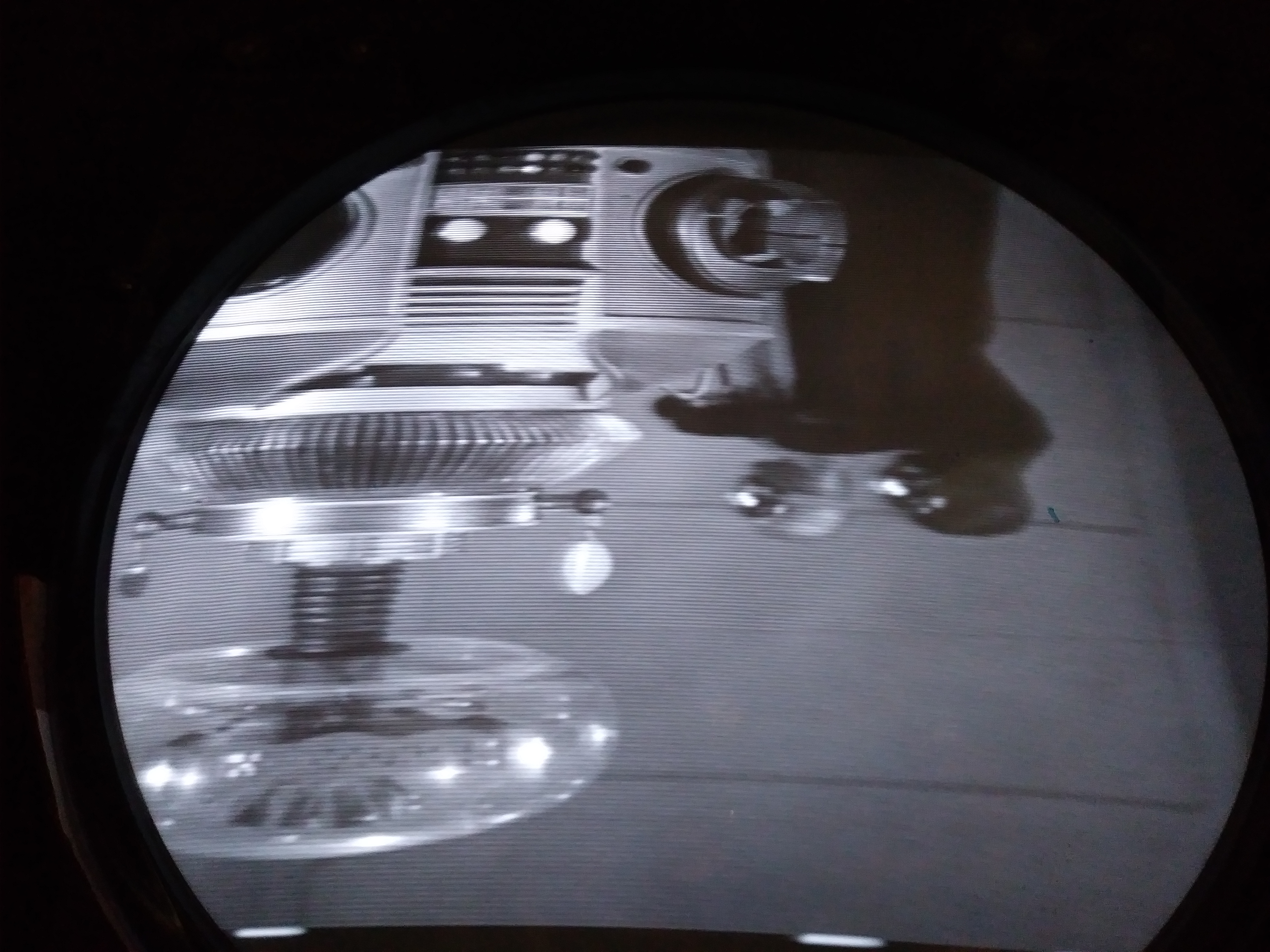

confirmed, adjusting the width and linearity got rid of the line in the middle.
http://suzaku.live-evil.org/0724251852c.jpg
http://suzaku.live-evil.org/0724251853a.jpg
Still stretched a bit on the left.
not adjusted vert yet.

That left side wouldn’t be horizontal? Well either way after adjusting everything and the line comes back then take a look at L110
  #282
Old 07-25-2025, 08:28 AM
Posts: 3,165
I was able to minimize the stretch on left side by adjusting the angle of the focus coil, I will adjust again once the front bezel is on, as it covers the far corners, I may not be able to get rid of all of it, but minimize it via L111 adjusting and focus coil tilt.

Still cant fully get rid of the stretch on the left side of the screen, was able to make it smaller but not get rid of it yet.
http://suzaku.live-evil.org/h-lin.jpg
Gonna try to replace C180 (270pf) see what that does, may do nothing, more likely the 56pf cap in the yoke, but don't wanna pull it all apart again at this point.
  #284
Old 07-29-2025, 12:27 PM
Posts: 3,697
When I had the white line on my set I do recall I had a slight stretch but after tweaking the horizontal drive just a bit to get rid of the line the stretch was gone so maybe that’s what you have going on. Try disconnecting the width coil.

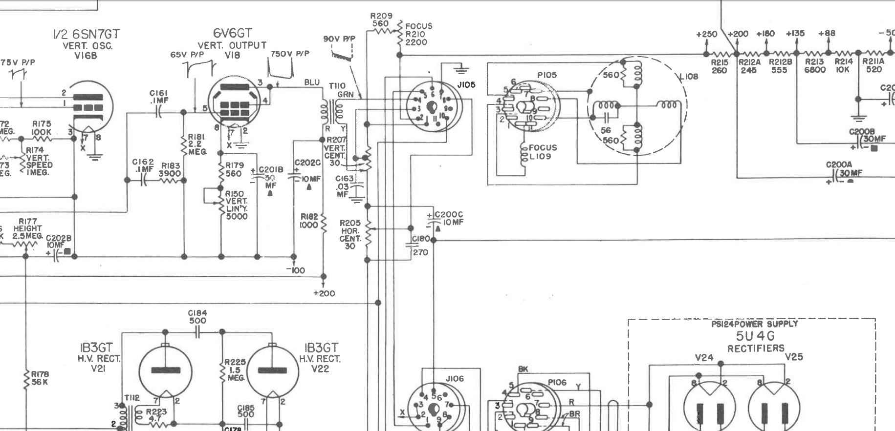

Left side of the screen is controlled by the damper circuit as recovered energy from the collapsing magnetic field fades away.
Right side is controlled by the horizontal output tube.
The cap in the yoke suppresses ringing.
Pretty sure C180 filters noise out of the DC bias horizontal centering control.
